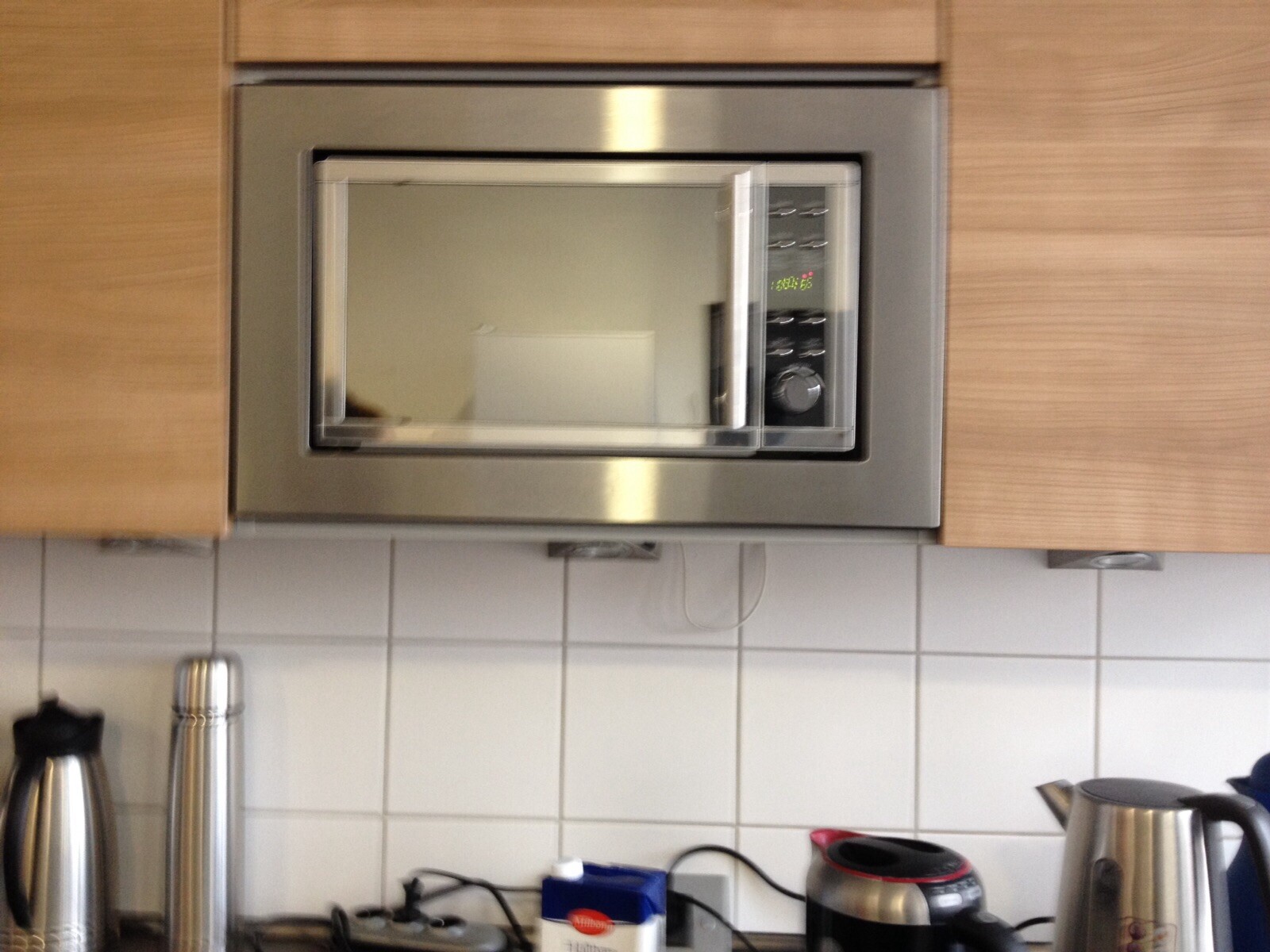

For the upcoming move, my wife wants the microwave to be installed like this.
No problem, I thought – but which cabinet is that? Is it the cabinet 94180210 with 60x57cm (24x22 inches)? Otherwise, we have the tall upper cabinets with 90cm (35 inches).

In the picture, the cabinet carcass is the same as the cabinets next to it. It is a built-in microwave that fits into the cabinet. Above it, there will be shelves and a matching door. So it would be the 92 cm (36 inches) high carcass with a 57 cm (22 inches) high door, assuming the microwave has the appropriate dimensions.
