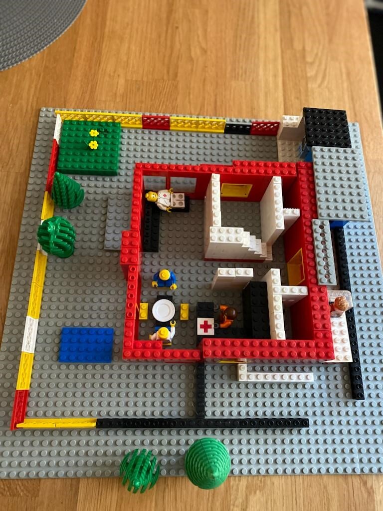

BauFamily10 Dec 2021 10:46nordanney schrieb:
To be honest, no. You can’t get it that accurately to scale. And you can’t really remove the upper floor or attic so nicely. And painting Legos is also a bad idea.
Our house back then had a 50 x 50 floor plan But there are colorful Lego bricks too... I really don’t know what you’re complaining about???:;)

There are also colored LEGO bricks... Exactly. Assuming as amateurs that all interior walls are initially considered load-bearing and that non-monolithic exterior wall constructions differ only slightly from a 36.5cm (14.4 inch) thickness—which can be represented by a classic 2x4 LEGO brick—then the 8mm (0.3 inch) LEGO grid roughly corresponds to a scale of about 1:23.43. Accepting some further imprecision by symbolically using two-stud-wide bricks as exterior walls and one-stud-wide bricks as interior walls, and treating double and single steps on the grid the same, we effectively move to a scale of 1:46.87. This is close to the common working drawing scale of 1:50. So, with LEGO bricks, two stories can be built side by side on an ordinary kitchen table. For more detailed planning of just the kitchen or bathroom, the scale can be adjusted accordingly. Overall, the LEGO brick grid is coarse enough to avoid overcomplicated ideas like centimeter-precise enclosure of wardrobes, for example. This approach makes planning an experience of imperfection for the whole family, and even young children can join in since they feel comfortable with the familiar “tool.” Planning happens within the tactile frame of reference of the whole family, allowing for somewhat larger tolerances than those in the final construction—which is as good as it gets.
