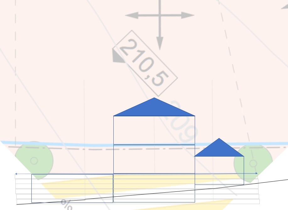

The ridge height is 210.5cm (83 inches) plus the permitted 8m (26 feet). The drawn full story does not necessarily have to be a complete floor. The roof pitch shown at an 8m (26 feet) building width is 30°. If the building becomes wider, a knee wall will be necessary anyway.
Attached is my poor attempt to visualize the slope in 2D that would lead to the garage. Here I initially assumed 3m (10 feet) per floor. For the garage, however, 2.5m (8 feet) would be sufficient to avoid a downward slope inside the garage.

Then add another 20cm (8 inches) on top. We really don’t need a railing for the garden. That would not fit the idea of an "open" design. The fewer steps the staircase has, the better. Then we would need to raise the ground by 70cm (28 inches) instead of 50cm (20 inches).

I think you don’t understand—you are legally required by the local building authority (Labo) to install fall protection starting from 80 cm (31 inches) height! If you don’t do this and someone falls, no insurance in the world will cover the damages.
And filling up 70 cm (28 inches) just like that… what’s your budget again? Also, keep in mind your general contractor, earthworks contractor, etc., are not obligated to refill the excavation. If they don’t want to, they won’t do it.
Don’t assume all of this is simple within your limited budget and given the conditions. Because it’s not.

Okay, I guess I first need to memorize the state building code and building regulations. Apparently, these requirements didn’t exist in Hesse 18 years ago. At my sister’s place, you can still fall 1.50 meters (5 feet) deep into the abyss...
How high should my budget be to make this happen? What does an additional centimeter (0.4 inch) of fill cost me? I’m not asking here for no reason. These implementations are more important to me than a top-of-the-line tile floor or a rimless toilet.
In the best case, for example, the financing might suddenly provide an extra $20,000 to $50,000 (or equivalent) in budget.

Okay, I guess I first need to learn the regional building codes and construction laws by heart. Apparently, these regulations didn’t exist in Hesse 18 years ago. At my sister’s place, you can still fall into a 1.50 meter (5 feet) deep abyss...
What budget should I set to make this happen? How much does it cost per centimeter of fill? I’m not asking without reason here. For me, these groundworks are more important than a state-of-the-art tile floor or a rimless toilet.
Ideally, the financing could increase the budget by 20,000–50,000 euros (or equivalent).
I assume she either didn’t know any better or didn’t care. An architect or any contractor involved in this kind of work must point this out. So far, everyone I worked with has done that.
For earthworks with an excavator, I was quoted €105 (about $115) per hour in 2017. That’s just for shaping the terrain. So, you’re easily looking at €3,000–4,000 ($3,300–4,400) there. Or put another way, what you see out there including the carport, welded wire fence, some small trees, terrace, and paths will end up costing around €75,000 ($82,500). The current progress you see in the photos is about €30,000–35,000 ($33,000–38,500).
