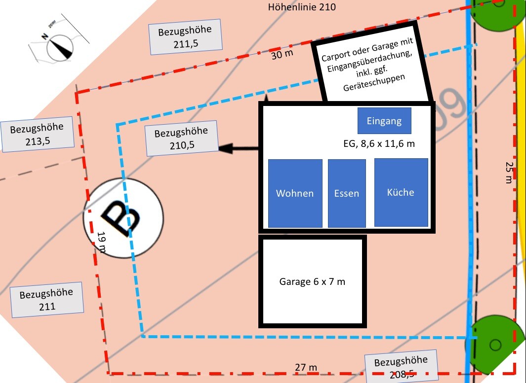

somehow I’m stuck in a planning chaos and hope to get a few tips from you regarding the planning approach and/or ideas for implementation…
In particular, a cost estimate would probably help me with regard to the basement design. Or how many square meters of house we can afford. Can we save money if, instead of a living basement, we plan the garage in the basement and enlarge the house footprint to accommodate a guest room/office and utility room?
What is the most cost-effective way to achieve my desired level access to the large terrace and garden from the ground floor (living/dining/kitchen)? There should be enough space to at least partially accommodate an embankment with a slope.
Any ideas for the placement of the garage? I especially can’t quite visualize the slope.
We still have a total budget of 500,000 € (land already owned). It has to be somehow feasible with this budget to build a family house (not just standard equipped) with more than 130 sqm plus basement, garage and outdoor area in Baden-Württemberg, right?

Timber frame or masonry. I’m leaning toward timber frame.
Where is the road located?
I would plan it similarly to us.
Southeast garage and courtyard
Next to it, the basement with
Living, dining, and terrace in the west
Entrance on the south side
Bathroom facing south
Kitchen in the southwest
Building services occupy the windowless room between the garage, slope, and stairs
Upstairs: bedrooms, bathroom, utility room with access to the north
Gable roof
A rooftop terrace is really like living on a showpiece.
We moved in in 2018; building on a slope, the budget of 500,000 is extremely tight.
You have to save every dig of the excavator and every square meter.
Exterior work in EL (electrical installation) sounds simple. Retaining walls, earthworks—without machinery like excavators or concrete pumps, it quickly becomes slave labor.
The costs mentioned above are not enough for the earthworks and garage.

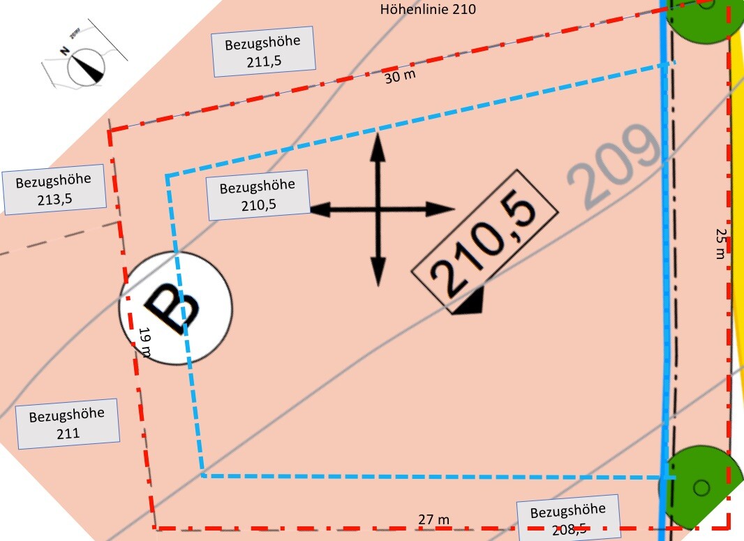

11ant schrieb:If we assume the actual ground level, I completely agree with you. Our own research didn’t get us any further with the reference height, and the general contractors didn’t clarify it either. That brings me back to my original idea of placing the garages on the north side along the property boundary and connecting them to the main building with a covered entrance or carport. This would probably mean a longer driveway.
The house is generally at elevation 209, the garage at 208.5, which is not suitable for using the roof terrace or setting it back below the south-facing windows – so I see the design as needing revision.
11ant schrieb:As mentioned, we have assumed our ground floor at 210.5 and that earthworks would be necessary to shape the garden, with necessary retaining works. Only then did the garage with roof terrace come about.
Raising the house closer to the reference height reduces knee wall options and would raise the basement level too much; however, for a whole floor garage below the main floor, this would be necessary. 1. I don’t see the layout as feasible like in the sketch, and 2. I find the ground floor level around 209 to 209.5 to be most practical.
11ant schrieb:What exactly is a "fox-level"? Google doesn’t seem to know that either. 🙂
3. Overall, I see a required "fox-level" from the architect – a skillset rarely found in general contractor draftspeople.
11ant schrieb:I’m not willing to compromise much here. Such a low knee wall is only acceptable to me if the footprint is huge – then the kids’ room should easily be 20sqm (215 sq ft), the bathroom 15sqm (160 sq ft) or more. I also tend to imagine knee wall windows rather than roof windows, which do require a certain knee wall height. Unless someone can convince me of unbreakable roof window shutters that are usable even in difficult weather (like frost).
Regarding your wish for a knee wall height >150, I’d point out that a knee wall is always a dividing line: either below the eaves are only facade windows and above only roof windows, or you have to use dormers. Angled windows on both surfaces never really became popular for good reasons. I therefore advise against such large knee walls and see a practical height closer to a finished dimension of 120 (between 100 and 125). A good knee wall fully replaces a dwarf wall but not beyond that.

haydee schrieb:The garage would initially be only for the oldtimers, so it doesn’t have to be directly on the main driveway or double-access with the yard. With 9m (30 ft) length, the oldtimers could be parked in a row. This means we will have to reconsider this now.
I would plan it similar to us.
Garage and courtyard to the southeast
Next to it the basement with
Living, dining, terrace to the west
Entrance to the south
Bathroom south
Kitchen southwest
House services in the windowless room between garage, slope, staircase
Upstairs bedrooms, bathroom, utility room with access to the north
Gable roof
