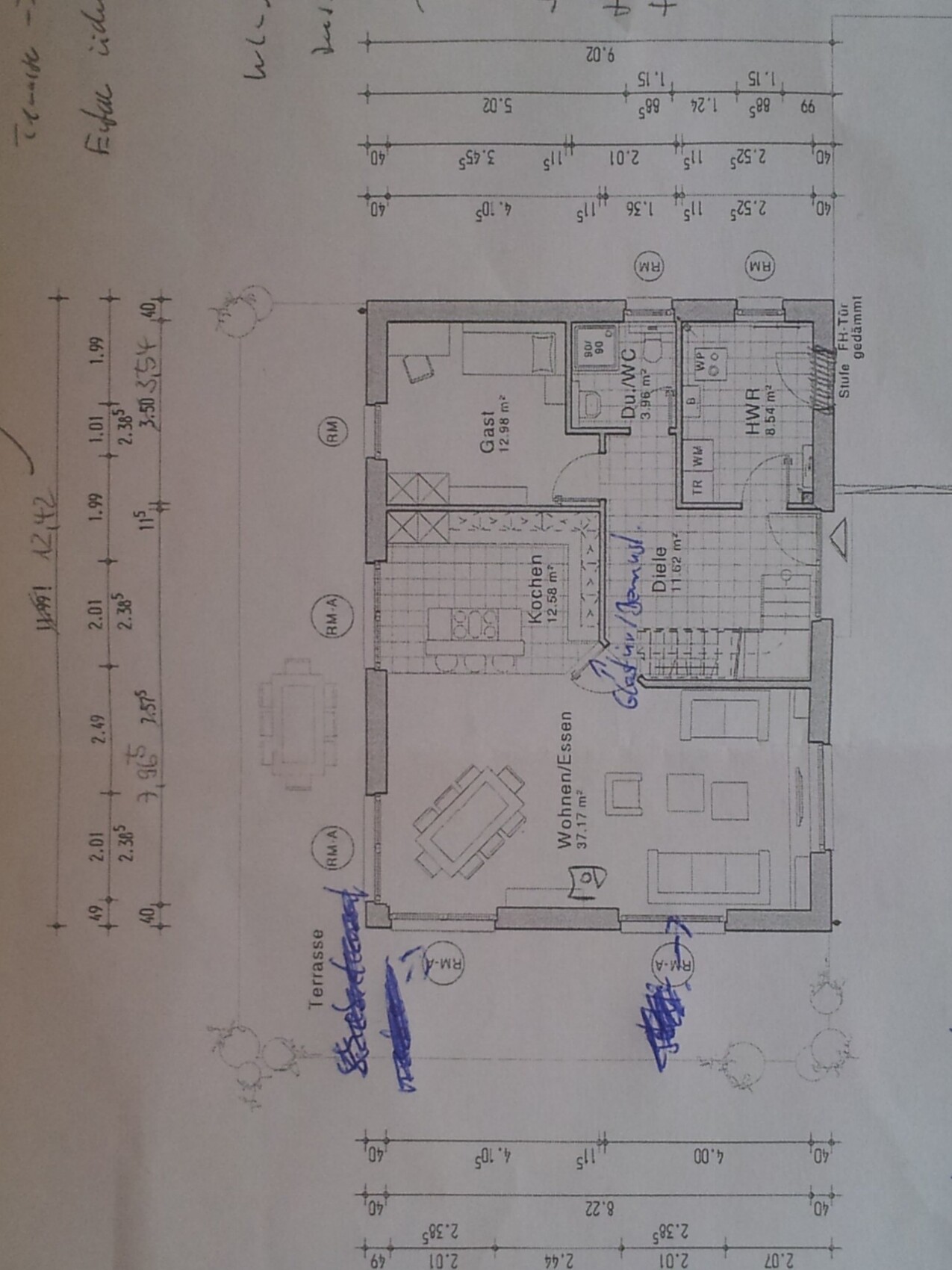

Hello, what do you think of the floor plan and what could be improved or changed? Looking forward to your suggestions. Thanks
It could be adjusted for better quality, for example brighter, larger, or sharper 🙂
milkie
1 Aug 2014 20:15
Yes, the details are hard to see. However, my immediate impression is that the staircase is not well designed.
1. The access to the main rooms is located under the last steps, and
2. to go upstairs, you always have to pass directly through the dirt that inevitably accumulates just inside the front door.
Since a floor plan with the staircase included can make or break the layout, it is unfortunately advisable to start over.

2D house floor plan with living room, kitchen, terrace, hallway, and bathroom.
E
Exilhamburger
1 Aug 2014 21:23
more readable?
1 Aug 2014 23:26
Better 🙂
But where is the upper floor and the site plan?
Why is the kitchen located where it is and the living room where it is?
What kind of house will this be? Where is north?
A floor plan depends on everything; you should know that by now, you’ve been here for 3 years.

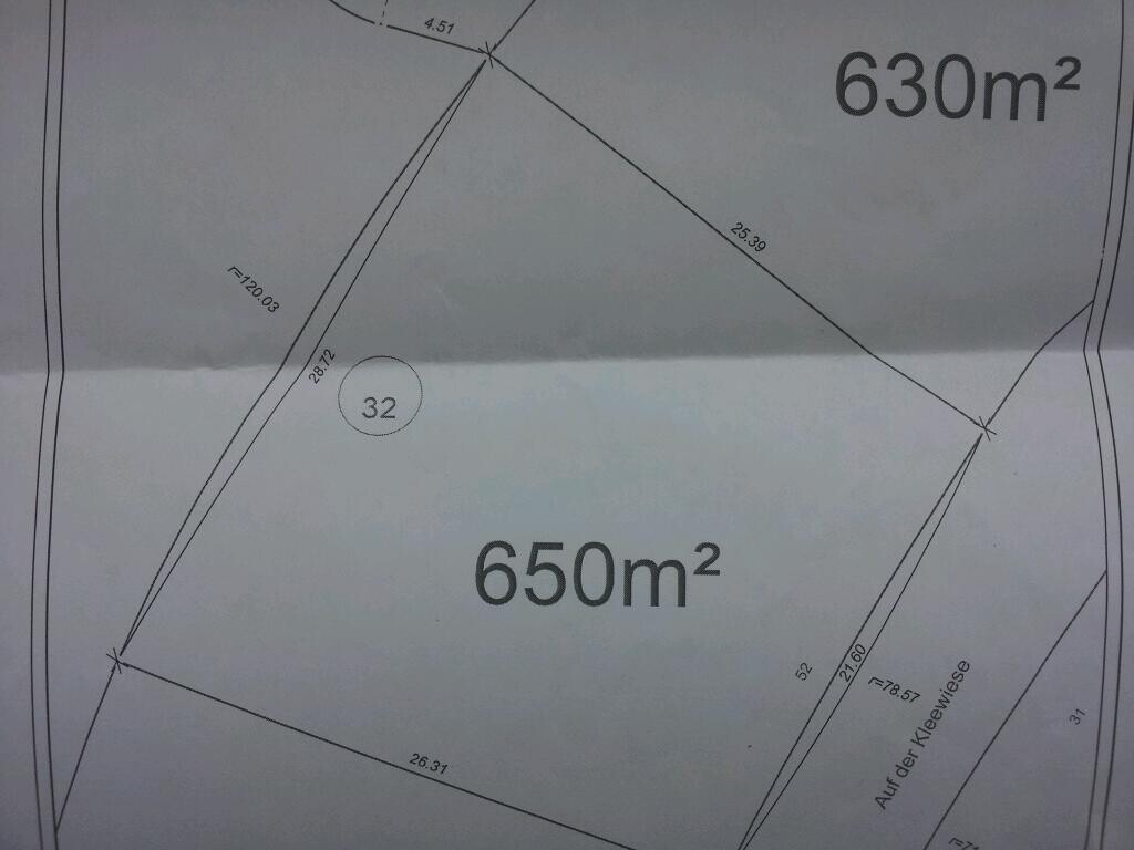

Here is the floor plan of the upper floor, plot number 32, and the house.
2D floor plan of a house with Child 1, Child 2, Parents, Dressing Room, Bathroom, and Hobby Room.
Plot plan with area details 650m² (7000 sq ft) and 630m² (6781 sq ft), parcel drawing
