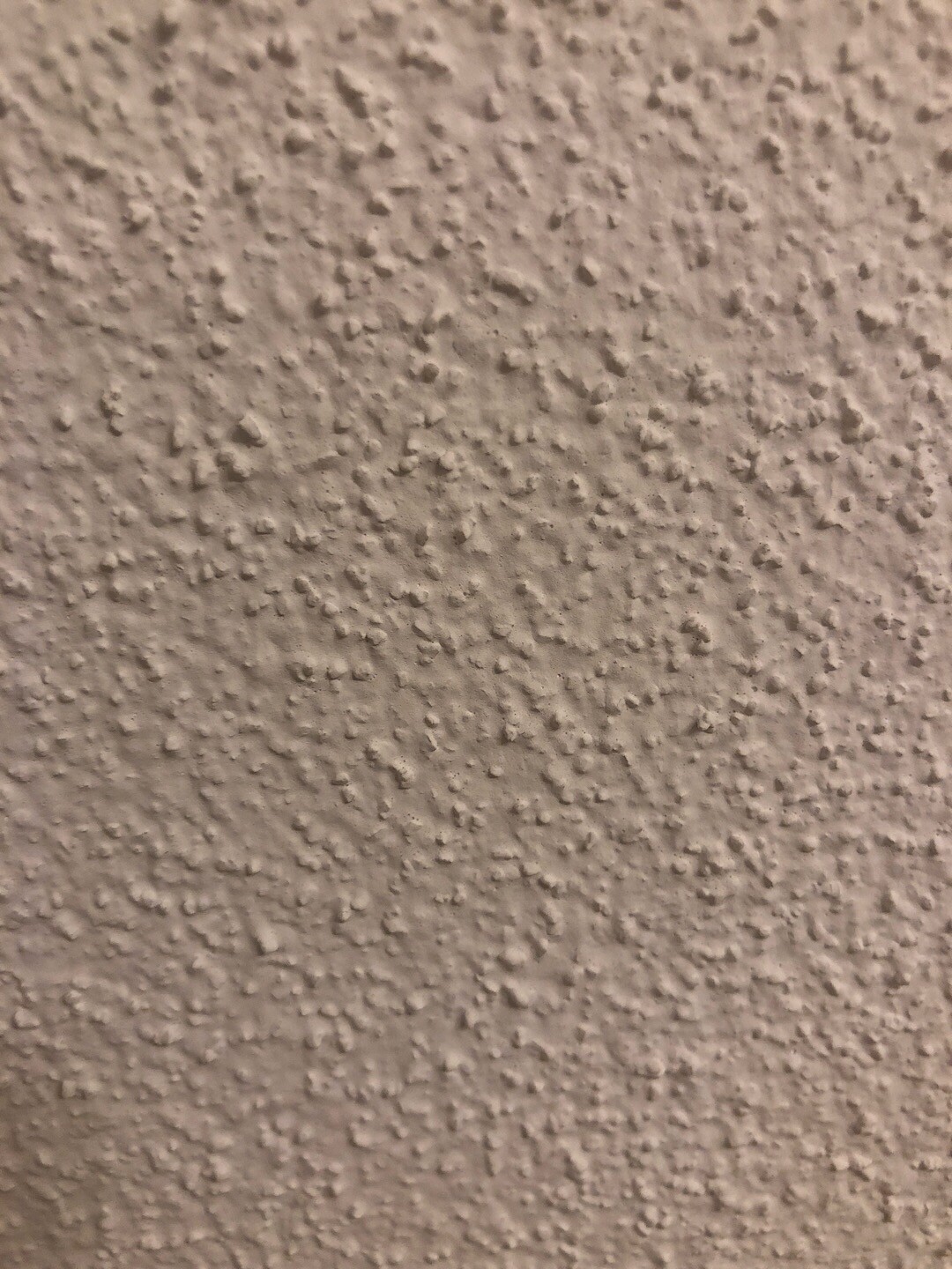

In our current rental apartment, the bathroom has a lime-cement plaster. Attached is a photo. Our construction coordinator showed us this plaster in one of his apartments for living areas as well. There, the texture was not as coarse, and we liked it. Therefore, we will probably choose lime-cement plaster for the entire house. If the kitchen is not considered a wet room in terms of humidity levels, then I don’t know what is. Boiling potatoes for 30 minutes produces as much humidity as a 10-minute shower.
