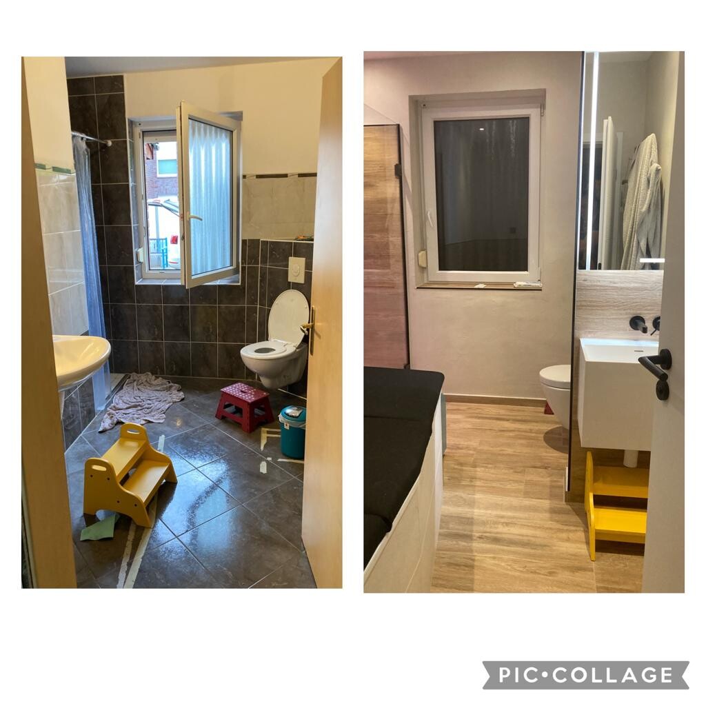

ArniBanarni19 Feb 2023 13:43Hello everyone,
Because we were unsure about how to design the bathroom, the project kept getting postponed. However, Iâd like to share with you how we finally completed it last autumn. Thanks to everyone for all the input! Itâs always very valuable!
I hope itâs obvious which photo shows the new bathroom and which one is the old one :-D
hanghaus202319 Feb 2023 14:11You canât recognize any of the floor plans there.
