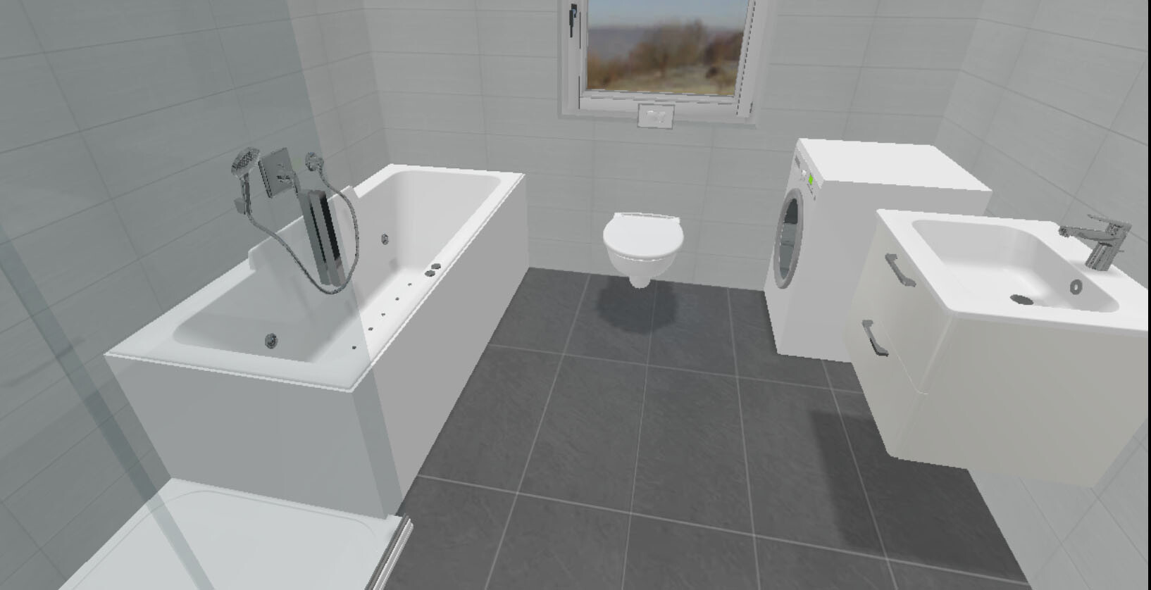

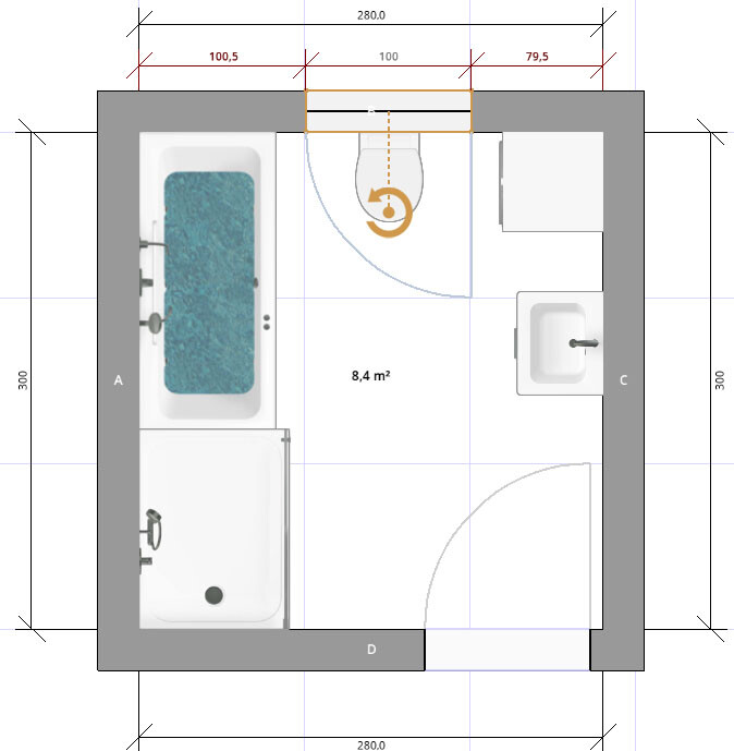

knalltüte1 Mar 2020 16:01Well, it also seemed tight to me. Yet, some people plan even smaller bathrooms. The entire living unit is only about 4.8m² (52 sq ft).
The tip about using a bathroom planner was helpful. I only tried house design software, and I really couldn’t manage with that. Attached is the adjusted layout, a bit more open. The toilet is now facing forward. What do you think?

Osnabruecker1 Mar 2020 16:04Inconvenient.
Washing machine door opens towards the toilet, no space for a laundry basket in front.
Swap the toilet and washing machine?
