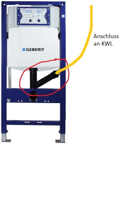

Regarding the odor extraction:
There is a branch in the supply line for the flush water between the cistern and the toilet ceramic, as shown in the attached picture.
This is simply connected to the mechanical ventilation system, like a standard plate valve.
However, it is essential to ensure that a throttle damper is installed on the distribution box to precisely control the airflow.
Otherwise, the toilet will start to whistle and will also extract air through the overflow at the cistern and the flush plate. This causes dust to accumulate there and enter the cistern.
We’re currently experiencing this problem because the ventilation installer did not install a throttle.
According to Geberit, a maximum of 8.5m³/h (300 cubic feet per hour) should be extracted to avoid this. In our case, it’s sometimes up to 13m³/h (460 cubic feet per hour).
Now the ventilation installer has to come back to install the throttle dampers...
Other than that, I can definitely recommend the system.

Otherwise, I can definitely recommend the system.How does it work in summer when the normal mechanical ventilation is switched off during the day?
