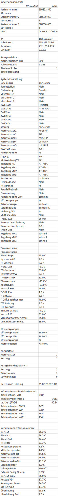

My heat pump has been running for 5 hours:
Supply temperature: 23.7°C (74.7°F)
Return temperature: 24.3°C (75.7°F)
Target return temperature: 26.2°C (79.2°F)
Outdoor temperature: -3°C (27°F)Hey, I’ve analyzed the data now, take a look and let me know what you think:
Daniel-Sp7 Dec 2019 16:58Wow,
after just 4 months, nearly 4000 compressor starts. You should urgently optimize the heat pump settings, otherwise you’ll be buying a new heat pump in a few years!
Disassemble the ERR, open all heating circuits completely at first, close the bypass valve completely, set the domestic hot water hysteresis to 6°C (11°F), set the domestic hot water target temperature to 48°C (118°F), heating curve 28/22/0. And no, your installer won’t provide you with a properly adjusted system.
Regards, Daniel
