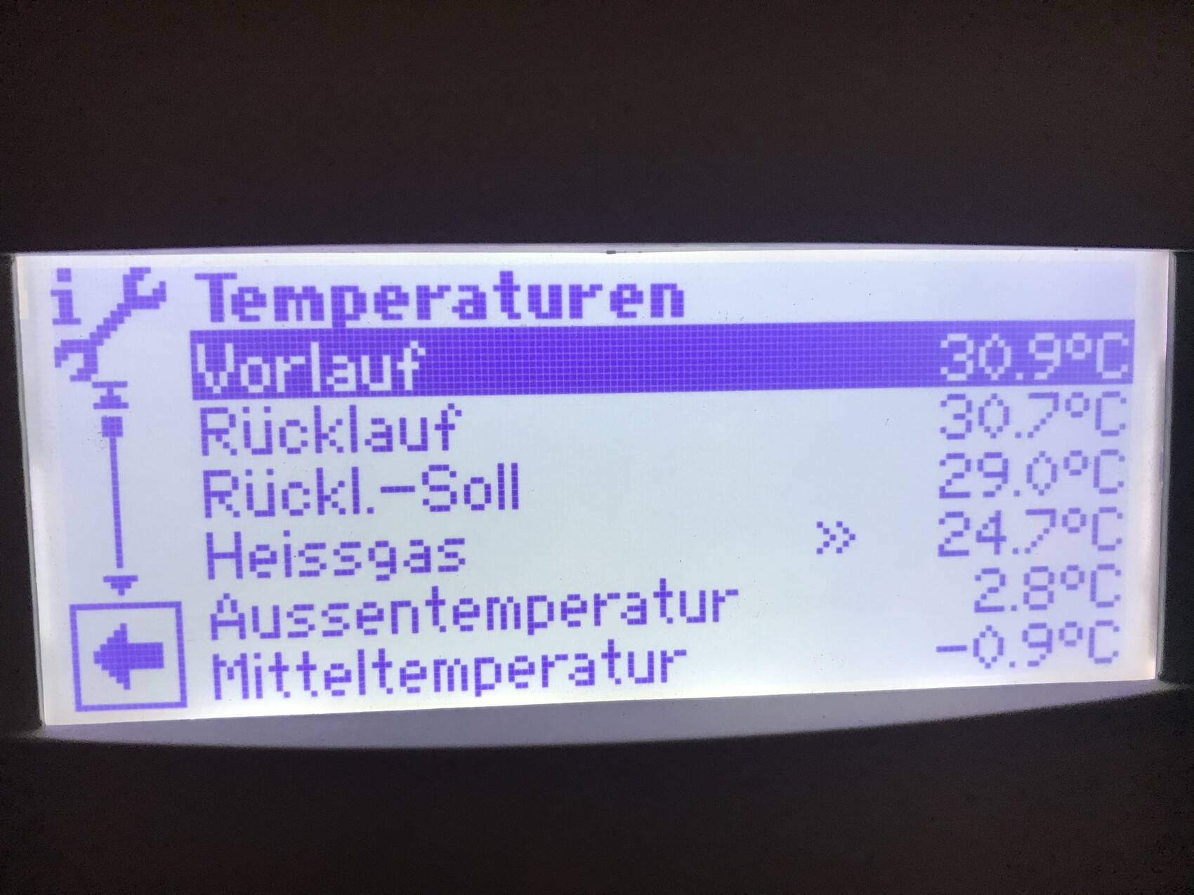

I just found this, which is probably the actual value:
Thermostat display shows supply temperature 30.9°C (87.6°F), return temperature 30.7°C (87.3°F), and outside temperature 2.8°C (37.0°F).

guckuck2
6 Dec 2019 17:37
30.9°C (88°F) at an outside temperature of 3°C (37°F) is far too high. The return temperature is only 0.2 K below the supply temperature, meaning the heating energy remains in the water. Most likely, all ERRs are closed?!
I would recommend having the system inspected. Nothing is working properly.
