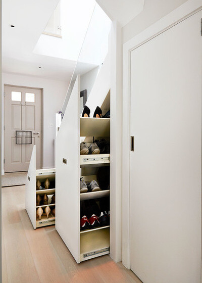

I miss a coat closet – or is that small niche at the end of the hallway, near the kitchen?
Jochen104 schrieb:Correct, the niche should be a small coat closet. However, we are also considering possibly using the space under the stairs. But thanks for your idea, Jochen, I will discuss it again with my wife.

We are also considering possibly building under the staircase. But thanks for your idea, Jochen—I will discuss it again with my wife.
Great idea, I really like it, and it fits perfectly here (no basement anyway)!The issue will be solved above this area. Moving it will create enough space to place the towel radiator near the shower.Uh, but the wall doesn’t get larger toward the window, right? Or do you want to place the towel radiator practically "in" the shower entry/pass-through? That could work if it’s wide enough—although I actually like the somewhat discreet toilet location on the right side, especially since there’s just one toilet planned for four people...... children’s bathroom. However, we consider it unnecessary and have therefore opted for an open space instead.Okay, that’s up to you 🙂We didn’t want an en-suite solution (whether bathroom or dressing room) so that people can get ready without disturbing anyone still sleeping.I was thinking of having one bathroom between the kids’ rooms—each with "their" door, even though the bathroom would be shared... Before eventually needing to use the downstairs shower because the upstairs one is occupied... And if the doors are properly sealed (like the utility room door 😉), I can imagine that it could be quite soundproof?! We definitely have such a bathroom (between two bedrooms) on our list as an idea...Maria16 schrieb:
