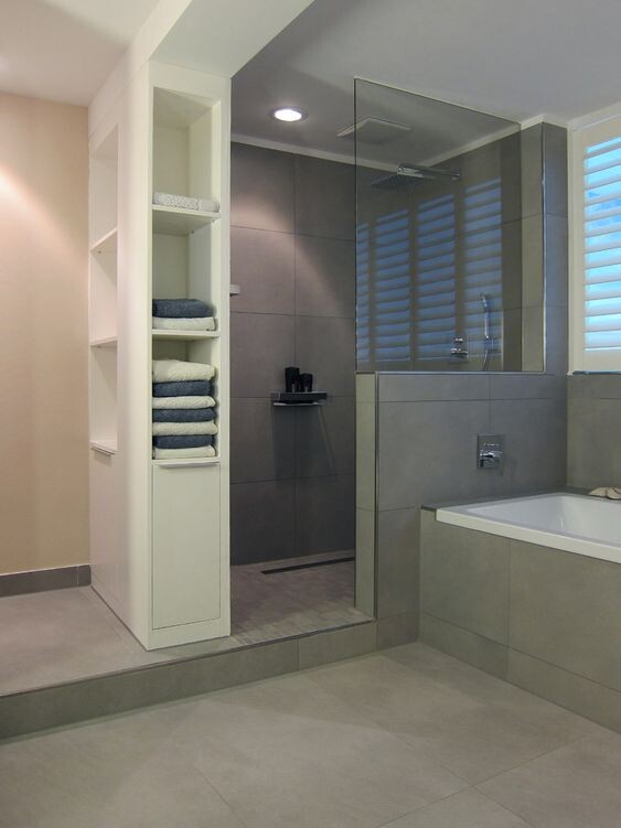

Bertram1005 Jan 2020 19:37danixf, I also chip off the tiles. But it only takes about half a minute. Your shower looks really nice – wall plus glass. It looks good and is probably practical. I would like to avoid doors, hinges, and corners on the shower screen. How big is your shower?
Bertram100 schrieb:
danixf, I also tile the walls quickly. It only takes about half a minute. Your shower turned out well – wall plus glass. It looks good and is probably very practical. I’d like to avoid doors, hinges, and corners on the shower enclosure. How big is your shower?The picture is just from the internet (unfortunately). Our shower is about 1m x 1.20m (3.3ft x 4ft). One side has a wall 2.10m (6.9ft) high... but we also have an extra recessed light inside the shower.That’s how you avoid doors and hinges... avoiding corners will be difficult.
