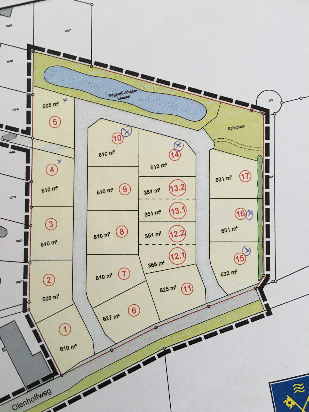

We purchased a plot of land in the lovely town of Buxtehude (yes, it really exists) in Lower Saxony, south of Hamburg. Attached you will find an overview of the plots in this small new development area, and we can call number 16 ours.

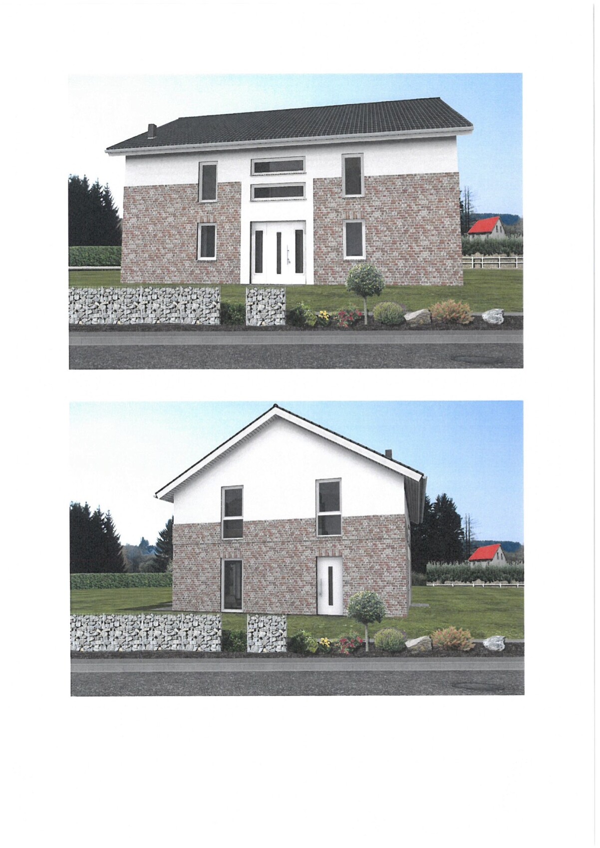

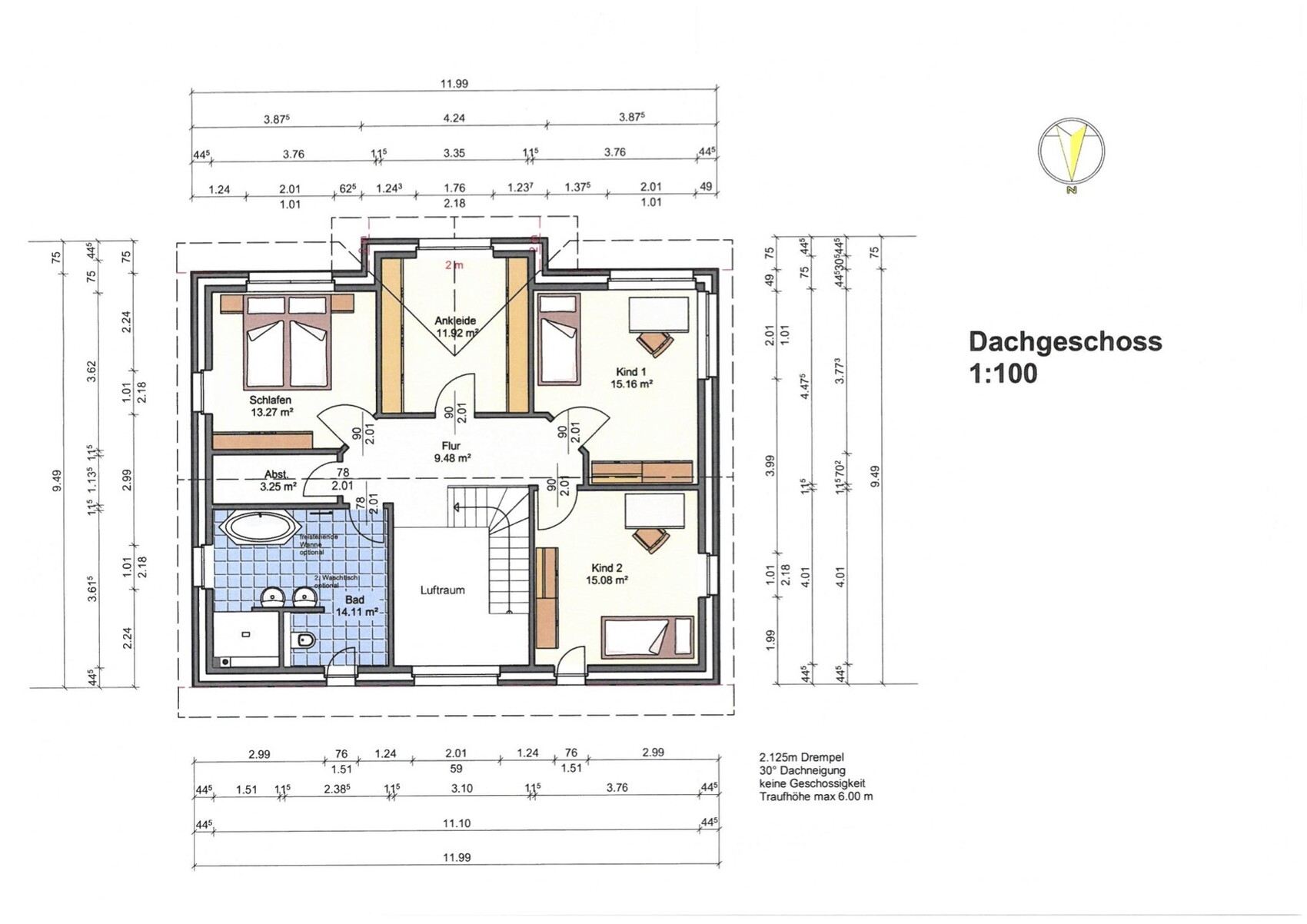

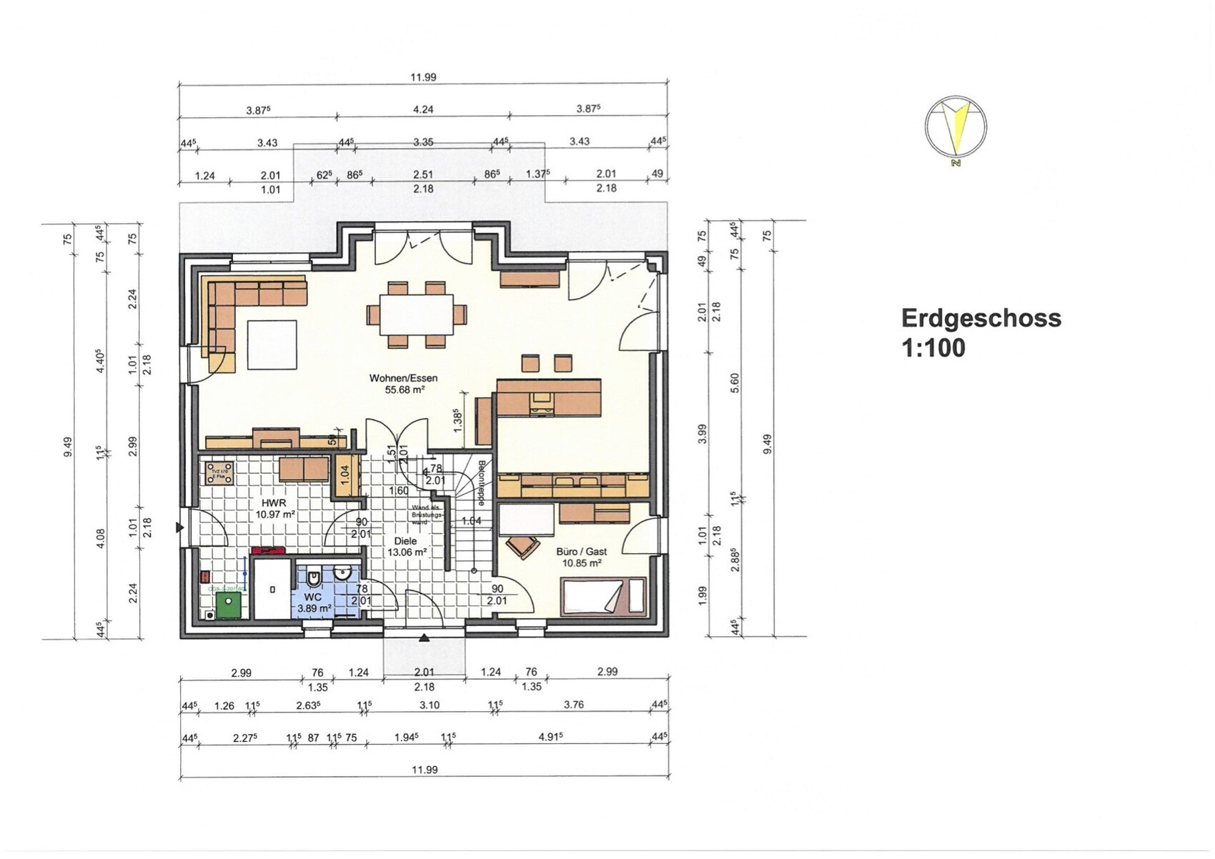

You can find the house details in the attachments (floor plans and elevations), so here are just a few notes about our requirements:

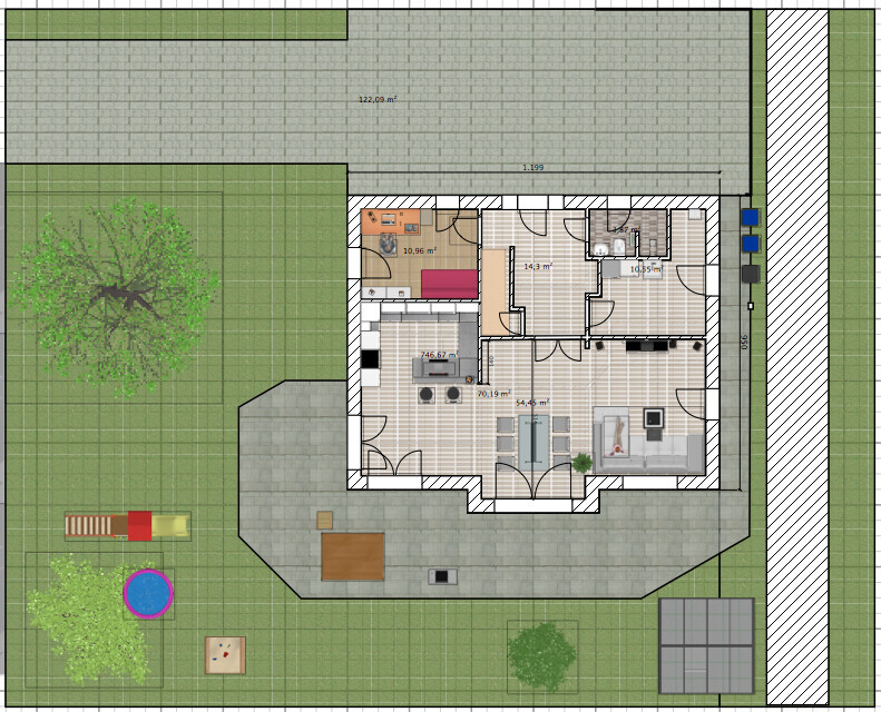

Off the top of my head, I don’t have much to complain about, except for a double carport designed for tandem parking??? No way, if at all possible I would change that to side-by-side parking, because according to Murphy’s law, the blocked-in car always has to move out first...

The storage room on the upper floor is quite narrow and therefore not usable in terms of depth.
The walk-in closet is nicely large, but I would question whether it really needs to be that big and whether the bay window is the right place for it.
Otherwise, I think the floor plan is pretty good.
