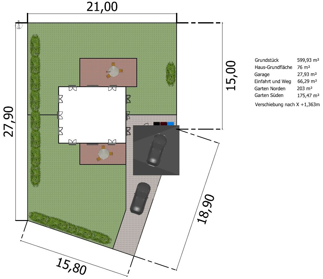

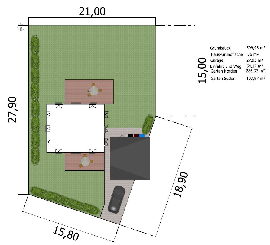

After some time, I’d like to give you an update.
We have moved away from the “usual” prefab home providers and are now working with an independent architect. He lives nearby and, after reviewing all the documents, created “Proposal 1.” I have recreated this in Sweet Home 3D.
His proposal aligns quite well with your ideas by placing everything facing south. He explains this by saying that the main garden is on the north side. Due to the known neighboring developments, this garden receives a good amount of morning sun from the east. Additionally, the north garden acts as a sheltered area from the street located to the south and provides substantial shade, at least during the peak summer.
Questions:
- What do you think about this?
- Somehow, I still can’t assess what this garden will be like outside the summer months. Will it become a dark, shaded area? Will anything grow there? Since I can’t judge this, I’m a bit worried about making a mistake here and ending up with a “dead” space.
- In another version of the plan, I moved the house with the garage 4 meters (13 feet) north, which would make the north and south gardens roughly a 50/50 split. Do you think that is better or worse? I’ve heard that an even garden distribution is not ideal because then you don’t have a main garden but two smaller ones.
Thank you in advance for your feedback!
Questions:
