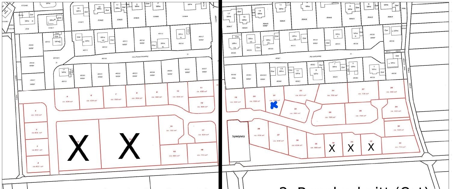

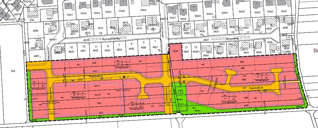

We are planning to build a single-family house. As of now, we have reserved a plot of land in a small town and have already had initial discussions with several developers. One question we are still uncertain about is the positioning of the house on the plot.
Site plan from the development plan
Building plots from the tender
Traced plot
Plot with rough layout options
Our plot is number 21. It is on the right side, top row, third from the left (marked with a cross in one of the images).

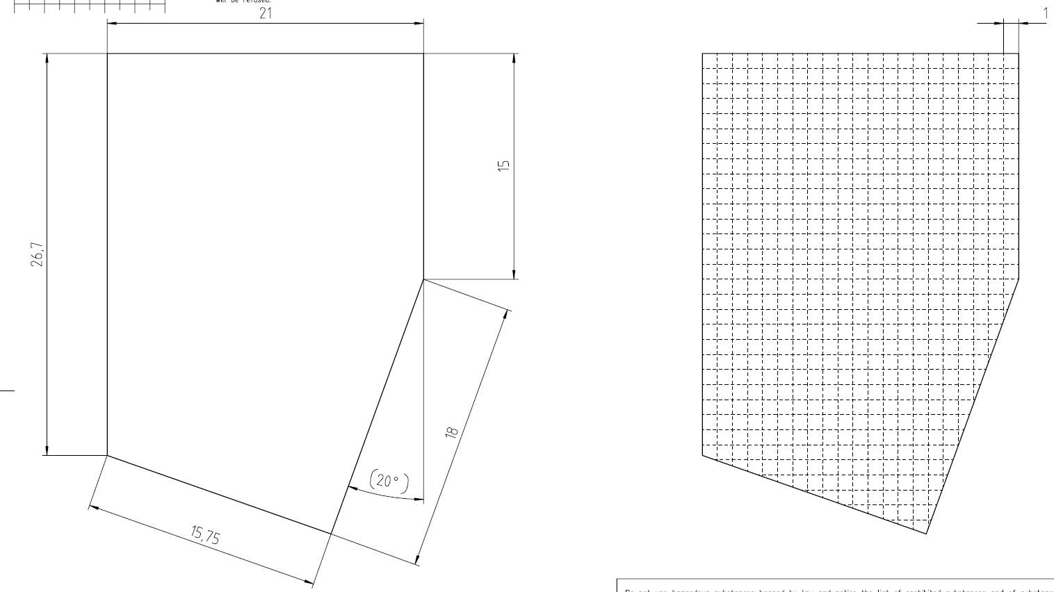

Question: How would you position a single-family house of about 10m x 9m (33 x 30 feet), with a basement and 2 full floors, on this plot? We already have two ideas and would appreciate your opinions or any new input.
There is a street bordering the southern side of our plot. Since there is a major employer in the town and many employees live nearby, we expect quite a bit of public traffic and many familiar faces. To avoid too many inquisitive looks and unwanted conversations, one planner suggested positioning the house at an angle. The terrace extending around the corner would be shielded from street view, possibly also by planting bushes in front of the terrace. On the north side, there was a suggestion for another "terrace" to enjoy the morning sun or to be able to sit outside on hot summer days. However, as a layperson, I wonder if that would place me quite close to the western neighbor and might awkwardly divide the plot and garden.
Please do not consider the layout variants as exact to the meter; they are intended only as initial suggestions.
