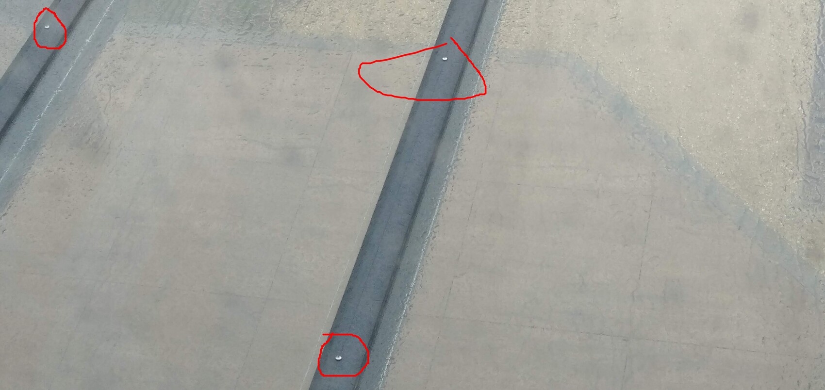

immermehr1 Feb 2022 17:02Hello everyone,
today I noticed at my neighbor’s place that there is a sliding (click) profile installed at the joint between the glass panels at the top. In our case (KD canopy), the profile is only screwed on. I’m worried that rain/water could get in through the screws.
How is it done at your place?
immermehr schrieb:
Today I saw at my neighbor’s place that there is a sliding (click) profile covering the joint between the upper glass panels. For us (KD canopy), the profile is only screwed in. I’m concerned that rain/water might seep in through the screws.
How is it done in your case? It looks the same for us as for you (AS patio roof), but the roof is watertight.
