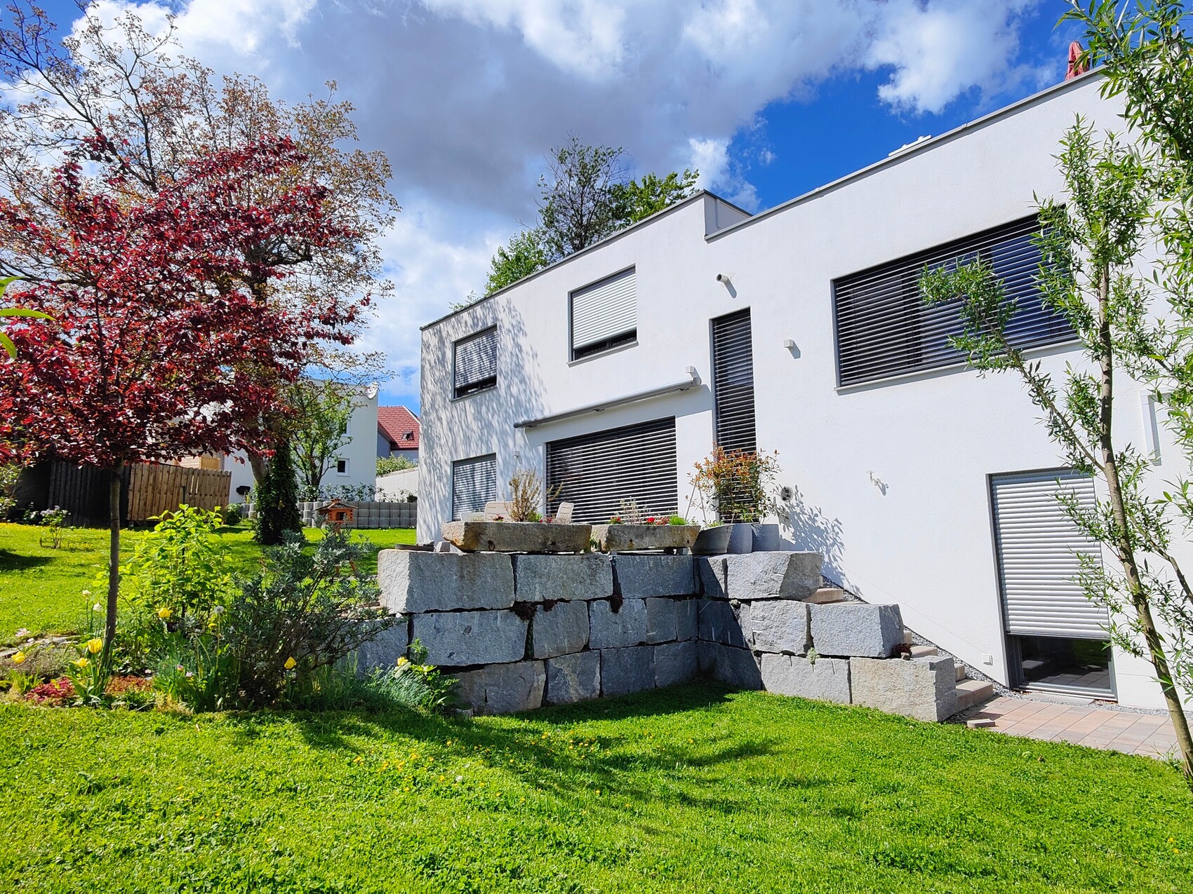

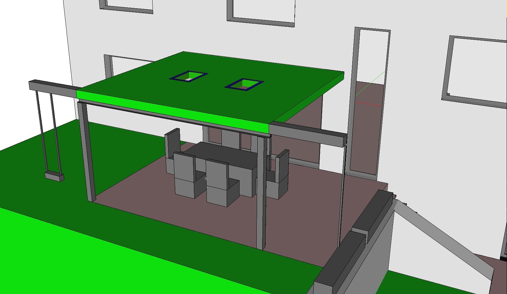

We have now decided to go with a wooden structure instead of glass.
To keep it from getting too dark, we want to install two skylights. In the long term, the roof will also be extensively greened.
Since we will need a swing soon anyway, I thought about somehow combining the two.
We also have the problem that we don’t quite know where to put the roof drainage.
So this is the design I came up with:
There is space on the left for a swing. If it’s no longer needed, a cozy hanging chair will go there.
On the right, the gutter can be extended and then drained via a chain or a waterspout into the retaining wall.
At the front of the canopy, we’ll install the awning that we unfortunately bought (a bit too early) two years ago. That way, the paddling pool on the terrace can also be shaded, and the awning won’t go to waste. 🙄
I find this quite amusing and am now waiting for the carpenter’s quote.
A bit unusual, but that fits the house quite well 😀:p
