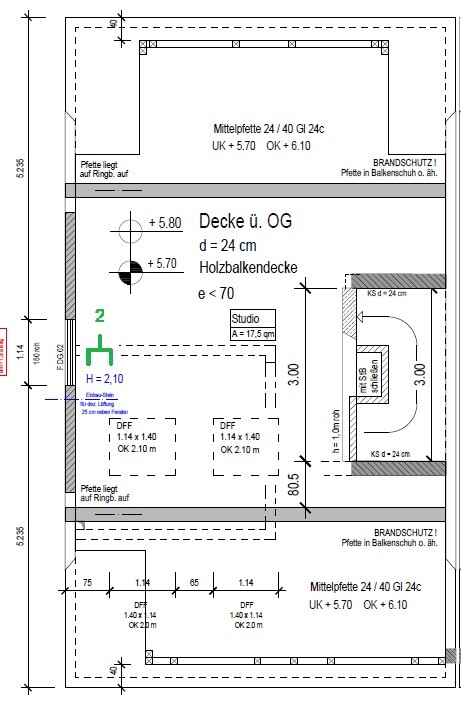

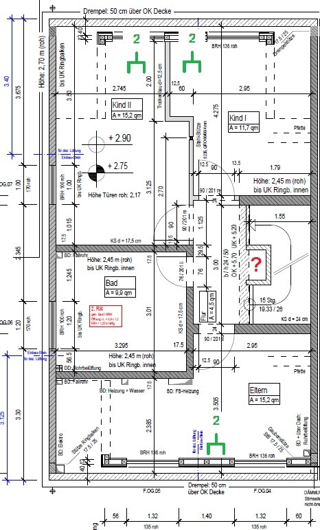

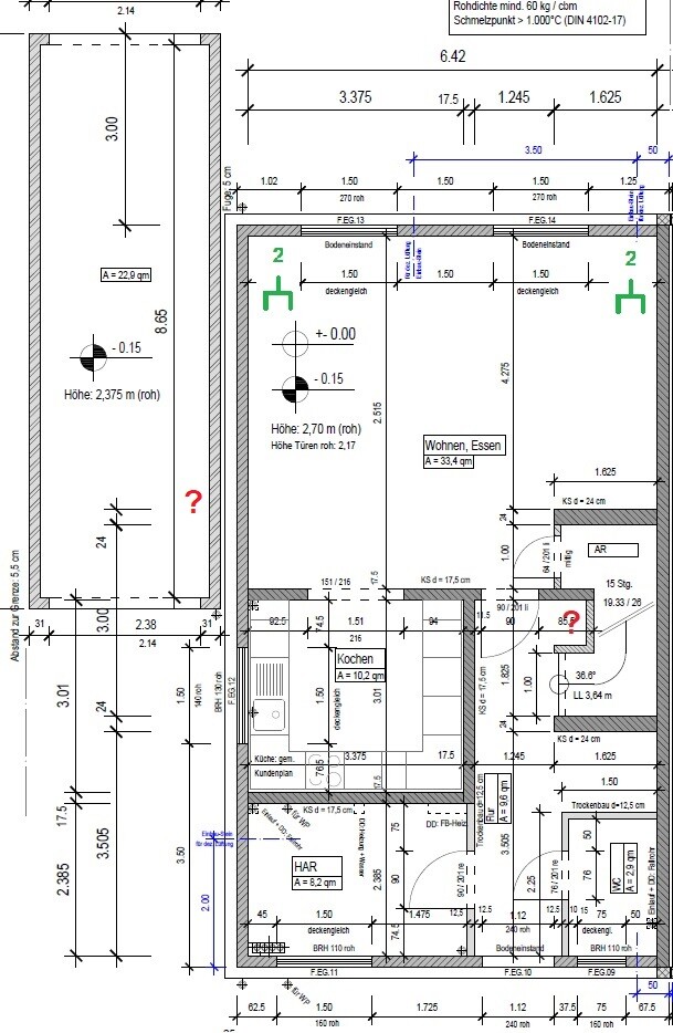

Good point. So far, we have planned one twin outlet for each bedroom/study and two in the living room. See green markings.
Now that you mention it, I would also consider adding network outlets plus access points at ceiling height in both hallways, see red question marks. Also one in the garage, but something was already planned there for the future wall box preparation.
Our exterior dimensions are 7 x 12m (23 x 39 feet), so that should be sufficient, right? Do you have a recommendation for an access point?
