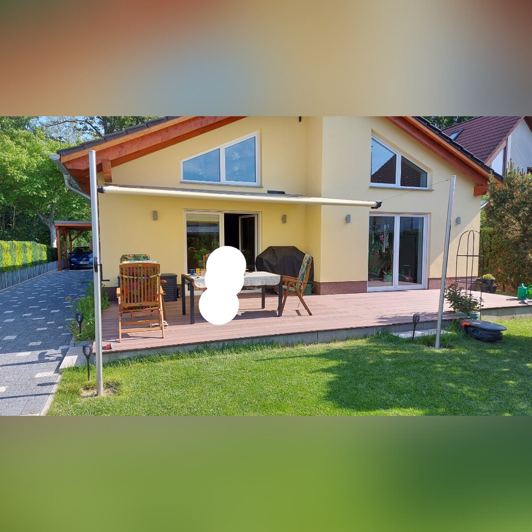

Since I’ve had so many good experiences here, I just have to ask a question again.
We live in a new build with a southwest-facing terrace measuring 3.3 x 6 m (11 x 20 ft).
Last year, we used a gifted sun umbrella with a diameter of four meters (13 ft) to shade the terrace. Unfortunately, despite its size, the umbrella was always placed “wrong” and I would have had to put it on the lawn to provide shade for the terrace.
Since we currently have two small children, we need something new.
I would prefer a fixed structure with a louvered roof or something similar, but that is unfortunately not really affordable at the moment.
So now we are considering a retractable awning. The problem is that on the south side of the terrace, there is a downspout installed by the builder that extends 60 cm (2 ft) towards the terrace.
We are therefore thinking about an awning sized 5 x 3.5 or 5 x 4 meters (16 x 11 or 16 x 13 ft) with a valance. There is also an electrical connection available. The valance is meant to block the low sun and also to allow the children to play in the shade on the terrace floor.
One of the consultants advised against the valance because it would be very susceptible to wind and constantly swing. He only recommended a deeper awning to block the evening sun. Of course, whether that is enough can only be seen once it’s too late.
What are your experiences with a southwest-facing terrace? Is a retractable awning an adequate sun protection? Or is there perhaps a better solution?
Currently, we have an offer for a fully electric retractable awning with valance, sized 5 x 3.5 m (16 x 11 ft), for about 6,000 euros.
I would really appreciate any tips and suggestions.

I had a similar situation with my house and definitely did not want an awning, but rather a sunshade that could stay outside for the entire season. I decided on a sun sail. Two large U-shaped brackets welded by a metalworker were anchored into the exterior wall. Two stainless steel posts with a length of 10cm (4 inches) were concreted in front of the terrace. A storm-resistant and waterproof sun sail from a sailmaker. It is tensioned with stainless steel cables and cable tensioners of appropriate tensile strength. This setup has now been in use for over 15 years, has proven technically reliable, and, in my opinion, also looks very stylish. The sail is installed in April and taken down again in October.
The sail originally cost around 600 EUR, and the stainless steel work about 400.
