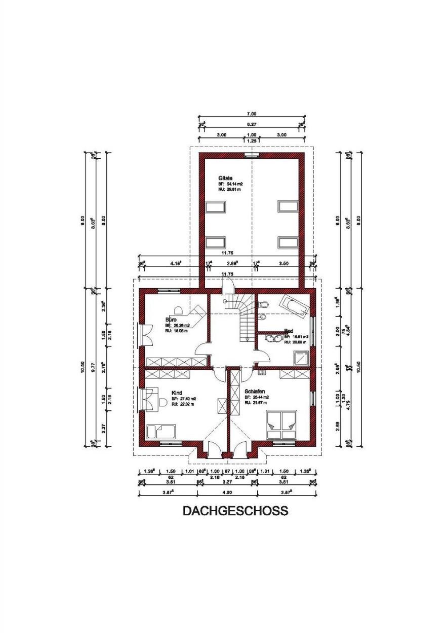

Regarding our project, we are planning a single-family house with a garage, no basement. We have now received a floor plan variant from the builder.
What we’re not completely happy with is the somewhat small kitchen (and the pantry could be about 50cm (20 inches) wider). We want to include a small seating area in the kitchen. Also, if possible, the kitchen should be separate/closed off. This would naturally result in a very large combined dining and living room.
Does anyone perhaps have ideas on how to organize the layout differently? We are currently considering extending the house by about 1 meter (3 feet) on the kitchen side, but sometimes someone has a different suggestion!
I am thankful for any tips!

The "child’s room" and "bedroom" will be swapped, then 1 meter (3 feet) will be taken from both the bedroom and the office to create a separate walk-in closet.
The "large area" above the garage will become 2 rooms, but without a full finish yet. It’s planned to be a second "children’s room" and a "man cave," but for now without extensive construction.

But back to the topic (basement): I think the solution with three doors and the slightly shortened dining room is very good. If you install sliding doors to the pantry and the living area, you won’t lose any space (and it looks stylish). Your dining room will still have plenty of room (just trust us on that) and the large space gains more definition (in addition to the fireplace), which certainly doesn’t hurt.

thank you! So, the wall toward the dining room will now be moved by 0.75 m (2.5 feet). Tomorrow there is an appointment with the kitchen fitter, let’s see what they come up with!
I was just thinking for a long time whether the 4 m (13 feet) width of the dining room would be enough.
In the meantime, there are a few small changes:
- The garage will be made 1 m (3.3 feet) deeper, so the external dimension will then be 8 m (26 feet). In the small room on the right, which forms the "transition" from the house to the garage, the buffer tank and the "water channel" will be installed. It will have a length of about 3 m (10 feet) and a width of 2 to 2.5 m (6.5 to 8 feet).

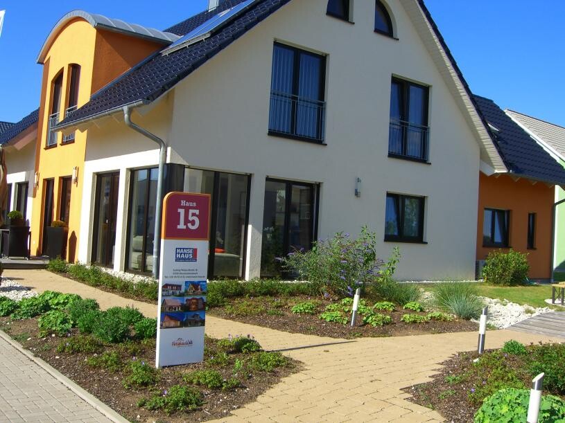

- In the corner of the living room, a few floor-to-ceiling windows or doors will be added, similar to the photo attached.
- The kitchen window is planned to be about twice as wide.
