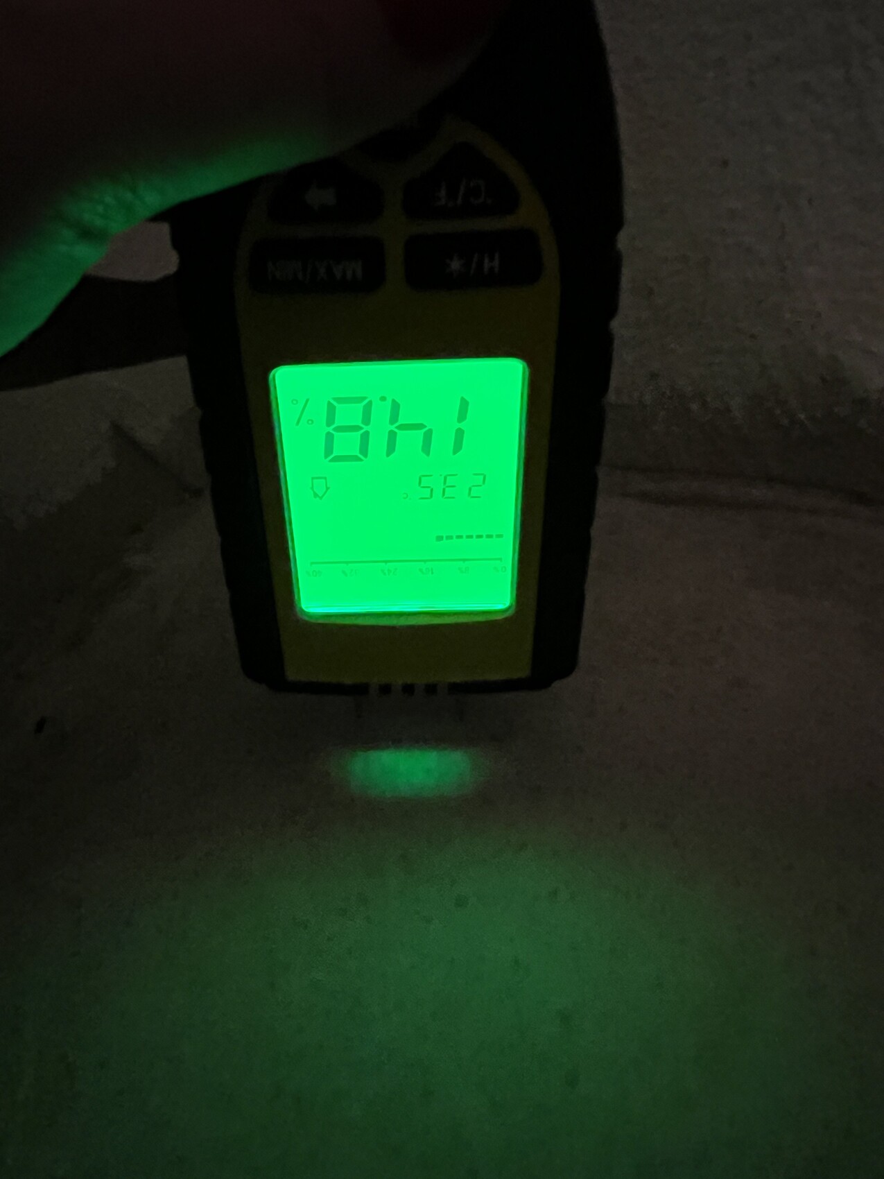

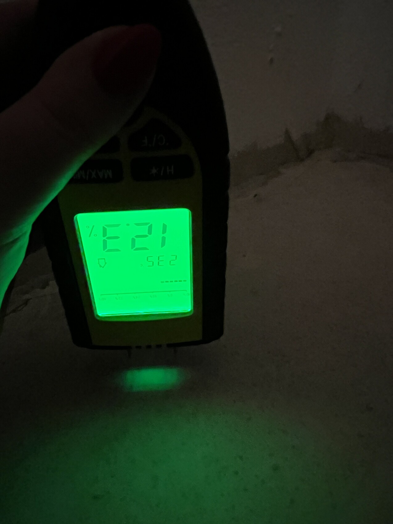

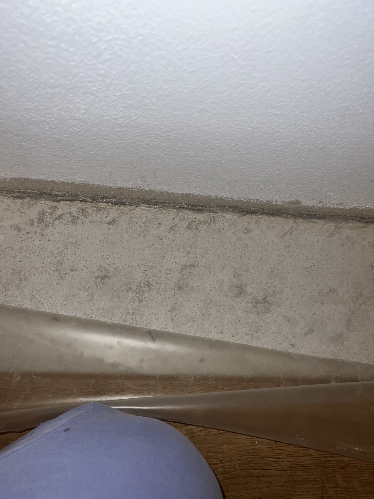

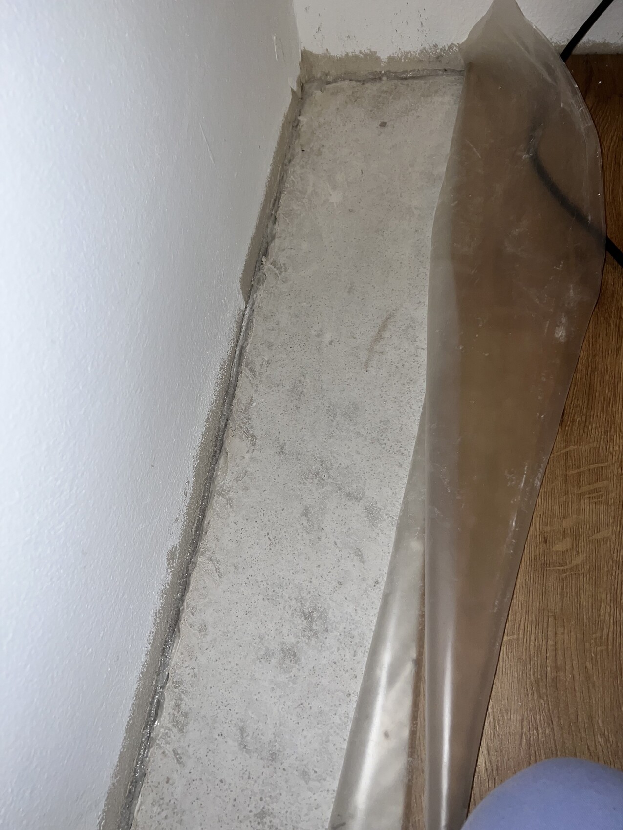

We already did that. It doesn’t feel noticeably wet or damp… I’m adding some pictures.

Is this too damp? Could that be the reason?
