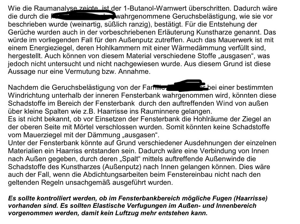

Hello, are there any new insights about the issue? Hello, I’m attaching what the expert report stated. The problem definitely does not originate from the ground. The odor had completely disappeared for a long time, and only started again with the onset of freezing temperatures, snow, and wind combined. The construction company has not responded at all to the expert report and the defect notice (including additional issues). Even a lawyer has not been able to help us so far.
