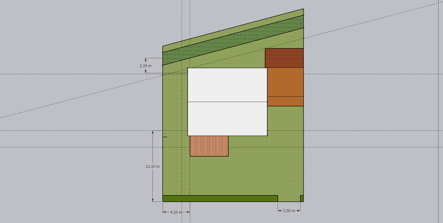

Regarding the placement on the plot:
The basic idea is that we want a south/west-facing garden. On the west side, the neighbor will most likely place their carport, so we prefer to have more garden space in the south. Therefore, we favor a position with the ridge parallel to the street (gable end facing sideways), which might also be advantageous for a photovoltaic system in the future. Additionally, we would like to have dry access from the carport to the entrance, which is why the entrance is positioned on the gable end.
For further positioning, the house including the carport was shifted as far northeast as the building area allows.

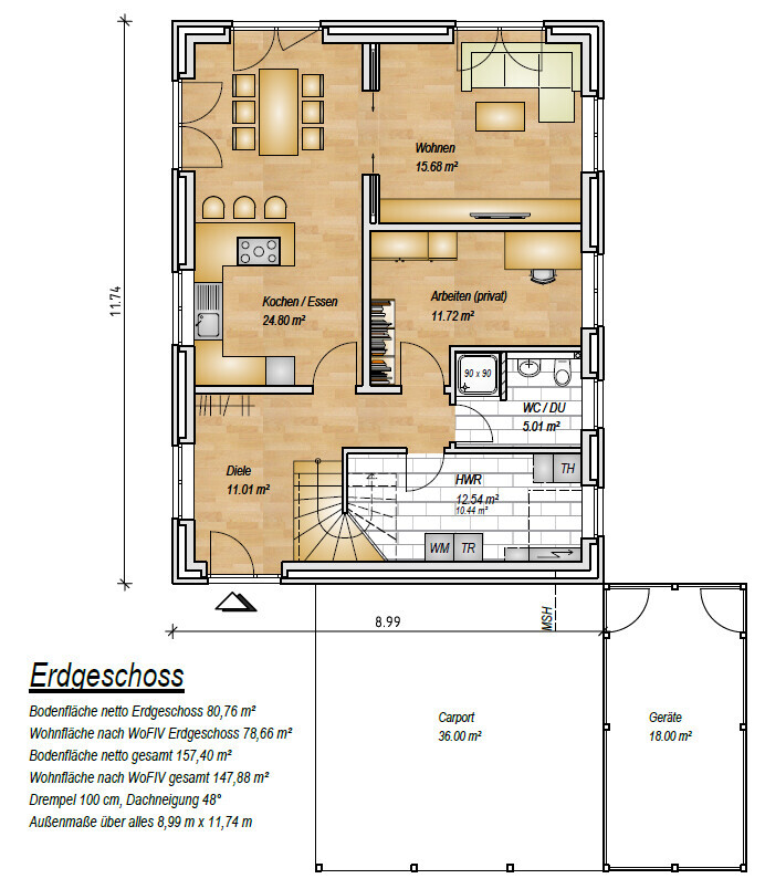

Regarding the floor plan itself:
The main consideration is that we want a living room (approx. 4 x 4 m (13 x 13 ft)) as a retreat. The dining area with open kitchen should be actively used, not just a space for guests twice a year. From the dining area, one should be able to access the terrace.
Overall, there should also be space for a home office as well as a master bedroom with a walk-in closet.

We are still not sure about the kitchen. It will be sufficient (it has to be), but the current layout is not correct. We definitely won’t have a kitchen island or peninsula, so there will be more space overall. We are considering moving the kitchen door further to the left, so that a shelving unit can be placed on the right side. Alternatively, we might shift the wall towards the study by the depth of a shelf.
We still need to take a closer look at the suggestion regarding the walk-in closet! I can see benefits in all the options.

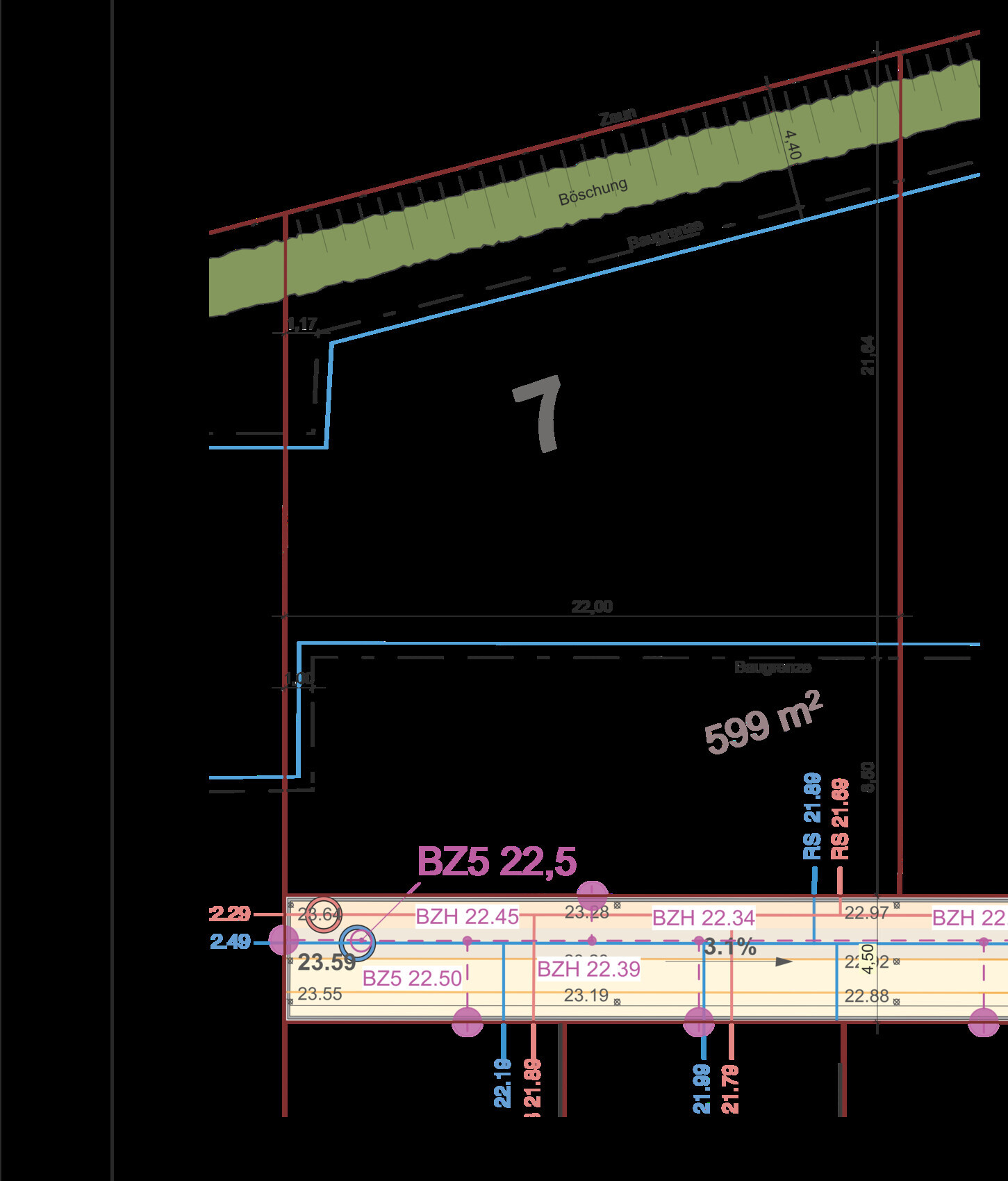

About the plot:
With a gable-end orientation, there would be only about 7 meters (23 feet) between the house wall and the property boundary on the west side. In addition, the neighbor, because of their building window, is more or less forced to position their carport at the same height as our terrace. I think I would feel too cramped there. On the south side, there is a dead-end street, and behind that, the neighbors’ front gardens follow. That feels much more open.
Since I am absolutely not a fan of sun, this is definitely a consideration I’m aware of. Our current plan is to plant a tree in the garden that will eventually provide shade for the terrace.
Architektenplan eines Baugrundstücks mit Baugrenze, Zaun, Böschung und Fläche 599 m²

I would really recommend fully planning out the kitchen. Ikea offers a good way to do that. Then simply make a list of how many drawers and/or tall cabinets you need...
Personally, I would probably move the door to the left and place a full wall of tall cabinets on the right, with an L-shaped kitchen on the left. But that’s just an idea.
The idea of the tree of course makes sense, but it’s not very effective in midsummer. Once the air temperature rises above a certain point, a tree won’t really help. Especially not in southern regions. In theory, you could build two terraces if you position the house further south, right? That might be something worth considering.

I find the floor plan quite interesting overall, but personally, I would be bothered by having to walk through the kitchen to get to the living/dining area.

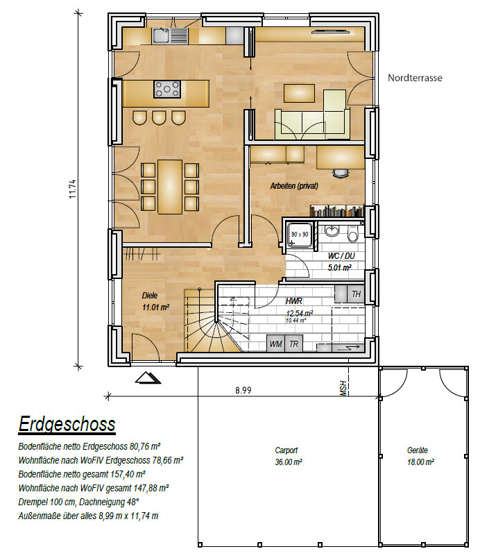

Small kitchens can work, but most of the time there is a lot of clutter, so it doesn’t look very tidy. I would therefore swap the dining area and kitchen, and make the study and living room a bit smaller. Also, change the windows and avoid placing the sofa in front of a window. Preferably have an exit facing north with a small terrace in front of the hedge. An idea is attached here.
Upstairs, I would make the bedroom and/or bathroom a bit smaller and enlarge the walk-in closet. That way, you have limited furniture placement options.
EG-Grundriss: Küche, Essbereich, Wohnzimmer, Büro, Diele, WC/Dusche, HWR, Treppe, Carport
