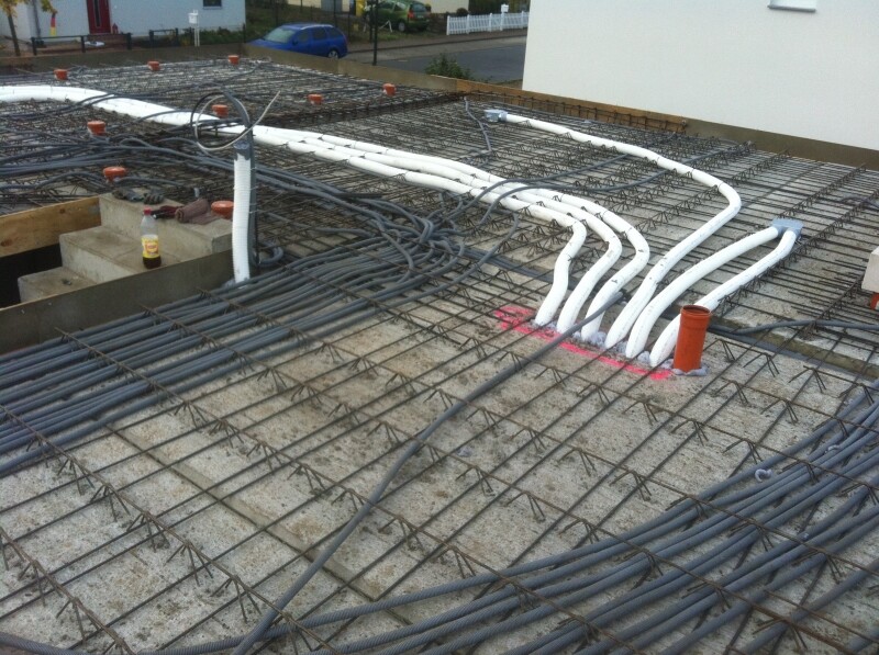

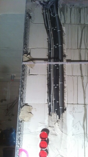

When doing new installations, do it properly. On the ground floor, all the cables are embedded in the concrete ceiling; there are no cables laid on the floor. The disadvantage is that grooves have to be made from top to bottom, but the advantage is that there is no need to cut through the insulation.

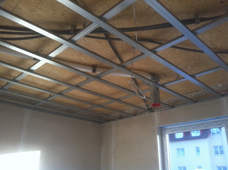

On the upper floor, all the cables also run along the ceiling.
Sebastian7910 Dec 2015 20:48The slots are not vertical from top to bottom.
We did it the same way, but especially on the ground floor, there is still quite a bit lying on the floor because good ideas emerged during construction.
Upstairs, the floors are almost bare, and in the basement, there are only a few cables along the edges.
