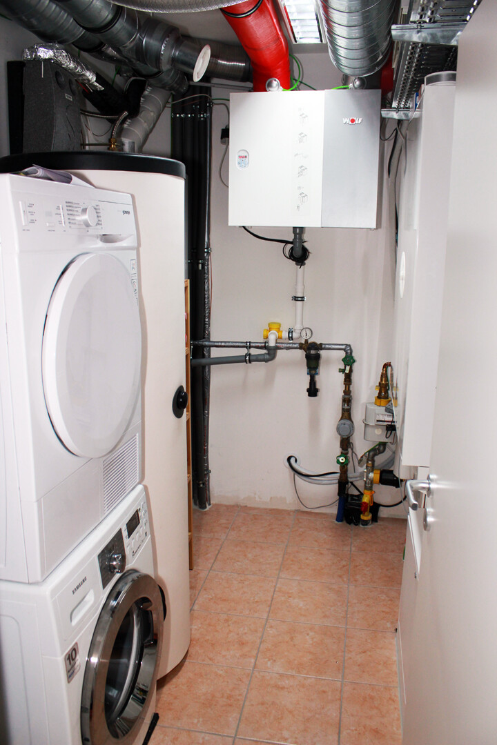

As I mentioned earlier, everything can be much more compact as well... here are:
- Condensing boiler
- Solar station
- 300L (80 gallons) storage tank
- Washing machine
- Dryer
- Mechanical ventilation with heat recovery
- ZB34S Hager electrical cabinet (approx. 1m x 1m (3.3ft x 3.3ft))
- Network corner for 24 outlets
and, of course, all utilities including meters for gas, water, electricity, and telephone.
All fitted into 4.5 m² (48.4 ft²)... I wouldn’t recommend this size, but it’s possible...
Laundry/Utility room: Washing machine on the left, white heating system and pipework
arubau3630 Nov 2015 17:20
Wow... that’s impressive. But you’re only inside to do the laundry. Luckily, there is something like a utility room. Better than nothing. And do you sometimes hear the ventilation system? I see it’s from the company Wolf. Or am I mistaken?

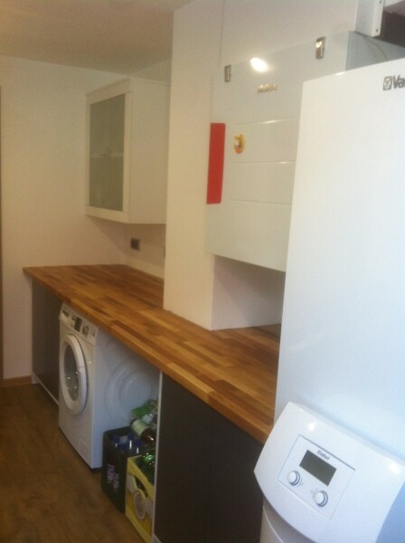

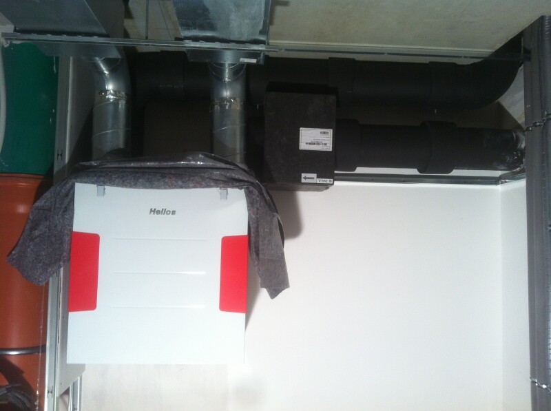

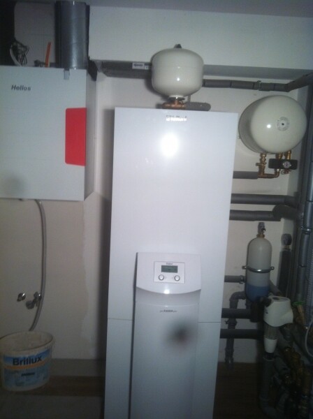

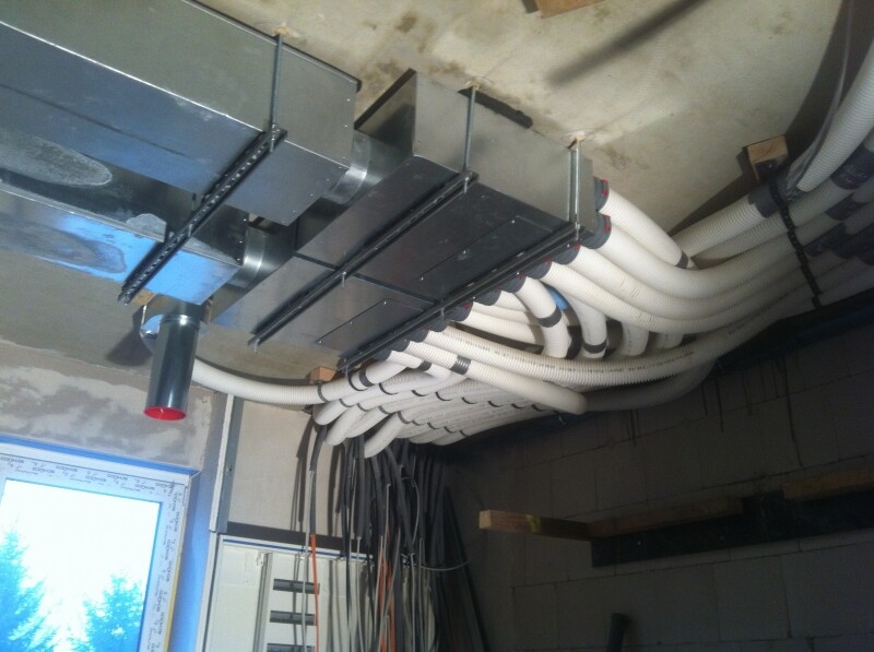

A few pictures of my utility room
Before / After
White unit with red side panel, labeled Helios, next to pipes and ventilation ducts.
White flexible cables and hoses running under the ceiling alongside metal ducts.
Large white heating boiler in the heating cellar with expansion tank and pipes.

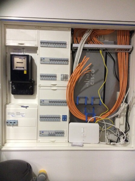

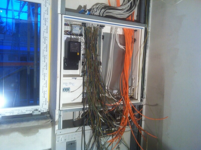

Open server/network rack with many tangled cables (orange and black) and patch panels.
Network cabinet with patch panels, orange cable bundles, and Cisco device.

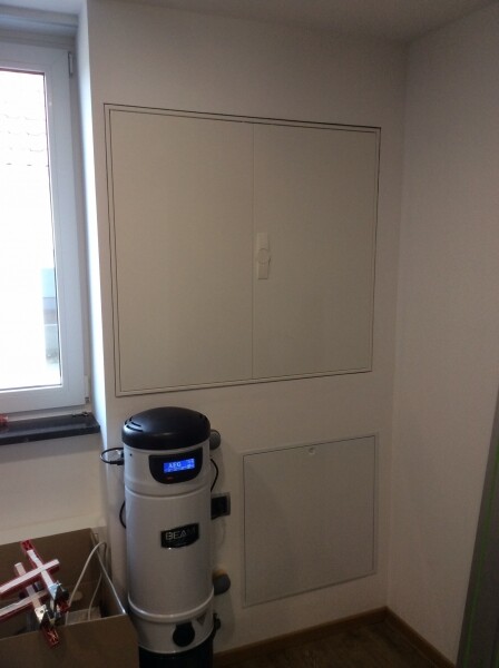

Small interior corner with white wall cabinet, central vacuum tank, and window.
Laundry room with wooden worktop, washing machine, white cabinets, and storage space.
