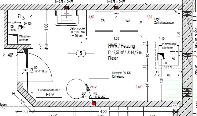

Sebastian7929 Nov 2015 22:15Since our utility room also serves as the laundry room, we deliberately planned it to be more spacious, which I now really appreciate. There is enough room comfortably, but the space couldn’t be any smaller.
The picture still lacks the base of the heating unit, which I insisted on (in case water gets in) – and the 20 cm (8 inches) clearance for the heat pump is included in this (a total depth of 80 cm (31.5 inches)).

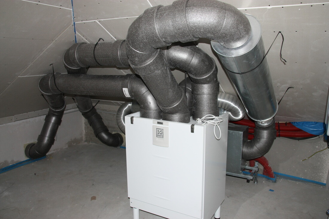

We have a large system from Vallox, which probably requires at least 8m² (estimated, not measured) - Valloflex 510SE.You mean a mechanical ventilation unit with heat recovery (HRV) that fits everything inside, requiring at least 8m² (estimated)?
The unit itself seems to measure about 75x75x50 cm (30x30x20 inches).
nordanney30 Nov 2015 10:52No, the device with all the cables and dampers requires that much space. I'll see if I can quickly find a photo.
nordanney30 Nov 2015 10:57This is how it looks in reality. The device itself is small, that's true. Additionally, there is a box behind the device where all the ducts from three floors (these are the red flexible hoses) are collected.
The outdoor connections are also located in this room (left side in the picture) – overall, the basic unit becomes quite a ventilation monster.
