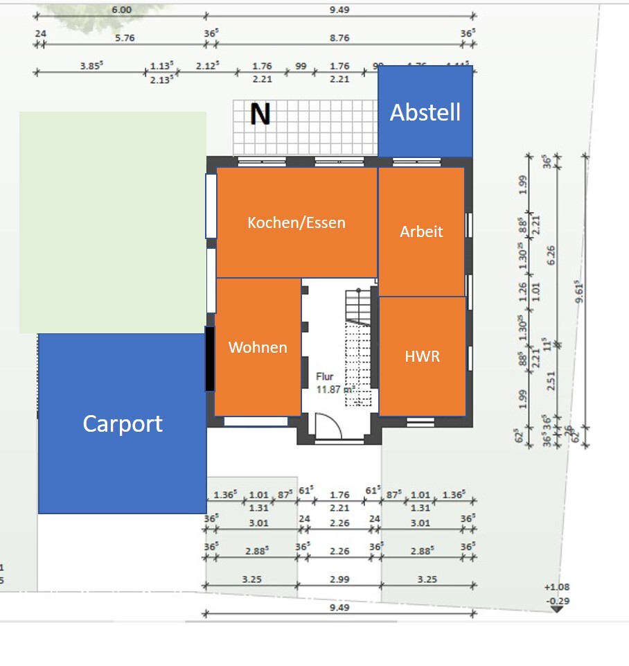

RomeoZwo13 Apr 2020 15:06
I would leave the carport on the side, but create a stylish, large south-facing window at the front, i.e., southwest of the house. From the multipurpose room. Utility rooms in the east. But you have to see how that fits.
Do you mean something like this? If you give up on symmetry, it could work. The multipurpose room could have nice west-facing windows.
Maybe then also the kitchen area in the south – the light would shine through into the living area in an open-plan space.
I would then consider a platform/spiral staircase in the east, but then we would also need a new upper floor.
Floor plan: Kitchen/dining, living, work, utility room, storage, carport, hallway.
