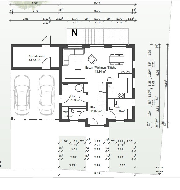

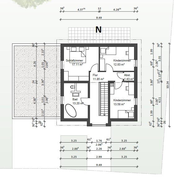

Hello dear forum community,
we are well advanced in planning our single-family home with a gable roof and have already decided on a construction company. Unfortunately, we are not yet 100% satisfied with the current floor plan. Therefore, we are now turning to you for advice.
Building Plan/Restrictions
Plot size: 1,010 sqm (1,010,000 sq ft approx.)
Slope: slightly rising, approximately 1.8 m (6 ft) from the house location to the end of the plot
Site coverage ratio: No building plan, plot has 20 m (65 ft) frontage
Building window, building line and boundary
Setback from property line: 3 m (10 ft)
Number of parking spaces: 2 cars in double carport, 1-2 in front of the house (street parking inconvenient)
Number of floors: 1.5
Roof type
Architectural style
Orientation: North-facing garden
Maximum heights/restrictions

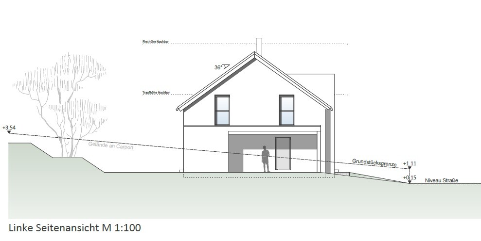

Additional requirements: Neighbor is the plot seller and has several conditions, including house height (not higher than theirs), and the carport must be on the boundary with the other neighbor
Homeowners’ Requirements
Architectural style, roof type, building type: single-family home, gable roof, not too modern
Basement, number of floors: no basement, 1.5 floors
Number of occupants, age: currently 2, both around 30, planning for 2 children
Space requirements on ground floor: living/dining/kitchen, utility room, office, guest WC with shower, storage room behind carport as basement substitute
Space requirements on upper floor: 2 children’s rooms, master bedroom, bathroom, possibly storage room
Office use: family or home office? home office
Number of overnight guests per year: negligible
Open or closed layout: open
Traditional or modern construction style: rather traditional
Open kitchen, kitchen island: open yes, possibly kitchen island, currently a G-shape is planned
Number of dining seats: 6
Fireplace: undecided, leaning towards yes
Music/stereo wall: no
Garage, carport: double carport
Kitchen garden, greenhouse: not planned
Other wishes/features/daily routine, also reasons why some things should or should not be included
Planner: partner architect of the construction company

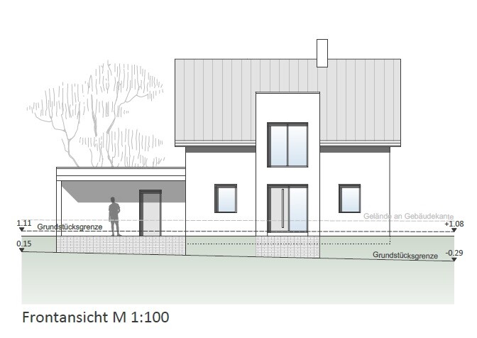

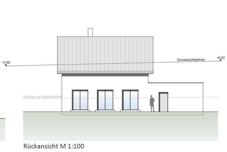

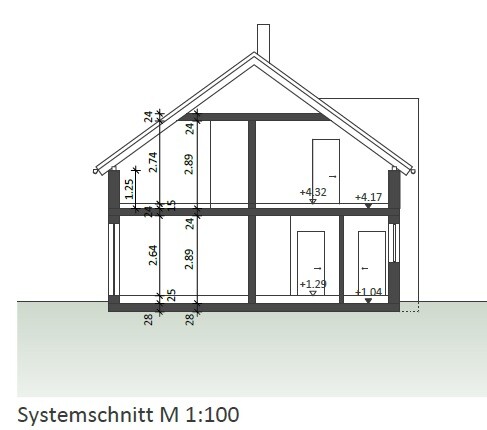

What do you like most? Why? open living-dining area with lots of glass and views into the large garden, dormer at front greatly enhances the house and should flood it with light, current room layout
What do you dislike? Why? straight staircase and resulting long hallway both on ground and upper floor. Unfortunately, the architect insists that with this house width another staircase design is hardly possible without removing the office.
Estimated price according to architect/planner: €360,000 including incidental building costs, technical systems, etc., but excluding kitchen
Personal price limit for house including fittings: €380,000
Preferred heating system: ground-source heat pump
If you had to give up on some details/extras
-that you could do without: fireplace, straight staircase
-that you could not give up: office, basement substitute
Why has the design ended up as it is now? The architect tried to meet our desired room program and the neighbor’s restrictions
Which wishes were implemented by the architect? door from carport to utility room, office, shower in guest WC, open living-dining area with lots of glass
What do you consider especially good or bad about it? In my opinion, the straight single-flight staircase takes up a lot of space; the requirement from the plot seller (neighbor to east side) makes natural light inside difficult — hence the dormer with open hallway in the living-dining area to bring more light into the house
I am now hoping for some suggestions on how we could get more out of the current floor plan while keeping the same room layout. I assume the simplest way would be a different staircase design.
Please excuse me if I have not filled out all questions correctly for the floor plan discussion.

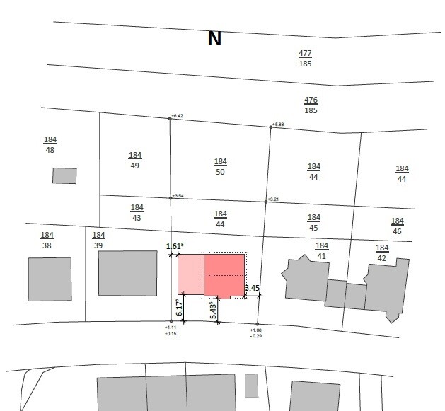

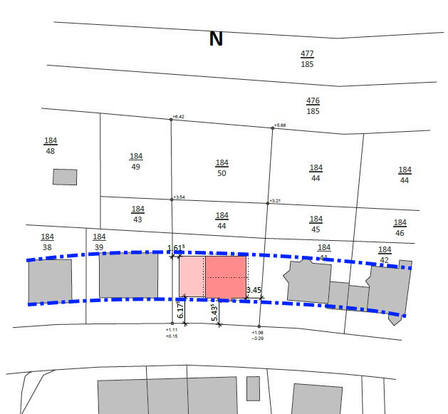

11ant17 Apr 2020 14:24
Escroda schrieb:
He means: a clear case of de facto building boundaries.
My skepticism was related to the focus on the land parcels – I would rather derive de facto building boundaries from the edges or depths of the buildings (?)
E
Escroda
17 Apr 2020 18:09
My skepticism was related to the focus on the land parcels – I would rather derive an actual building boundary from the edges or depths of the buildings (?)
In the end, it comes down to the same thing here:
Parcel site plan with red, central building; blue line along the street; surrounding houses.
The actual building boundaries only allow construction on the street-facing land parcel.
