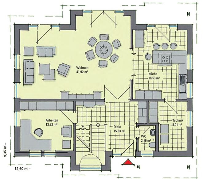

after reading a bit here, I would now like to share our current floor plan. We are still quite early in the process... but since we now have a plot of land in sight, things might move faster than expected.
We had visited a show home that we absolutely loved. Unfortunately, at 180 m² (1,938 sq ft) it was too large or too expensive for us. The floor plan has since been modified and reduced to 157 m² (1,690 sq ft). Still, there are some difficulties, and I’m concerned it might feel cramped. Especially the upper floor is not ideal. Currently, the bathroom is located in the bay window area, and at 14 m² (150 sq ft) it is quite large. I feel the space could be better used, but how? Should one of the children's rooms be moved there? That might feel unfair... Also, the walk-in closet and storage room are not optimal since both rooms have sloped ceilings. The storage room is intended only for items not needed frequently (Christmas decorations, etc.). The attic can also be used for storage.
Downstairs, I am unsure if the utility room is large enough (it will include the heating system, washing machine/dryer, cleaning supplies, beverages, etc.).
Oh, and the furniture (and sanitary fixtures) shown are just examples from the advisor; we haven’t decided on those yet 😉
Regarding orientation, I’ve only just started researching. Unfortunately, the plot faces north… Tips on this are welcome! At first glance, I wonder if it makes sense to mirror the floor plan (at least on the ground floor) and position the house on the plot so that the entrance is not facing the street but to the right instead.

Here is the floor plan we reviewed and found quite good.
Floor plan of a house with bedrooms, bathroom, hallway, and stairs
Floor plan of a house with living area, kitchen, foyer, and study
I want to emphasize again that we really liked this, but we are by no means saying, "It has to be exactly like this and nothing else." It seems that impression might have arisen... this was only our starting point. Now, with the apparently found plot of land, the planning needs to be reviewed in more detail anyway, which is precisely why we are posting here.
Nothing is set in stone (well, except the double doors leading off the hallway—I simply fell in love with those), and I continue to welcome constructive criticism. Discussions about Brad Pitt and co. unfortunately don’t help me much here. If we weren’t open to changes, we wouldn’t have reached out in the first place.
Thanks to everyone who contributed constructively, especially for the advice regarding orientation, which I found very helpful. We are already busy with the drawings...
