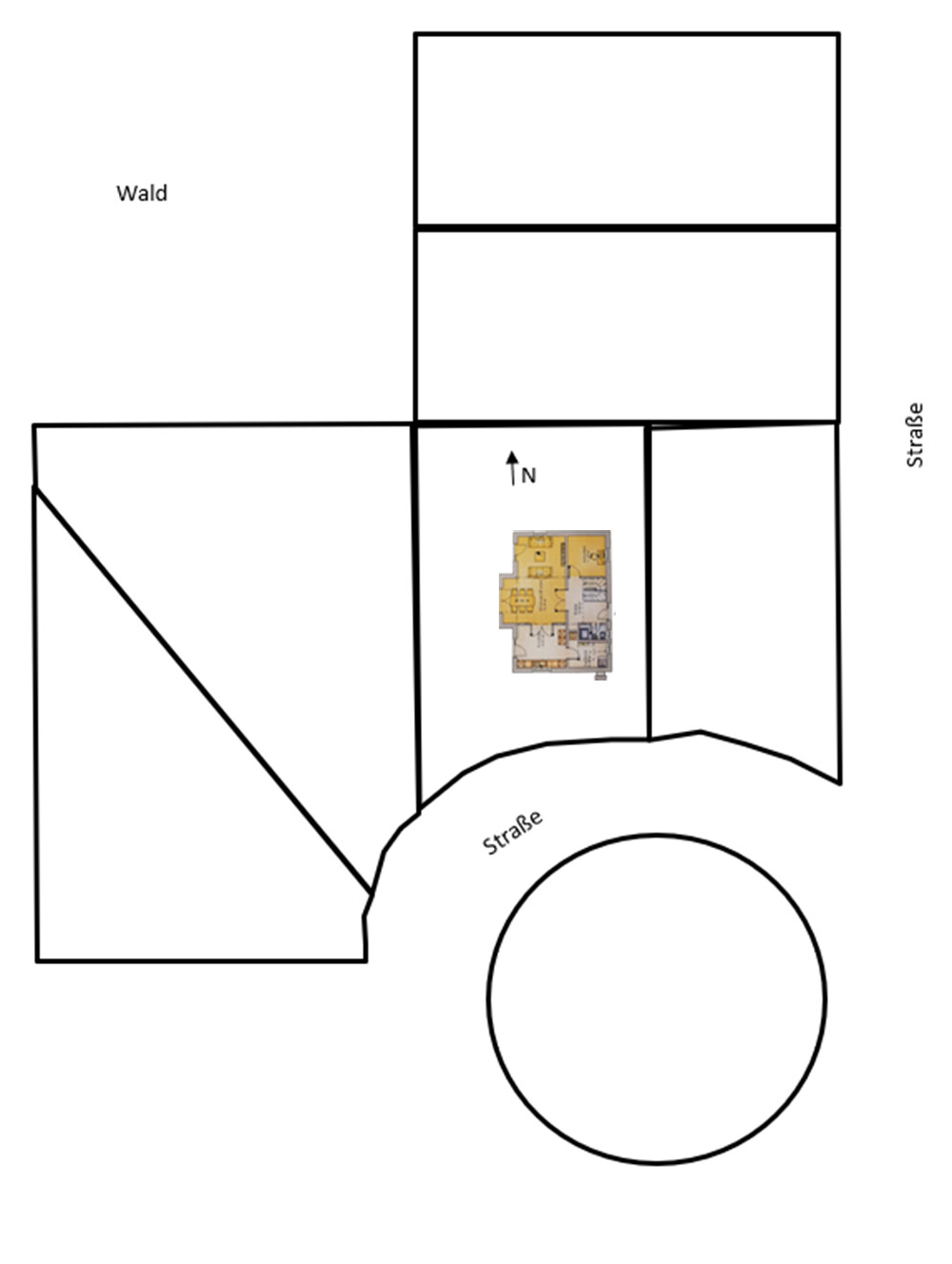

after reading a bit here, I would now like to share our current floor plan. We are still quite early in the process... but since we now have a plot of land in sight, things might move faster than expected.
We had visited a show home that we absolutely loved. Unfortunately, at 180 m² (1,938 sq ft) it was too large or too expensive for us. The floor plan has since been modified and reduced to 157 m² (1,690 sq ft). Still, there are some difficulties, and I’m concerned it might feel cramped. Especially the upper floor is not ideal. Currently, the bathroom is located in the bay window area, and at 14 m² (150 sq ft) it is quite large. I feel the space could be better used, but how? Should one of the children's rooms be moved there? That might feel unfair... Also, the walk-in closet and storage room are not optimal since both rooms have sloped ceilings. The storage room is intended only for items not needed frequently (Christmas decorations, etc.). The attic can also be used for storage.
Downstairs, I am unsure if the utility room is large enough (it will include the heating system, washing machine/dryer, cleaning supplies, beverages, etc.).
Oh, and the furniture (and sanitary fixtures) shown are just examples from the advisor; we haven’t decided on those yet 😉
Regarding orientation, I’ve only just started researching. Unfortunately, the plot faces north… Tips on this are welcome! At first glance, I wonder if it makes sense to mirror the floor plan (at least on the ground floor) and position the house on the plot so that the entrance is not facing the street but to the right instead.

Linimi schrieb:
Because of the wastewater issue? You mean the noise? Yes, it’s annoying when you can hear the toilet flushing at the breakfast table every time.
Linimi schrieb:
I’m still not quite sure how to handle the north-facing orientation... I would simply rotate the house first. Does the development plan say anything about ridge orientation?
Linimi schrieb:
But we are considering extending the knee wall up to 1.80 m (5 ft 11 in). That doesn’t make sense for three reasons: First, having such a high knee wall doesn’t help avoid a full upper floor, since—assuming the maximum allowed heights for the ridge and wall/eaves—you might as well build a full-height top floor with vertical walls. Second, raising the knee wall also moves the junction between the wall and the roof slope higher up, which means you either have to crouch to look out of facade windows or stretch to see through roof windows—or thirdly, you’d have to add dormers. Third, a house styled in the typical "North German" way (with brick veneer, a third gable, etc.) doesn’t look right if you give it a knee wall much taller than about 1 m (3 ft 3 in).
I think I would rotate it like kaho did and then swap the home office with the utility room below, also moving the kitchen to the other side. You will probably need more space in the utility room than in the office. Upstairs, swap the bathroom and bedroom so the plumbing lines up vertically. Exchange the walk-in closet and the storage room, and assign the current storage room to the bedroom by removing the door, creating a small corridor for access to the storage room at the back.
Forget this plan including the changes and choose one that actually fits. That’s quite true. But it could be difficult if you’ve fallen for Brad Pitt and now have to switch spontaneously to Leonardo DiCaprio. 😉
