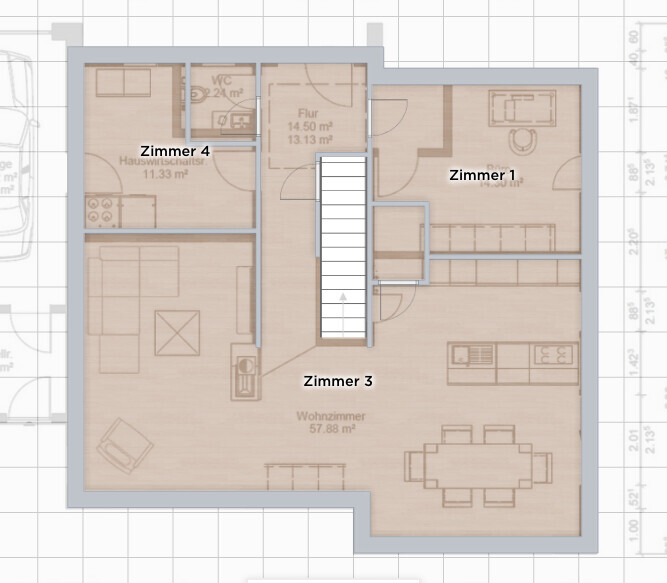

This is what I mean by the ground floor:
Really good ideas.
Having the staircase in the living area like @Alessandro definitely has its charm. I have to admit, I like that very much!
However, in my opinion, the entrance area becomes quite tight, and the tall wall created by the staircase feels overall very oppressive. Also, wouldn’t the void (open space) on the upper floor above the entrance area then be lost, or not?
We will definitely adopt the guest toilet as it is.
DaSch17 schrieb:
However, in my opinion, the entrance area feels quite tight and the tall wallHow about shifting the staircase about 60cm (24 inches) to the right as shown in the plan and moving your central load-bearing wall, meaning the corners at the entrance and dining area? This would remove the staircase from the hallway and make the hallway a bit narrower. Would a 90-degree turn at the start of the staircase be aesthetically acceptable for you? This is just to test what might still be possible. I currently don’t have time myself.
Alessandro6 Oct 2020 11:27I really like it. You have my approval.
Here are two points you might want to consider:
1. In the master bathroom, consider swapping the toilet and shower. If you don’t have a mechanical ventilation system, moisture tends to build up in the shower area, which you can manage better by having the window nearby. I’m very particular about moisture in bathrooms and the potential risk of mold. Also, the toilet is probably used more frequently, so you won’t have to walk around the washbasin every time.
2. I would design the front of the kitchen island (the side facing the dining table) so that coasters, salt and pepper, napkins, etc., are easily accessible without having to walk back into the kitchen all the time. It’s a small detail, but these are items you use several times a day.

Alessandro schrieb:
I really like it. You have my approval Thank you. We still have some time before the building permit / planning permission in IQ 2021, so we can fine-tune a few details. Maybe I will even present the design in the “lion’s den” (pitch contest)...
Alessandro schrieb:
1. In the master bathroom, consider swapping the toilet and shower. If you don’t have a mechanical ventilation system, the humid air tends to build up in the shower area, which you can better ventilate thanks to the proximity to the window. I’m very particular about moisture in bathrooms and the risk of mold. Also, the toilet is probably used more often, so you wouldn’t have to walk around the sink every time. Basically a good idea. The downside is, if you spend longer on the toilet (you know what I mean ), you’re pretty much on display. On the other hand, the toilet would be more private and better screened from view.
Also, the walking distance from the shower would be shorter, so you get less wet…
The partial wall won’t be full height anyway… so moisture could potentially rise over it toward the window.
Alessandro schrieb:
2. I would design the kitchen island side facing the dining area so that coasters, salt and pepper, napkins, etc. are quickly accessible and you don’t have to keep going back into the kitchen. It’s a small detail, but these are things you use multiple times a day. Practical tip. We will take that into account, thank you.
Alessandro6 Oct 2020 11:58Then I would plan to add another window. Or you could install a glass door in the restroom.
