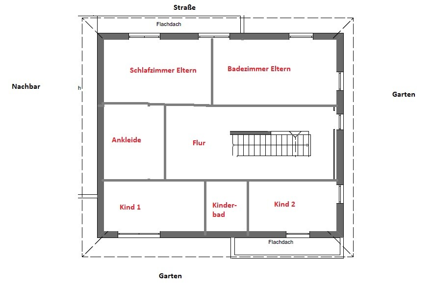

The attic is intended as storage space. A conversion is basically not planned.
I think if we have triplets the first time or twins the second time, we will find a solution (extension or selling). You can’t plan for every eventuality in life...
We definitely wouldn’t need a shower on the ground floor for old age, as the straight staircase is perfect for a stairlift. And honestly: before I can no longer live on the entire upper floor, I’d rather sell and move into our condominium or build a barrier-free bungalow...
The idea with the guest toilet is good and would create a nicer guest bathroom. We had it like that before. We have now changed it to get more storage space in the utility room (utility room on the lower right of the plan). If we rotate the guest toilet, the door to the utility room shifts downward and the storage space is lost.
I had also tried rotating the staircase. It would actually be better downstairs. But the problems then arise especially upstairs. The parents’ and children’s areas are separated by the straight staircase. The separation would no longer be left and right on the plan but bottom and top.
1. Problem: The rooms would become too narrow because the building footprint is 9.80 m (32 feet) deep by 11.60 m (38 feet) wide.
2. Problem: The garden sides (bottom and left on the plan) would be used suboptimally. One area would then be in the northeast (street side) and one in the southwest (garden side). As it is currently divided upstairs, the children’s rooms and the bedroom all have garden views.
3. Problem: A part of the nice southwest side would then be used as a hallway.
I sketched the rotated staircase some time ago but found the result significantly worse than the current layout.

No, since there’s not enough ceiling height, emergency escape windows, and no living area allowed, the ceiling will likely be finished so that no comfortable living space can be created there.
My tip:
I would rotate the layout of the guest toilet, then place the washbasin on the left side of the plan and the toilet under the window. Just a suggestion for more refinement, if possible.
Then: we have a similarly sized office (basically a similar floor plan).
I find the layout a bit inconvenient with the door in the “narrower part”… I would rotate the staircase, make the storage room a cloakroom, have a rectangular office, and from the kitchen area on the left side of the plan a small storage space only.
Upstairs, I think the double-through-bedroom situation in the master bedroom is doubly suboptimal… that can be improved anyway by rotating the staircase. The children’s rooms would shift somewhat, but I think that would work. But of course, it doesn’t have to be done… just a suggestion.
My wife insisted on an en-suite bathroom without a separate entrance and basically a walk-in closet, not a proper dressing room as a walkthrough. That’s how it is arranged in our condominium now as well. In theory, it would be possible to arrange the dressing room between the bathroom and bedroom and have a door to the hallway from there. But then the wall closet in the hallway would be lost. Regardless, my wife absolutely does not want the arrangement bedroom -> dressing room -> bathroom. In my opinion, the current layout of the master area also makes optimal use of the upper floor space.

DaSch17 schrieb:
I sketched the twisted staircase some time ago but found the result clearly worse than the current layout.I quickly sketched it again just now.
- The open space is removed.
- The hallway becomes noticeably larger.
- The rooms are overall smaller and more narrow, especially the kids’ bedrooms.
Did you imagine it roughly like this?
I have no further suggestions regarding the floor plans because, in my opinion, although the design is not yet at the stage where I would immediately want to buy the house from you, it is definitely at the stage where it appears ready for construction as a not-my-house (meaning that any further "improvements" would actually just be "changes to suit my taste").
In light of the Villa Hotzenplotz, it should also be understandable that I am satisfied and reassured knowing that someone has sufficiently avoided creating a collection of complicated details. That there is one extra fireplace compared to my own house — who cares?
No, terrible — and I think what was meant was a reversal (rotation by 180 degrees, not 90 degrees).

DaSch17 schrieb:
Did you roughly imagine it like this?

The problems mainly arise on the upper floor. The parents’ and children’s areas are separated by a straight staircase. The separation would then no longer be left and right on the plan, but bottom and top on the plan. Yes, I think there are problems too. That requires a lot of careful thinking again. I find rotating the ground floor not only better for the rooms but also a refinement that only a few houses can afford. It fits well here.
DaSch17 schrieb:
Was this roughly what you had in mind? No, not at all. Too much hallway.
