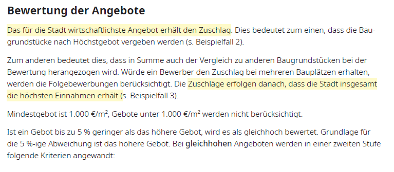

kbt09 schrieb:
Then the question doesn’t even arise. I can buy lots 3 - 10 individually, so the decision is a semi-detached house, emphasis on HALF, for roughly 250 m² (about 2,700 sq ft) per plot and the neighboring plot.
I understand the process somewhat differently.
The brochure states that the allocation will be made to the most economically advantageous offer, essentially based on the highest bid, complemented by the 5% rule and criteria like children or local resident preference.
From my point of view, the decisive factor is the city’s overall consideration, which applicant or which combination of bids yields the highest total proceeds.
Example:
If bidder A offers 1,200 €/m² (about 111 $/sq ft) on plot 3 and bidder B offers 1,800 €/m² (about 166 $/sq ft) on plot 4, while bidder C offers 1,700 €/m² (about 157 $/sq ft) for the combined plots 3+4, then awarding the plots individually would likely be more financially attractive for the city.
Therefore, I currently assume that combinations like 3+4 will not automatically be favored, but have to compete against individual bids.
Additionally, the concept already defines which semi-detached houses belong together, so the assignment is predetermined structurally and not controlled by the timing of a building permit application.

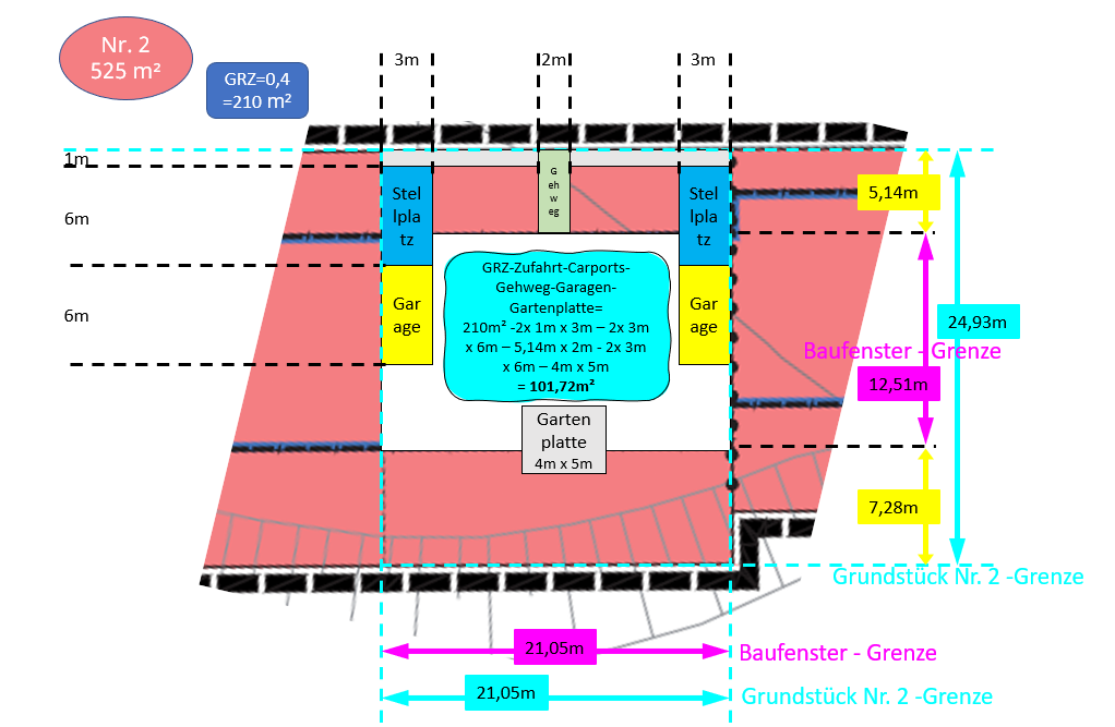

If you want to comply with the floor area ratio, you look in 2D at how a house design fits in the building envelope and then calculate. But anyway,
it’s easier to measure on a 2D drawing.
I didn’t do the 2D step properly for plots 3+4 initially. Now I have carefully calculated everything in 2D, including all areas like garages, carports, walkways, garden slabs, etc.
For plot number 2 with 525 m² (about 5,650 sq ft) and a floor area ratio of 0.4, i.e., 210 m² (about 2,260 sq ft), I currently get:
Total ancillary areas: approx. 108 m² (about 1,160 sq ft)
Remaining for house footprint: approx. 102 m² (about 1,100 sq ft)
It’s clear my original plan for about 140 to 160 m² (about 1,500 to 1,700 sq ft) per floor won’t fit on this plot.
Attached is my current sketch, without architectural details, just focused on space planning.
For me, this calculation shows especially that parking and access areas take up much more space than I initially thought, and that is currently the biggest opportunity for optimization.
Next, I plan to:
Consolidate parking instead of mirroring it on left and right
Further reduce walkways and ancillary areas
Simultaneously, calculate the larger plots 1 and 5+6
If you have specific ideas on where space can be gained realistically, without wishful thinking, please share.

Your bid example has nothing to do with the development consequences.
Plots 3 and 4 ==> one semi-detached house per plot, even if plots 3 and 4 have the same owner, I see this as possibly two semi-detached houses or one single-family house on the entire area. However, with semi-detached houses, the building footprints are clearly separated, which is not the case with a two-family house, which is what your design is.
If plots 3 and 4 are bought together ==> a single-family house is possible.
I don't see where the possibility of your type of ownership division comes from, neither in version 3+4 (Post 9) nor in version 2 (Post 17). I still define "single-family house" as a house with one dwelling unit. It might be worth clarifying whether your design can be realized on plots suitable for single-family houses.
