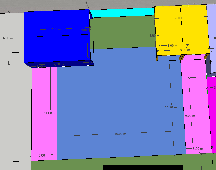

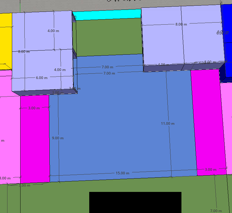

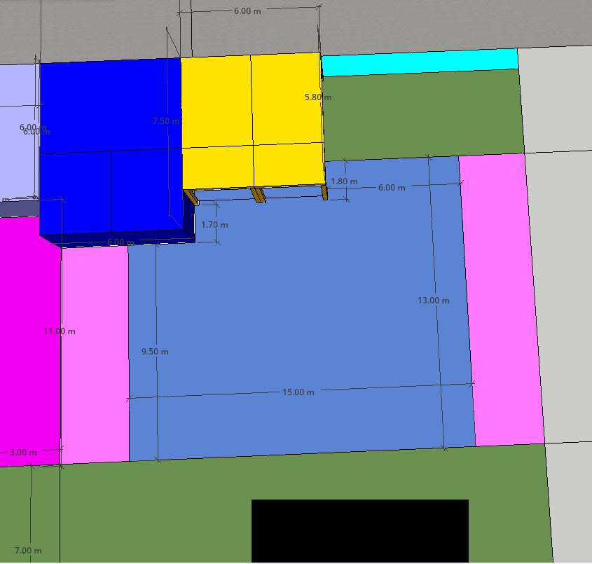

hanghaus202313 May 2026 14:45My suggestion is based on dividing the plot. Otherwise, it won’t work. Now you are looking for a partner for a semi-detached house.
hanghaus2023 schrieb:
Is there a development plan? YES
mmyellow schrieb:
https://www.ludwigsburg.de/site/Ludwigsburg-Internet-2020/get/params_E-1592578321/25070941/Exposee%20Sonnenberg%20SW_Anlage_2_Textteil_Festsetzungen%20B-Plan.pdf Point 6:
Parking spaces, covered parking spaces (carports), or garages are permitted not only within the designated building areas, but also within the front garden areas facing traffic areas and the side setback zones up to the height of the rear building boundary (i.e., the boundary facing away from the access road). Garages must be set back at least 1.0 m (3.3 ft) from the boundary to public areas (traffic zones, sidewalks, pedestrian paths, green areas). Point 4
Secondary building elements such as balconies, bay windows, or projections up to 5 m (16 ft) in length and 1.50 m (5 ft) in depth may extend beyond the established building setback line, provided their total length does not exceed 50% of the building length. The applicable setback regulations according to the state building code remain unaffected by this rule. Your suggestion to place the carports instead of garages directly next to the house would almost work. Thanks for thinking about it.
However, I believe these count towards the floor area ratio of 0.4, so:
15 m x 11 m (main building) + 3 m x 5.5 m (CP1) + 3 m x 5.5 m (CP2) + 3 m x 2 m (setback area 1) + 3 m x 2 m (setback area 2) = 210 m² (2260 sq ft)
525 m² (5651 sq ft) * 0.4 = 210 m² (2260 sq ft)
That means you already reach the limit without paths and without the garden slab.
But the idea is good, because in addition to the 2 official parking spaces you would get 2 more spaces in front of the carport,
and the building footprint at 165 m² (1776 sq ft) comes close to the maximum of 195 m² (2098 sq ft).
