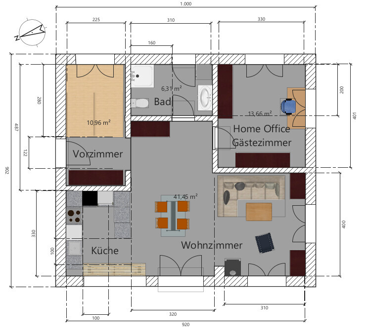

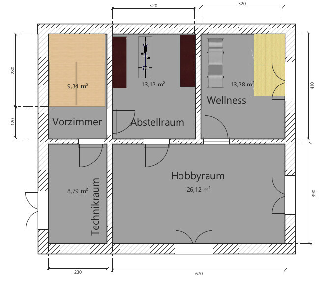

Hello dear community,
we are planning to build a single-family house and have already thought further ahead. We would like to be able to divide our house into two separate living units if needed. This way, an older child could move into the apartment above while we continue living on the ground floor, or we could rent out the upper unit if necessary. The ground floor should be accessible without barriers, with a shower in the bathroom. I would really appreciate your opinions on the floor plan I have drawn and any suggestions for improvement. Here is the floor plan:
Floor plan of a house with five rooms (9.34; 8.79; 13.12; 13.28; 26.12 m² (100; 95; 141; 143; 281 sq ft)), doors and furniture.
Floor plan of a house with living room, dining area, bathroom, bedroom and workspace.
Floor plan of a house: living room with sofa, dining area, kitchen, bedroom, bathroom, doors.

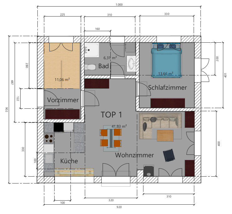

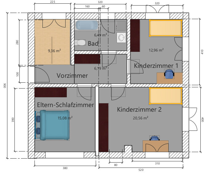

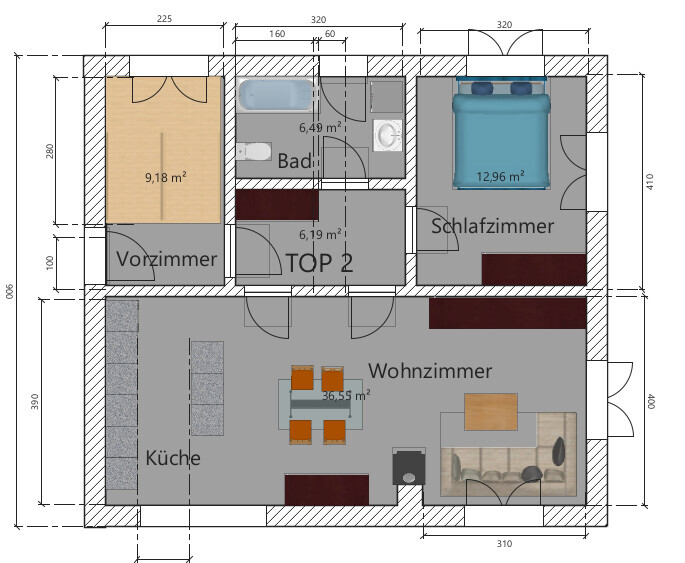

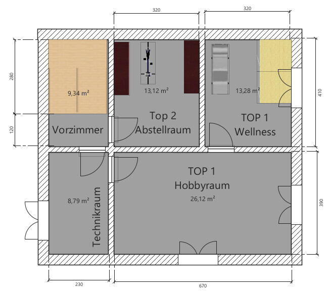

See my note in the crosspost:
Here again, separated between single-family house and two-family house, I hope this helps to better understand the floor plan. In the two-family house version, the entrance hall in UNIT 2 does not receive natural light from outside; this is correct but not ideal. However, on the first floor there is a door that brings light into the entrance hall. Are the costs due to the preparation for a two-family house so high that it is not worthwhile? From my perspective, the main difference is only that the kitchen connections need to be extended upwards. Having a second electrical circuit as well as a second heating circuit should not be an issue, since this also exists in single-family houses. I just recall comments from several relatives saying that their house became too large for them without children and involved too much maintenance, which is why I came up with this idea. Therefore, I don’t find it that “unreasonable.”
Floor plan of a house with entrance hall, bathroom, master bedroom and two children’s rooms

Floor plan of a house with entrance hall, storage room, wellness area, utility room, and hobby room.
Floor plan of an apartment with entrance hall, bathroom, UNIT 2, bedroom, living room, and kitchen.
Floor plan of an apartment with kitchen, entrance hall, living room, bathroom and bedroom (UNIT 1).
Floor plan: entrance hall, utility room, UNIT 1 hobby room, UNIT 2 storage room, UNIT 1 wellness area.

Your considerations are understandable, as well as the idea of having your own staircase.
From my point of view, the house that results neither architecturally supports the current nor a future living situation well. If you are thinking of a two-family house, you need two floor plans that each work independently. That is not the case here. In addition, the daily routes within a single-family house tend to be inconveniently long in practice. The children living "remotely" in the "second apartment" would have been suboptimal for my family, especially up to their teenage years.
In my opinion, your plot and budget do not allow you to consistently follow through with this concept. I would not build something "half-baked."

That sounds nice with the idea of “separating” them, but depending on the location of the rooms—and especially with a concrete slab in between—you will hear your housemates, sometimes even more clearly if the conditions aren’t right. You don’t have a very large plot, and now several parties are supposed to benefit from it somehow? So the mythical “jack of all trades” lives on outside as well?
These thoughts are not foreign to me in principle, but back then my parents lived there for a long time in the one apartment. I’m building a house for myself and, for now, with the version “nice and maximum comfort” (really personalized comfort). Trying to plan ahead for the future like that doesn’t seem very practical to me, and actually turns out more expensive than you might calculate here.
Already now it’s clear that for cost reasons you will have to switch to a “simpler” version of the controlled ventilation system, and the same will happen in other equally important areas where the budget bites. Why build for a naturally entirely uncertain future but pay less attention to current needs?
Bauherr8899 schrieb:
Ideally, the kitchen should be separable if needed, for example with a sliding door.
Why? What situation would you like to accommodate with that? I had exactly that once. The door(s) were expensive and never used. That was usually planned back when extractor hoods were missing or weak, or so the working wife wouldn’t be seen. You value having visitors and spending time with them—so why do something like that?

If you want to create the possibility of two separate living units, you can plan a hallway on the upper floor to allow for a future separate entrance. This gives you more flexibility to design a layout that better meets current needs.
Regarding the electrical system:
The same applies to the electrical setup. Install separate circuits in a large distribution panel, a good sub-panel upstairs, and leave space for future needs such as a second meter or three-phase power for a second kitchen.
Regarding heating:
Install a heating system designed for a single-family home. If you later decide to rent out part of the property, the billing can still be managed and justified commercially. It’s quite likely the heating system will need to be replaced by the time you want two living units, so careful planning of pipework now will help.
Regarding installations:
Empty conduits are inexpensive. Install pipes in advance for water, wastewater, and electricity where they could be needed later in the upper unit.
Regarding static structure:
Plan so you already know which walls could be removed in the future.
And:
Build primarily for the needs you and your family currently have. The rest can be adjusted when the time comes. With these measures, you will be well prepared without significant extra costs.
