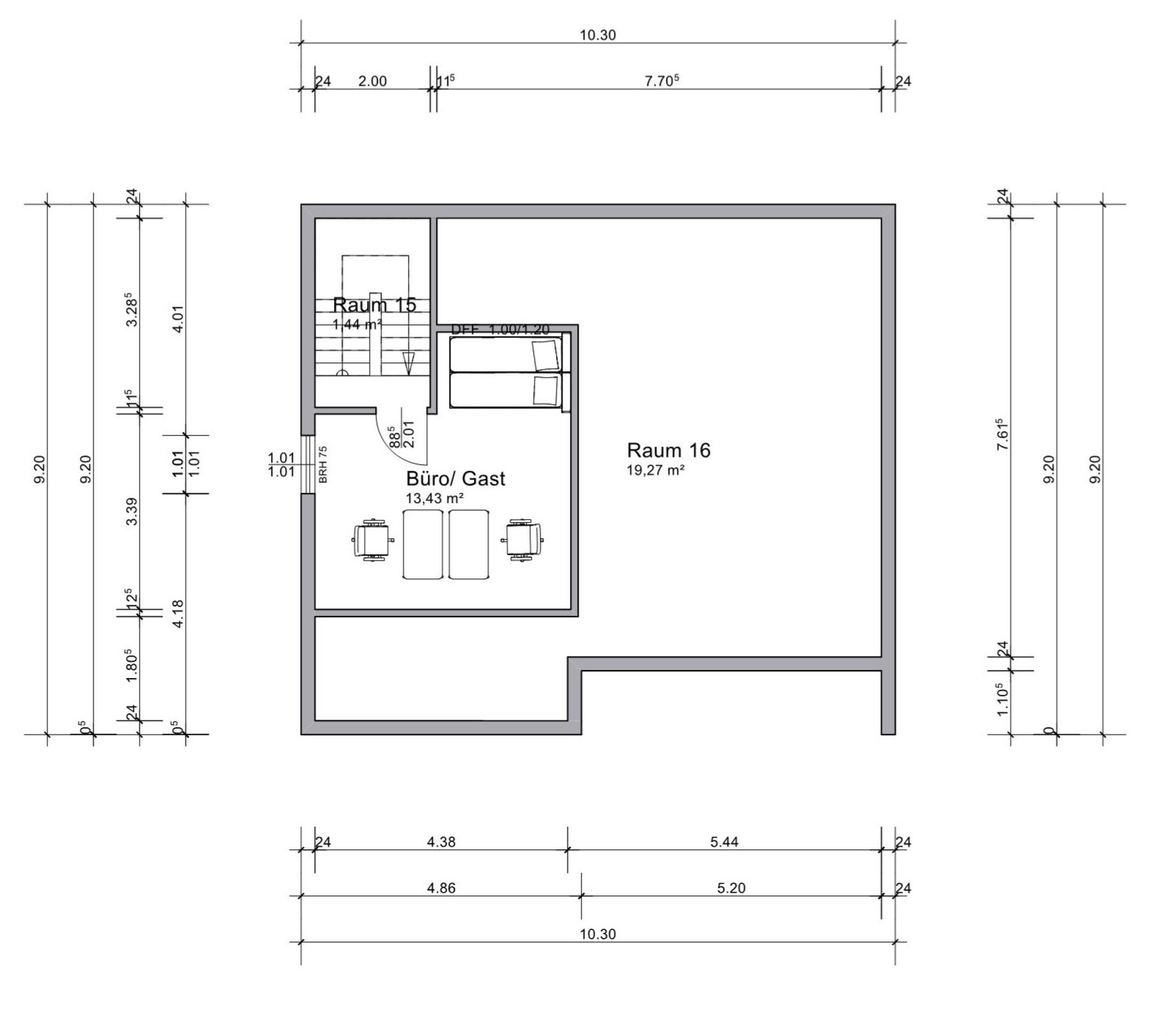

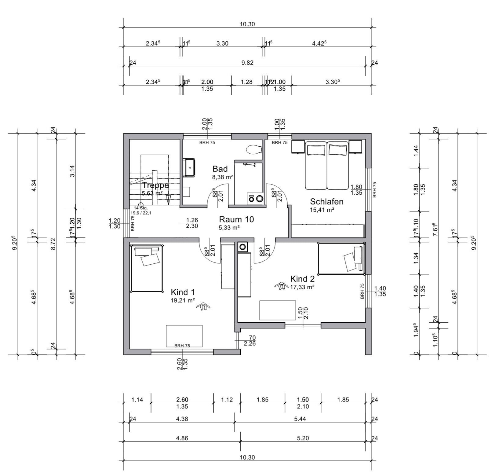

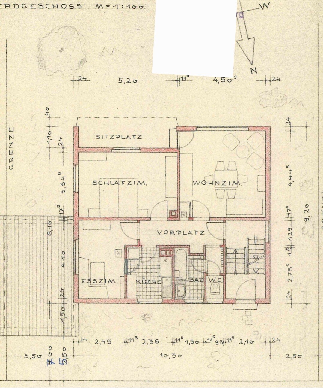

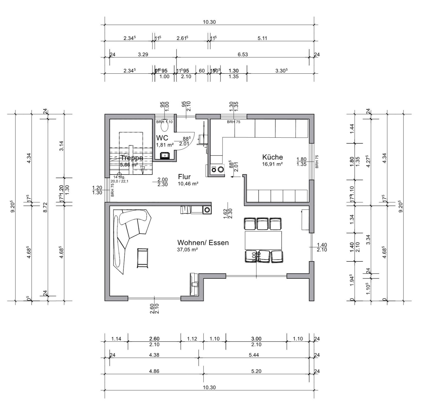

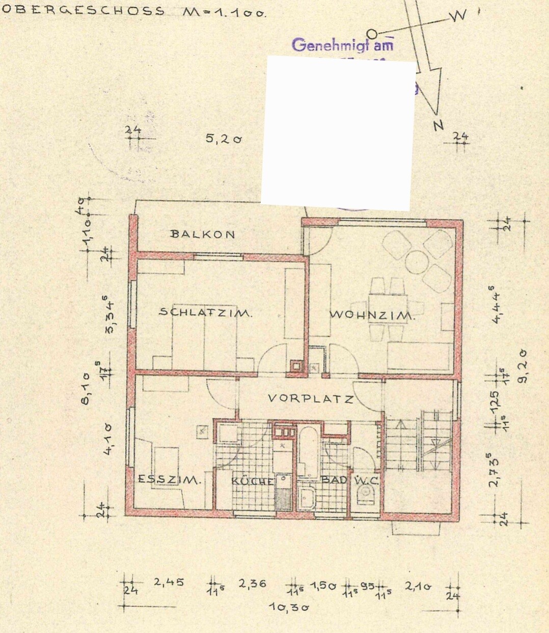

Does the two-family house character get lost by opening the staircase area on the ground floor with a glass door/front? How can the hallway, guest toilet, and kitchen area on the ground floor be optimally designed?

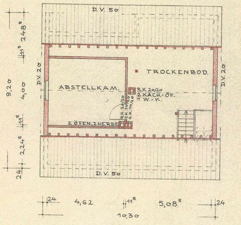

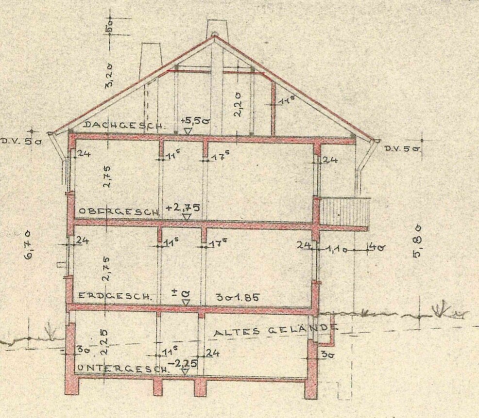

Attached are the original construction plans showing the current condition and the plans/ideas we have created so far.

Sorry, this is my first post here. Should I upload all images in better quality? What is difficult to read – the original plans or our design?

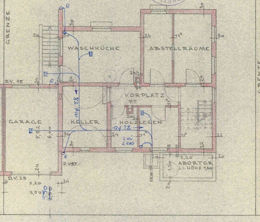

The house entrance is located at landing level between the basement and ground floor, so it is not shown in the drawings. Thanks for pointing that out. We had not planned any relocation.

hanghaus20233 Feb 2023 13:59In my opinion, this is not a renovation costing 500k.
Ground floor: A structural engineer should definitely propose a solution for how the wall between the living room and bedroom can be removed. The same applies to the kitchen wall. The stairwell is designed as an entrance vestibule, so I wouldn’t remove the door. The entrance will probably remain about half-height.
Attic floor: I wouldn’t change the bathroom much, just replace the bathtub with a shower. Having the toilet separate is a good solution. The wall between the former kitchen and the bedroom should not be much of a problem in my opinion. Your structural engineer will tell you how to handle it.
If you are already so experienced with the planning, then do it properly. Mark the changes in the plan: demolition in yellow and new construction in red.
There’s no need to rotate all your plans. Please make clear screenshots so the details are readable.

letosaspe3 Feb 2023 14:45Thank you for taking the time to review everything despite the circumstances!
A structural engineer will be coming in about two weeks. We have tentatively planned that the 11.5 cm (5 inch) walls can be removed, if necessary with a beam, while the 17.5 cm (7 inch) wall is more complicated to open and any openings there should preferably be kept narrow.
The idea for the entrance to the ground floor was to widen the passage and possibly close it off with a glass door or glass panel. This would serve both to provide thermal separation and, above all, to visually soften the character of the two-family house by using the glass element.
We are mainly unsure how to arrange the wardrobe, restroom, and kitchen in a practical way, and where to create accesses, openings, or doors.
I will explore the tool to see how I can color the walls red and yellow, then I will try to create an optimized all-in-one plan.
