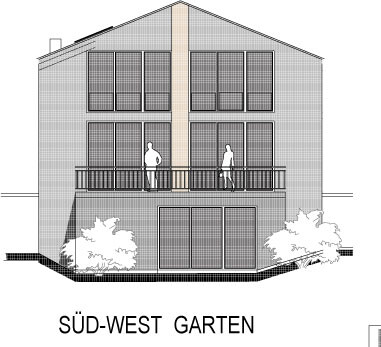

• The house is located on a dyke. The garden lies lower, facing southwest.

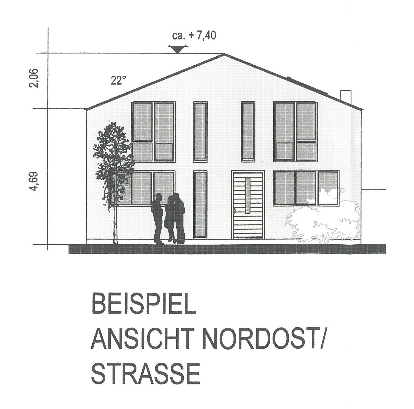

• On the street side, northeast, the kitchen, bathroom, and entrance should be located. From here there is a view of the land in front of the dyke and the river.
• Dense urban development, the neighbors all have two floors with pitched roofs.

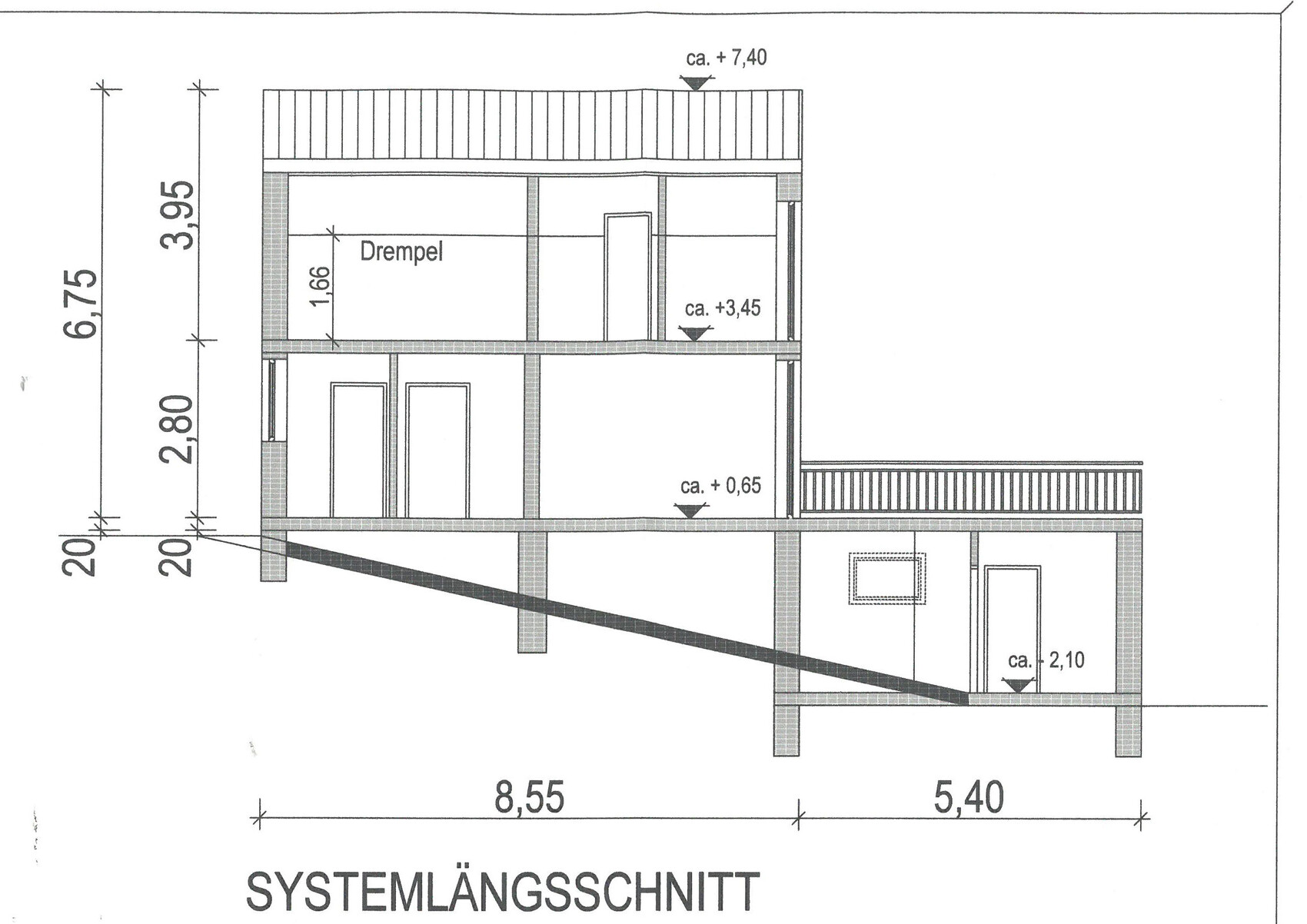

Slope:
Yes, or rather dyke. Towards the garden it drops about one floor height.

I would prefer the gable facing the street because this allows for more windows.

If the budget allows, a partial basement in the garden, which is at a lower level.

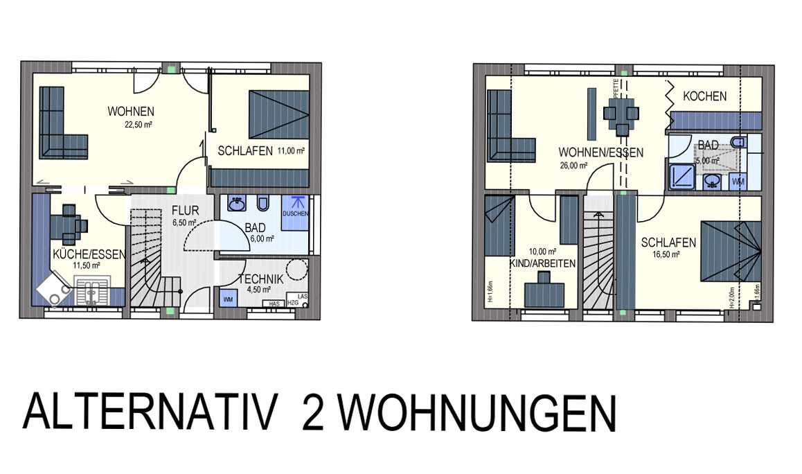

Optional rental should be possible.

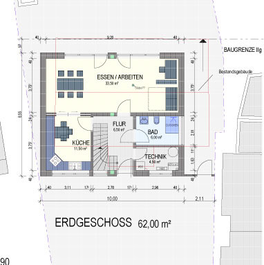

Ground floor: kitchen, bathroom, and enough space to live on one level if necessary.

Possibly a roof terrace on the partial basement, if there will be one.

Comes from my architect, who tries to plan economically in my interests.
[B]Positive aspects:
• Walls stacked vertically (apparently saves money)
• Kitchen with views of the street and river
• Living room on the upper floor with both southwest garden view and northeast view to the river and trees.

I don’t see a separate staircase. Would a prospective tenant have to walk through your hallway, or how is that planned? Hmm, I’m asking myself the same question.

Staircase is designed so that, if necessary, the wall between the utility room and the bathroom can be extended toward the hallway and equipped with a second front door, allowing the staircase to be shared.
Gable was not an issue since houses in the street were built in a varied layout anyway. The "Dung" path on the side was more of a concern, but I have obtained approval for it.

I think a shared staircase is nonsense and wouldn’t spend a cent on it.
