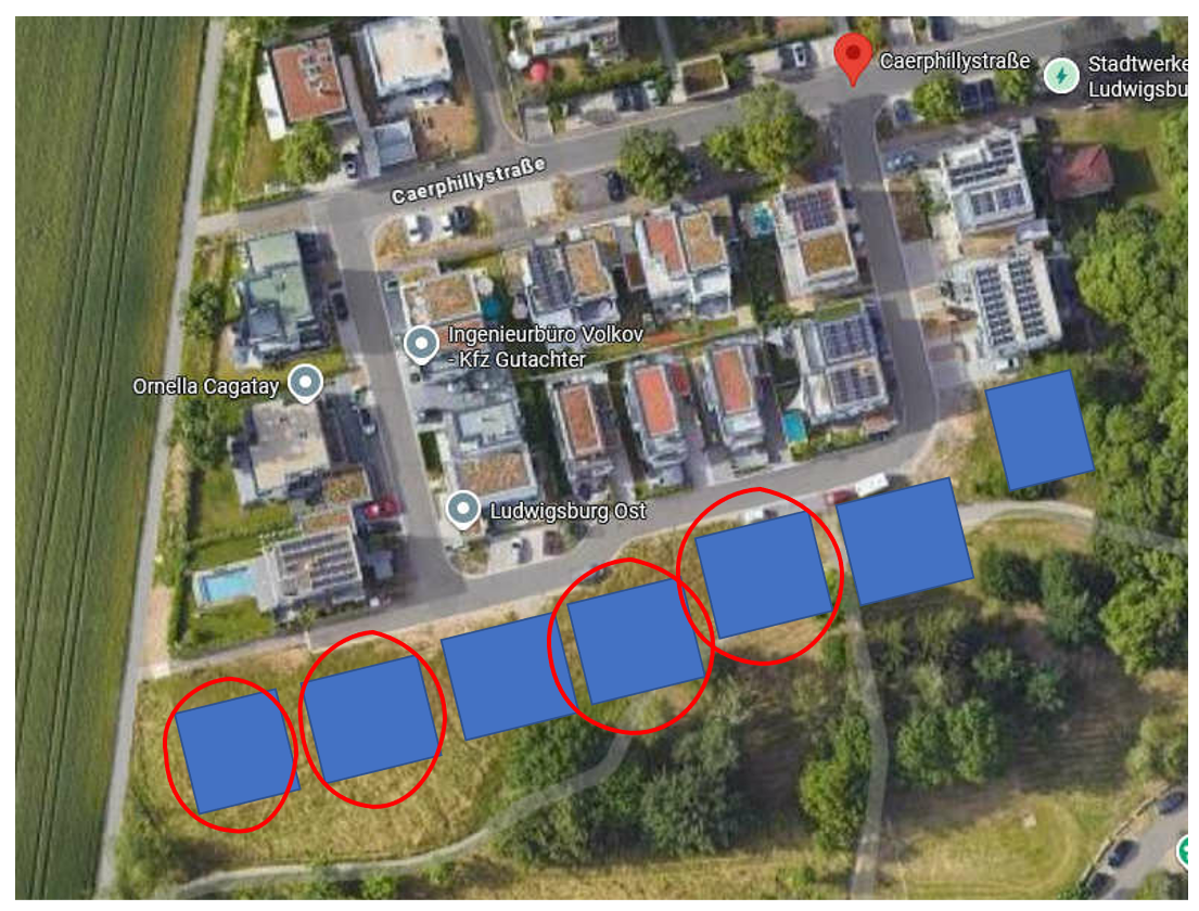

We are currently at the beginning of a construction project in Ludwigsburg (Sonnenberg South-West development area) and would like to gather early feedback on the choice of plot and the overall concept.
The plots are allocated through an application process (up to 3 preferences possible, selection not guaranteed). We currently have 4 possible plots shortlisted and need to prioritize them.
Plot size: approx. 440 – 525 m² (4730 – 5650 sq ft)
Slope: no (relatively flat)
Site coverage ratio: 0.4
Building type: detached construction, single-family or semi-detached houses allowed
Roof style: flat roof (max. 3° pitch, specified)
Maximum height: approx. 9 m (30 ft) to parapet
Special conditions:
• Green roof required
• Photovoltaic system planned / can be integrated effectively
• No underground garage allowed

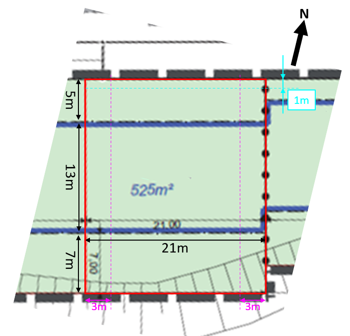

The land-use plan „Sonnenberg South-West, 2nd Development Phase“ specifies a floor area ratio of 0.4. This means: main structures include terrace areas and a garage attached to the building (main floor area ratio 0.4). Ancillary structures are allowed up to 50 % (+0.2 of the main floor area ratio), so the total floor area ratio can be up to 0.6.
Matrose HeinBlöd checking in again on parking space surface scrubbing ?
Regardless of whether I get the plot or not:
This topic has completely captivated me by now and has already cost me several sleepless nights.
I’m currently trying to find the sweet spot between:
  • 4 garages
or
  • 2 garages + 2 carports
… and above all, the best arrangement for them.
That’s why I simplified plot 2 as follows:
  • blue rectangle = building envelope approx. 13 × 21 m (43 × 69 ft)
  • pink = 3 m (10 ft) setback on each side
  • turquoise = 1 m (3 ft) setback from the street
  • about 5 m (16 ft) to the street at the top
  • about 7 m (23 ft) to the garden at the bottom
This leaves roughly a 13 × 15 m (43 × 49 ft) usable main building footprint.
Right now, I’m trying to understand the best logical layout for parking/garages.
My goal is to find the sweet spot that allows for the largest, yet sensibly usable rectangular footprint for the house.
Floor area ratio:
  • Main structures 0.4 = 210 m² (2,260 sq ft)
  • Ancillary structures additional 0.2 = 105 m² (1,130 sq ft)
  • Total theoretically 0.6 = 315 m² (3,390 sq ft)
The big question now is:
What makes more sense?
  • Counting “smaller” carports attached to the house?
  • Or garages?
  • Or keeping as much as possible freestanding?
Attaching everything completely to the main building seems rather difficult.
Then there’s the topic of the garden slab foundation.
I’m ignoring the walkways for simplicity for now.
I’ve already tried several variants, including some that probably violate regulations, just to better understand the limits.
Current boundary conditions:
  • Boundary building max. 9 m (30 ft) on each side
  • A total max. of 15 m (49 ft) along all boundaries combined
  • Height max. 3 m (10 ft)
  • Minimum 1 m (3 ft) setback from the street
Also, a garage doesn’t necessarily have to be 3 × 6 m (10 × 20 ft).
Maybe sizes like:
  • 4 × 6 m (13 × 20 ft)
  • 3 × 7.5 m (10 × 25 ft)
  • 3 × 9 m (10 × 30 ft)
  • or even 4 × 7.5 m (13 × 25 ft)
make more sense.
I also tried the option of a garage parallel to the street. However, nothing appealing came out of that because the space needed in front for maneuvering and parking takes up surprisingly much room.
And before we ignore the elephant in the room ?
Yes, I am aware that economically this is probably pure pipe dream and you could live more comfortably somewhere else for a lot less money.
But that’s not what this is about right now.
For me, this is currently:
  • a thought experiment
  • a feasibility analysis
  • and honestly, it has even become a small hobby project ?
So no need to save me or point out that this probably doesn’t make financial sense. I know that.
I’m really interested in practical ideas.
Current questions:
4 garages?
Or 2 garages + 2 carports?
Garages side by side or staggered?
Directly attached to the house or deliberately freestanding?
Also, a garage doesn’t necessarily have to be 3 × 6 m (10 × 20 ft), but can also be 4 × 6 m (13 × 20 ft), or 3 × 7.5 m (10 × 25 ft), or both 4 × 7.5 m (13 × 25 ft).
And before someone pulls out the tall tales compass again ?
I’m neither an architect nor do I claim to be one. But these are exactly the kinds of topics I enjoy:
Understanding the constraints, researching myself, trying out different variants and attempting to optimize the puzzle reasonably.
I would really appreciate practical suggestions on how you would arrange a plot like this sensibly.
Feel free to just draw rectangles on my sketch:
blue = garage
orange = carport
gray = driveway ?

Is there a development plan? In Bavaria, you are allowed to build with the CP up to 3 m (10 feet) from the street, unless the development plan or a local regulation states otherwise.
A semi-detached house measuring 7.5 * 11 m (25 * 36 feet) should be livable. How tall is it allowed to be?
