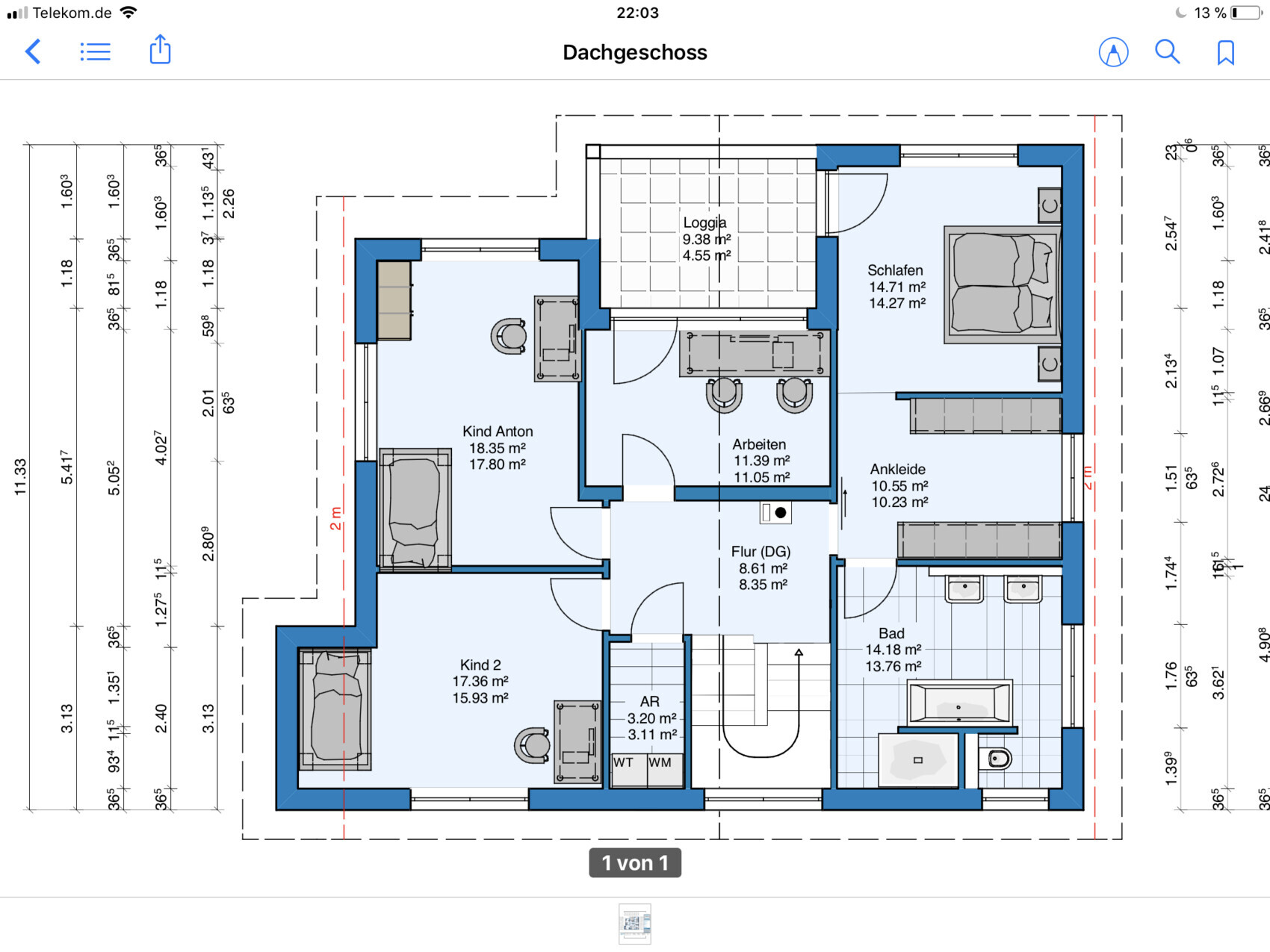

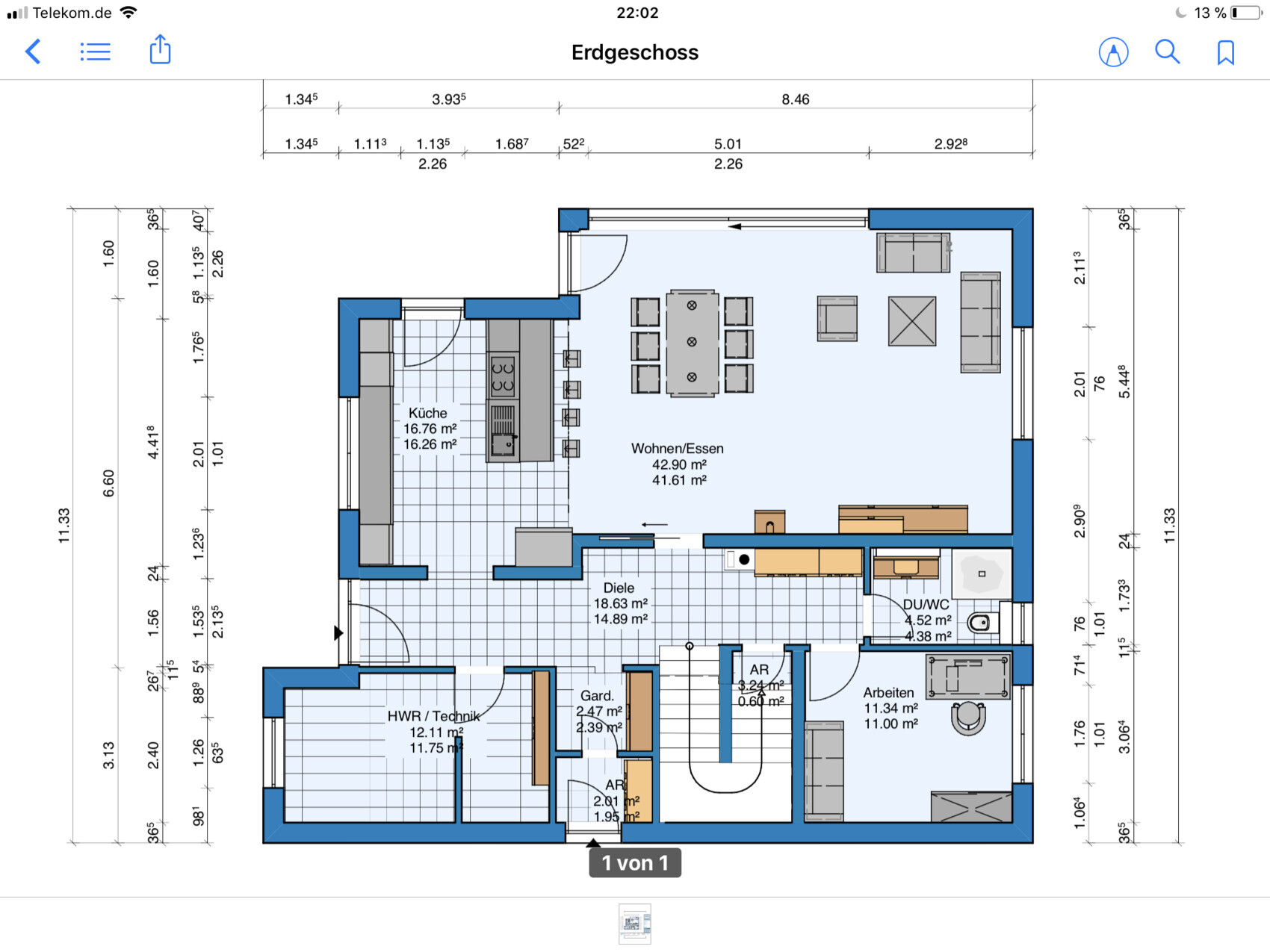

toxicmolotof20 Nov 2017 13:48In the office on the upper floor, the wall on the left side of the plan is difficult to use effectively.
Consider what type of cabinet would fit there (pay attention to the depth!) and, if necessary, move the door slightly to the right and make the window a bit narrower (on both sides). Maybe an additional 20cm (8 inches) on each side would be enough.
This way, you gain wall space suitable for a cabinet.
A side note: Some home insurance providers charge a surcharge if the washing machine is not located on the lowest floor.
Also, on the ground floor plan, the door to the guest room is missing. But it’s clear where it should/has to be.
Oh, by the way: I’m referring to dollhouse furniture here. The illustrated two-seater is at most 1.50 meters (5 feet) wide. Everything seems spacious because of the undersized furniture drawings, even though it’s not. Therefore, don’t waste floor space below on long corridors and oversized secondary rooms. If necessary, consider opening part of the hallway to the dining area.

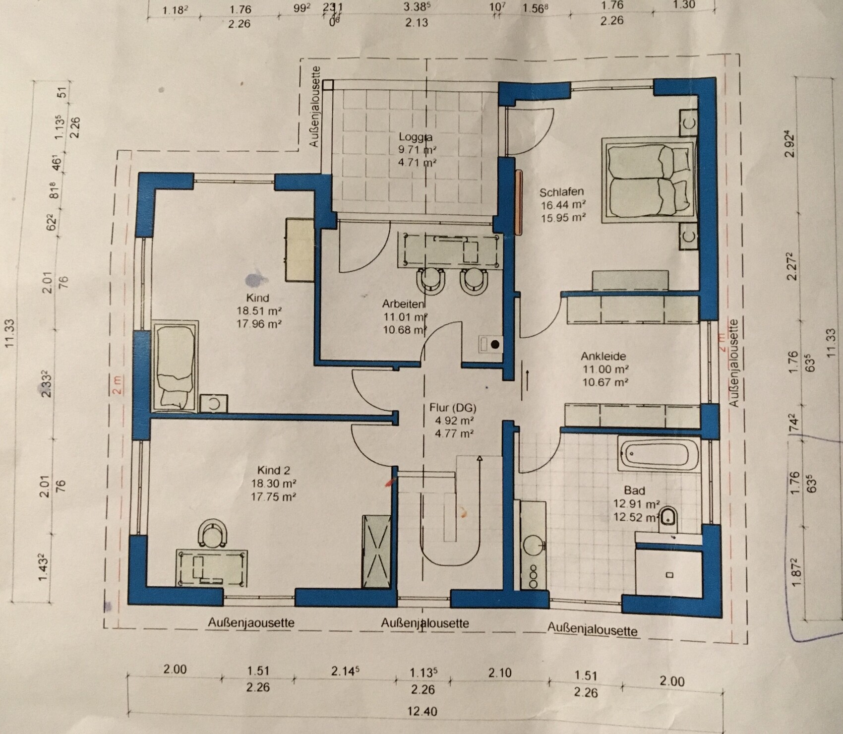

halloo123421 Nov 2017 00:04Hello,
the floor plan itself is well designed, but the situation with the children's bathroom would bother me a lot. When your child gets older, they probably won’t want to have to go through your walk-in closet to use the toilet, but having to go down a whole floor first isn’t much better either.
How about widening the hallway to the right of the stairs by one meter (about 3 feet) and repositioning the doors to the bathroom and the walk-in closet so that both are accessible from the hallway?
