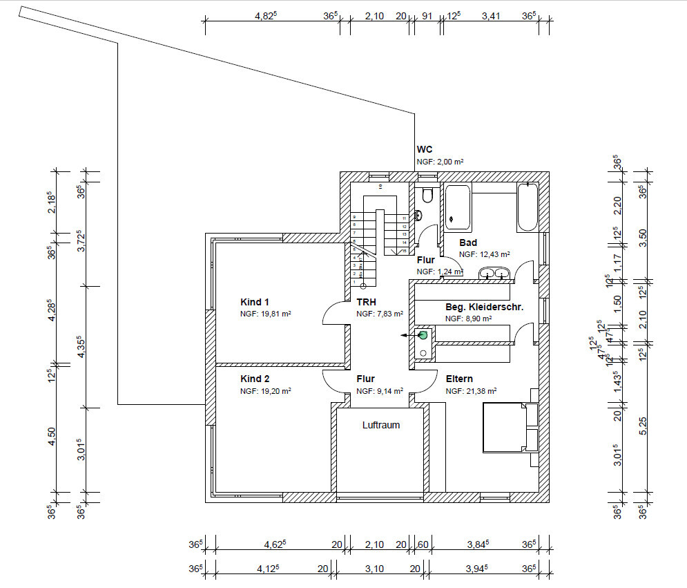

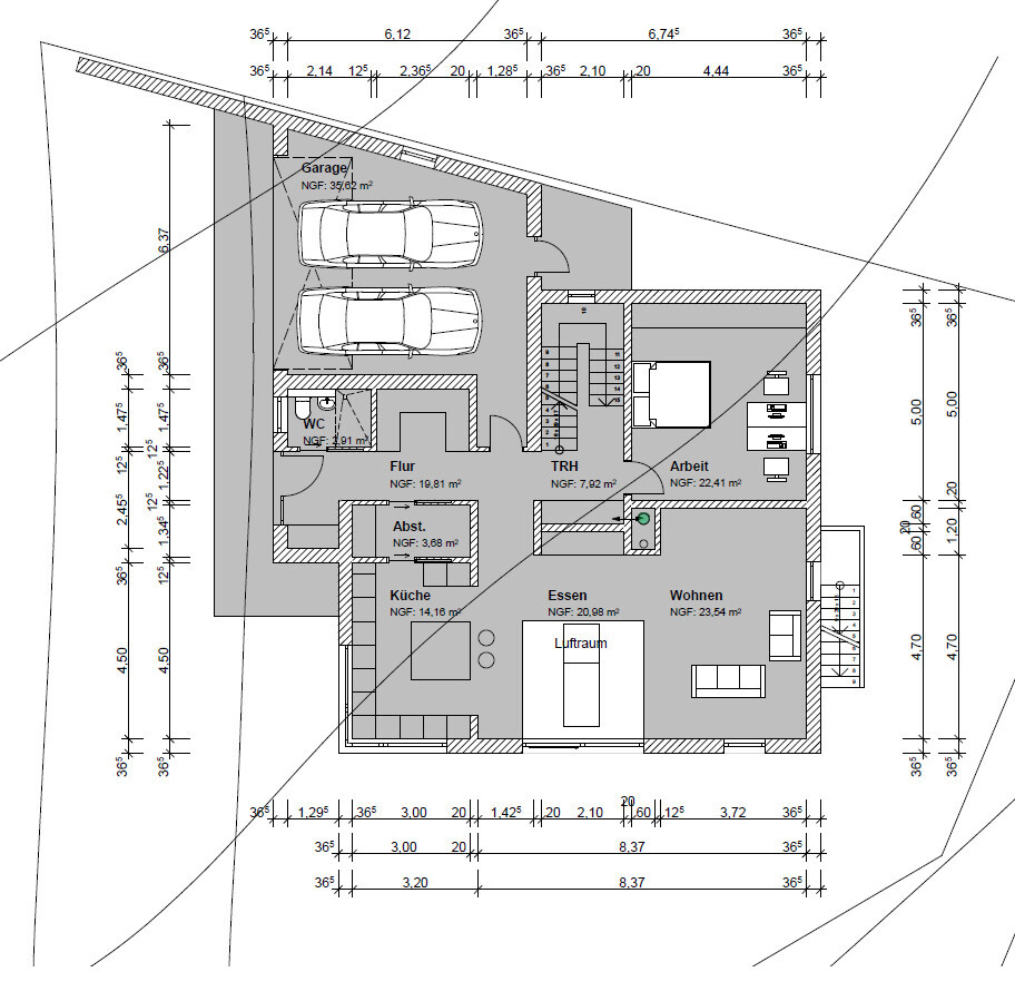

I have been following this forum for several years because I am very interested in the topic of building (especially smart homes). Now that we have decided to actually build, I registered and would like to participate more actively in the discussions.
First of all, I would really appreciate feedback on our first draft for a single-family house.

Rooms on ground floor - office, living room, kitchen, dining room
Rooms on upper floor - 2 children’s rooms, bedroom, walk-in closet, bathroom (possibly separate toilet)

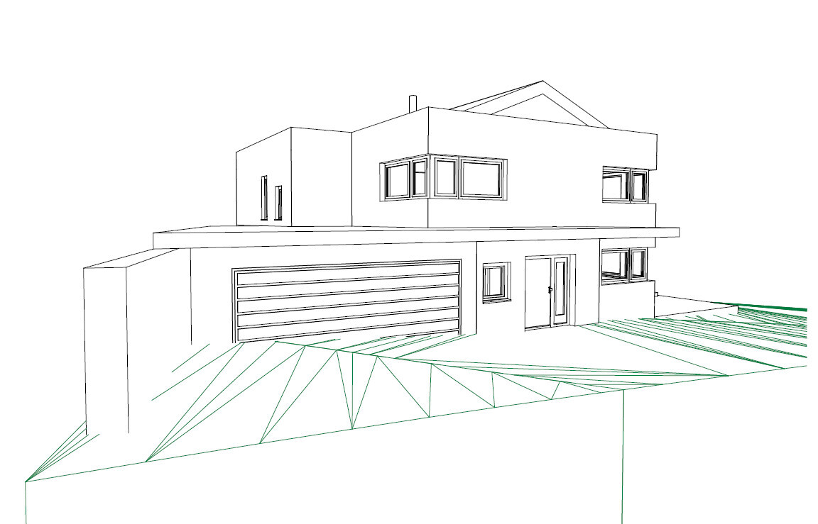

- Gable roof interpreted as almost flat roof creatively in accordance with the development plan (if it gets approved, feedback on this is also welcome)

Ground floor:
Upper floor:
Exterior view:

j.bautsch16 Jan 2019 21:05I would really think twice about having two doors in the bathroom.
Also, consider the open space above. My in-laws have this, and when the kids were still living at home, it was almost impossible to sleep in the evening because the noise carried upwards strongly, especially when the parents were watching TV downstairs or having a game night at the dining table, for example.
The hallway on the ground floor just seems too long to me.
I hope the kitchen won’t be built like that. The passage above the island is maybe only about 80 cm (31.5 inches) wide.
I would also try furnishing the living room as planned to see how it works.
Otherwise, I think it’s great that the kids’ rooms are so spacious.

Still not good. Especially the upper floor. Many things simply don’t fit together. You want an extravagant house but then have a tiny bathroom. I would prefer it to be larger, and I would also remove the second door to the walk-in wardrobe, even though I understand the idea behind it.
The void above the living room would work much better, as it gives a sense of spaciousness. Above the dining table, it doesn’t make as much sense. However, that’s not possible with this floor plan.
The toilet as a narrow, small room next to the bathroom creates many angles and doors right next to each other.
The children’s rooms are nicely sized.
A huge improvement! Now it’s almost really cool.
The pseudo-roof is kind of funny. But whether it will look as good in reality as it does on paper remains to be seen. You might even get tempted to make it out of glass and open the rooms upstairs into the roof...
Above all, you need companies that are absolutely skilled. I think back with horror to our rogue builder as a cautionary example:

I like the floor plan. The open space with the kids is something you’ll have to decide on yourselves, as it has been mentioned as problematic multiple times.
I don’t yet see the kitchen planning as perfect.
I still see issues with the windows. Too few or too small, especially here: bedroom, living area, bathroom, stairs.
The bathroom on the ground floor – is that supposed to be a shower? If yes, I would definitely enlarge it. Otherwise, it will be too tight. The wardrobe can be a bit smaller – you actually have two of them.
The basement should also be closely examined, especially its integration into the terrain (embankment, terrace, etc.).
I’m already looking forward to the pictures from the first groundbreaking.
I quite like it. How the roof will ultimately look is, of course, still exciting to see.
You might want to consider adding a door from the dressing room to the hallway and removing the "bathroom door" instead. This would create a bit more usable space in the dressing room, and you wouldn’t have to walk through the sleeping area when leaving.
I would also enlarge the guest toilet downstairs a little and make the wardrobe smaller instead, as the shower already looks very cramped.
I would never design an open void space like that with children. It may look great, but it’s very impractical and takes away the possibility of having a children’s bathroom and a nice, large, private master area on the upper floor.
How will the living room be furnished? You need to be careful that the distance to the TV isn’t too large. Are you familiar with the usual guidelines for this?
