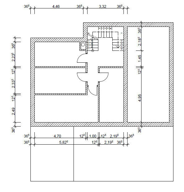

Building plot:

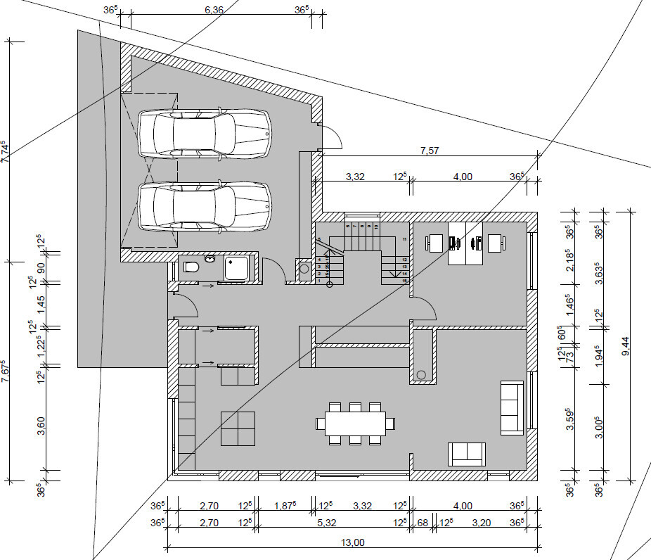

Ground floor:

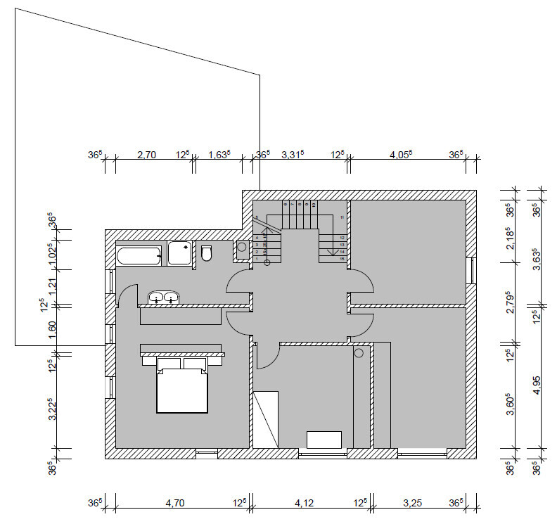

Upper floor:

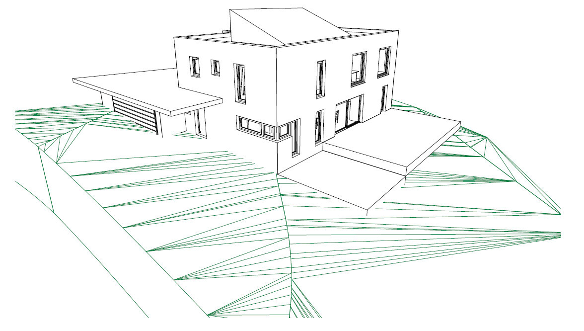

Exterior view:

Google image search "masonry fireplace" yields numerous resultsThanks, I’m somewhat relieved. For me, it’s a plastered fireplace, serving as a room divider. I thought you wanted to install one that was popular in the 1970s: open, cozy, but no longer allowed without an insert.
schwimbi schrieb:
Something like this, functioning as a sort of room divider between the dining room and living room
PS: A Google image search for "masonry fireplace" shows many resultsWith three panes, the heat output is very high. This makes it less suitable for new constructions. It is better to use a maximum of one or two viewing panes and to plan for sufficient thermal mass storage.
Bookstar schrieb:
The three panes result in very high heat emission. Not really suitable for new builds. It’s better to use one or two panes at most and plan for adequate heat storage.I don’t share that opinion: In our current house, we also have glass panes on three sides—and of course, the heat output is high. The question is what you want from the stove: we mainly use it during transitional seasons and very cold winter days—otherwise, it gets too hot. In that context, it doesn’t really matter whether there are two or three panes—the main heat we get (in our case) comes through ventilation (warm air from the stove), which makes a much bigger difference than heat emission through the panes.
As a room divider or partition, I don’t find it bad at all.
chand19867 Jan 2019 09:00In what world is this a gable roof?
Does that triangular dummy stub have to be there just because of regulations? I would prefer a simple standard roof; this looks like it was neither intended nor skillfully done. Sorry. Is there an alternative design?

New more detailed plansI only see drawbacks. The bathroom now has two doors, even though the bedroom is right next to it. The toilet is the first thing you see when you open the door from the hallway. The walk-in closet is still too small. The upstairs hallway is bigger than the bathroom. The shower on the ground floor is too small and has a sliding door? Seriously? How do you get access to the spare roof?Similar topics
