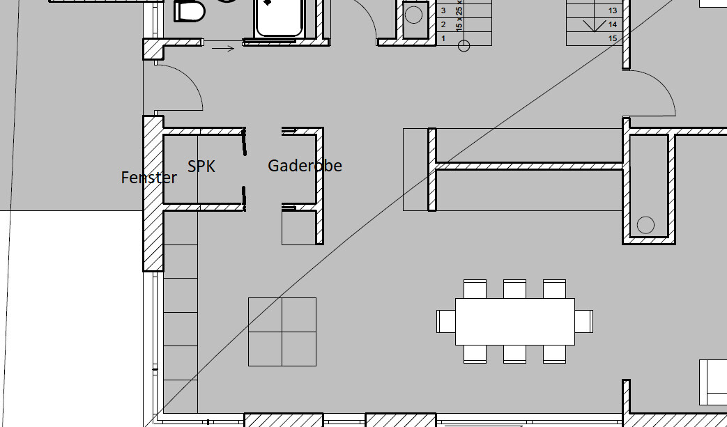

Who designed the plan: architect
What do you like most and why?
- Kitchen - dining room - living room aligned towards the south
- Ground level access to house and terrace
- From our point of view meets (most of) the requirements
- Gable roof interpreted as almost flat roof creatively in accordance with the development plan (if it gets approved, feedback on this is also welcome)
What do you dislike and why?
- Sense of space, initially the house was planned as split-level but we were just afraid about aging difficulties; however, from our perspective, split-level offers a nicer spatial experience. Also, less earth would need to be moved, and the house would fit better to the terrain.
- Windows still need detailed planning
- The garage door is visible from outside
- Initially, an overhang of the upper floor above the terrace was planned, which might be more sensible
- Staircase should be smaller
- The plan is still very rough, this is only version 3
Price estimate by architect/planner: n/a
Personal price limit for house including fixtures: 770,000 (without plot)
Preferred heating system: heat pump (possibly brine/water system)
If you had to give up something, which features / expansions
- Could you do without: basically nothing, we want to implement all our requirements (you only build once). If really necessary, maybe the basement and thus the office on the ground floor
- Cannot do without: direct access from garage, ground-level access
Why is the design the way it is now? Talks with friends who have built (e.g., direct garage access)
Standard design from planner? No, individually planned by the architect
Which wishes were implemented by the architect? Ground-level access, room layout, modern house appearance

Climbee schrieb:
If this door has to remain in the garage, then the second door to the pantry makes no sense at all... I also want direct access from the kitchen to the pantry.
We plan to swap the pantry and the cloakroom to allow for a small window in the pantry.
Overall, we find the areas too small. For example, a kitchen island with a cooktop and downdraft extractor will be very, very cramped.
face26 schrieb:
but if the "little cap" goes all the way through (which would be a shed roof in that case), then I don’t understand why all of Germany complains about picky building authorities Not all of Germany complains about picky Austrian building authorities
Planners and builders get tunnel vision when it comes to squeezing a deal out of the development plan for aesthetic reasons, but don’t see how they ruin the house. In an era where “fifteen minutes of fame” can be a “goal,” that’s hardly surprising. No matter what pain they cause themselves: the main thing is to bang, bang, show the building authority who’s boss. After Bauhaus style comes Bushido style—building as a full-on fierce battle with the building authority, you know, dude?
Haha, now I know what that thing on the roof is for: it’s the exhaust silencer flap. L-blocks were in 2018, now we have blue neon tubes under the foundation slab *ROTFL*
Climbee schrieb:
The two doors into the pantry basically make it useless, On the contrary, that’s exactly how it’s supposed to be: separate doors for starter and dessert.
schwimbi schrieb:
What would be your suggestion for the roof to achieve the best cube/flat roof character?
Offset shed roof sloping south with a small lip on the north?
Hip roof with a high parapet and no overhang? As my previous comments gently hinted, I don’t understand the teenage pogo dance. Therefore, I see a fundamental contradiction between “best roof suggestion” and “cube character” for this plot. Follow the terrain— a gable roof doesn’t have to be symmetrical on both eaves, just a little tip.
I don’t think anyone expected that the pantry with two doors is actually a cloakroom + passageway + pantry.
It’s always the same: a lot of space is planned for the living areas, while the utility rooms get just the bare minimum square meters, like the guest shower room, pantry, cloakroom, bathroom, and dressing room.
By the way, I see the cloakroom opposite the stairs. Apparently, I’m not the only one.
