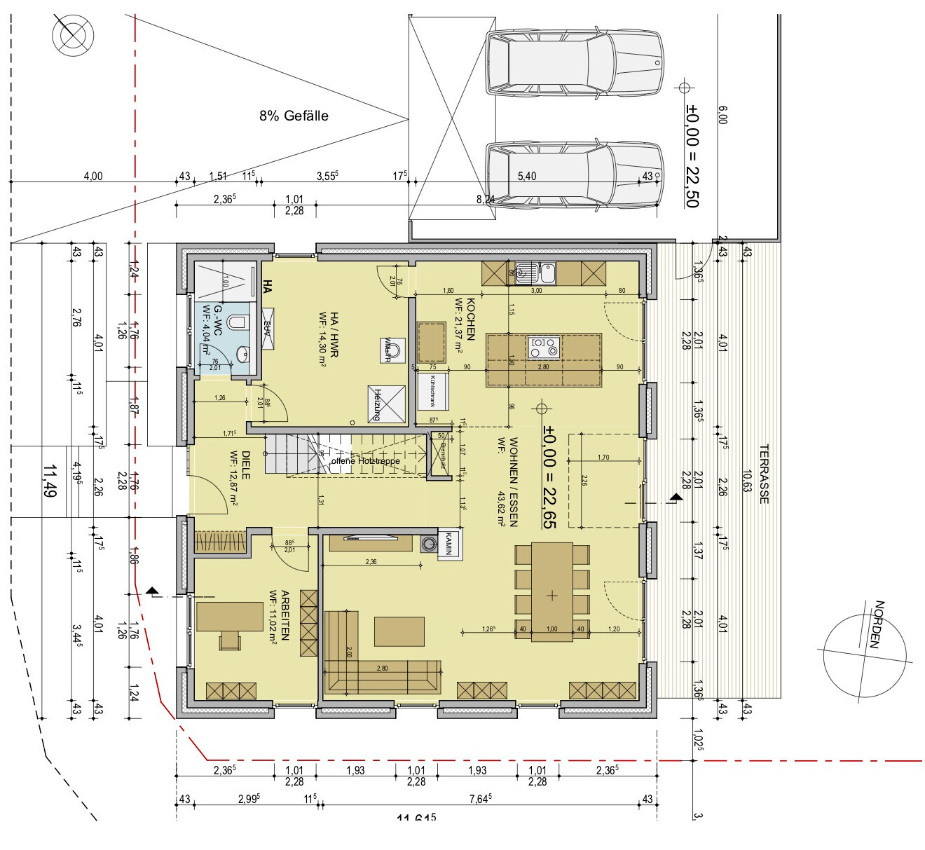

Ground floor: Open kitchen-living area, living room, office, utility room, guest bathroom

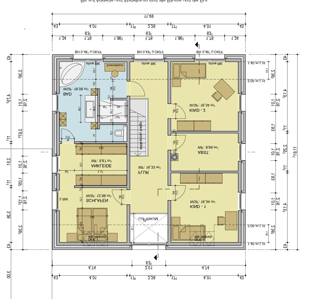

Upper floor: Master bedroom, 2 children’s bedrooms, bathroom, WC, walk-in closet, storage room
Office: For private and business use, with sofa bed for guests
Guest stays: approximately 30 times per year
Conservative or modern build: Modern open kitchen with island in the living kitchen

What do you not like? Why? Unfortunately, we had to reduce the knee wall height, so the sloped ceilings on the second floor now start at 1.40 m (4.6 ft) instead of 1.60 m (5.2 ft). The development plan does not allow for anything else. This change was due to height adjustments in the building area.

Thank you. I compared your mirrored version with the original floor plans, assuming north is at the top of the plan. As a comparison, here is the original first... it is clear that the windows need to be adjusted, and the garage moved further back. The south-facing garden could probably be used more efficiently.

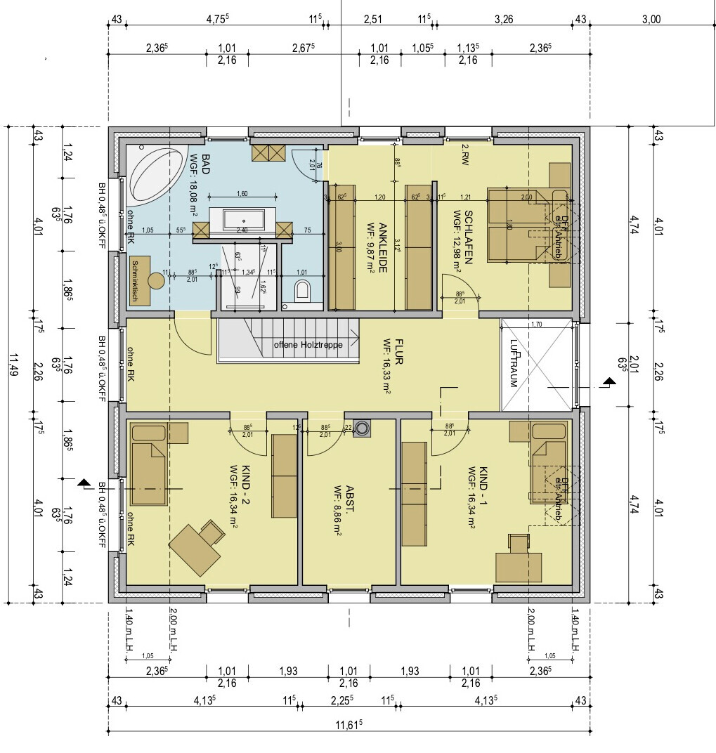

Corresponding to the horizontal rotation, here is also the comparison of the upper floors. After rotation, the ridge would need to be reconsidered, and I think the rooms would have to be rearranged as well. Otherwise, the original intention — to maximize large windows facing south, since the knee wall on the east and west sides was planned to be 140 cm (55 inches) high — would not be fulfilled. Original on the left, rotated and mirrored previous plan on the right:
Note on the original upper floor plan:
In the children’s rooms, I would recommend installing wider windows with a sill height rather than floor-to-ceiling doors/windows facing south. Also, adding an east-facing window to one of the children’s rooms would be beneficial. Wider windows generally bring more light into a room than narrow floor-to-ceiling windows and also provide more flexibility for furniture placement.

Curly schrieb:
I would never do without a kids’ bathroom, and I definitely wouldn’t plan a bathroom with two doors. The kids will always lock the door to your walk-in closet and later forget to unlock it again, and you’ll also always have to lock the door to the hallway. When the kids are older, guests will come, even late in the evening or at night, and then you’ll have teenagers in your bathroom at night. Also, teenagers spend forever in the bathroom and won’t be thrilled about having to shower downstairs. If the budget allows, I’d rather plan a kids’ bathroom upstairs and make sure access to the parents’ area goes through the walk-in closet.
SabineHello Sabine,
We definitely don’t want another bathroom. We both grew up in parents’ houses with very similar layouts and find it perfectly fine this way. Plus, later on I’ll have a total of three bathrooms when the kids have moved out.
We’ll reconsider the idea of access through the walk-in closet.
kaho674 schrieb:
Good starting draft.
600K – I’d also plan the kids’ bathroom there and drop the two-door bathroom idea. Also, make the master bathroom a bit more compact and move the vanity table into the walk-in closet, enlarging it. If the lady needs a vanity table, she probably needs shoes too...
The rest has already been mentioned.Haha, yes, by that logic the walk-in closet could be a good 30 m² (320 ft²) too. But it just can’t get any bigger. The budget is really tight by now.
I think I didn’t explain the 600K well enough. That is the budget including the land.
As for the second door: once I’m done in the bathroom and don’t need to go back to the bedroom, why should I take the “long way” instead of just going directly into the hallway? That’s how we imagine it. The vanity table being a bit in the way is true, but we don’t really want to give up the door for that.

Yeah, I’m the “cook” in the household and I’ve designed the kitchen mostly to my liking. So YES, I definitely want a large draining area because even though I have a dishwasher, I still use it for small things from time to time. Swap the sink and the cooktop? Since I cook a lot and often with friends, the cooktop is exactly where it is so I can have a view of the dining area and keep communicating with friends while cooking.
Yes, something like that might still be installed, for example a sliding door into the walk-in closet, but we’re not sure yet how to solve that. The idea that you can get ready more relaxed without disturbing someone who might still be sleeping is definitely part of the thought process.
We’ve seen such open spaces (voids) in many houses and like them (even if it could be bigger) because of the sense of space. With decent doors installed here, you practically don’t hear anything. Of course, if someone moves in the hallway, that can’t really be avoided in this case.

Dude, are you going to tell me how to apply makeup now? The eyeshadow has to match the dress, and of course the shoes have to go with the dress – you have no idea…!
Besides, the lady would block the bathroom for hours while the man already needs to use the toilet...Basically, I also think it would somehow fit better if the vanity table were in the walk-in closet, and we’ll see what we can do about that. On the other hand, it’s currently in the bathroom and works very well.
