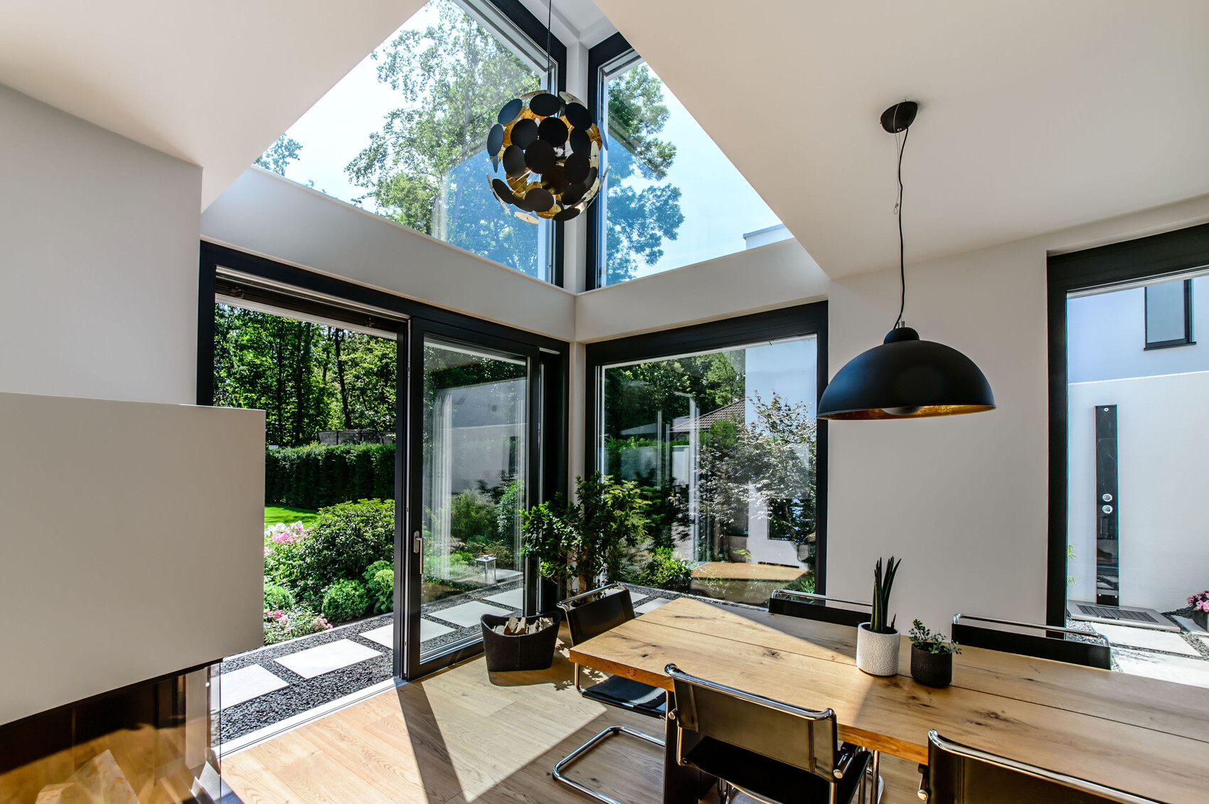

You could also simply provide bathroom connections in the storage room between the children's bedrooms. If the shared bathroom becomes a nuisance, a bathroom can be installed here easily. This would also be a good feature for potential resale. Regarding the small void space: we have about 3 x 2.2 m (10 x 7 ft) of void space, and the effect is really impressive. We solved the noise issue with a full glass panel on the upper floor.Hello.

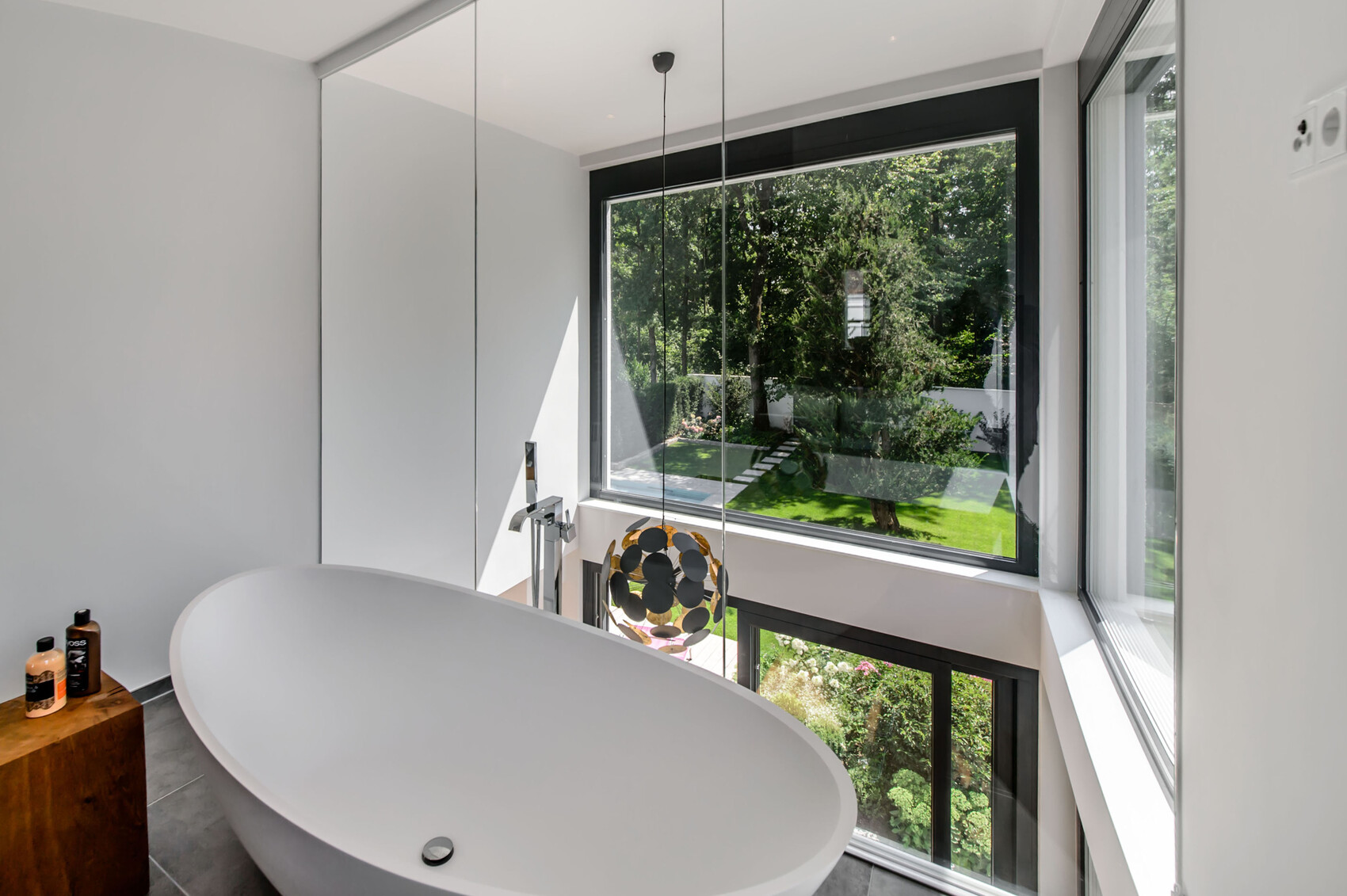

Hello Fabsta,
sorry, I haven’t been online for a while. Attached are two photos of our open space. The bathroom is located upstairs behind the glass pane, and you can’t even hear the shower or the toilet flush from the living room. The glass consists of three panes glued together and is held at the top and bottom by a steel frame.
Very cool, Würfel. No one can see into your bathroom? I really like that. But where do you put the glass of wine when I’m sitting in that bathtub?
