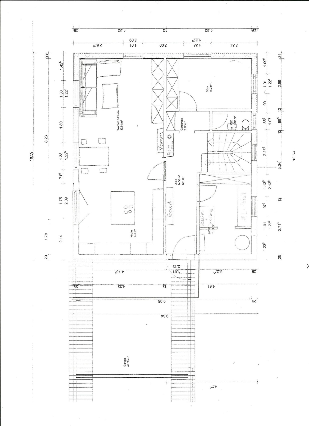

So everyone!
We have revised the floor plan again.
Now we have actually hired an architect.
Only the ground floor has been changed, but the staircase is now out of the dirty area, the hallway is wide enough, the kitchen has a connection to the outside, and we can now place something in the hallway.
It would be great if you could share your opinions again.
P.S.: The garage has been moved 2m (6.5 ft) away from the house, creating a covered entrance area. A window has also been added on the east side (left) of the kitchen.

Hallway may be a bit dark at the back.
The upstairs bathroom is too large and the furniture layout is poor.
The bedroom access is awkward.
A wardrobe at the end of the corridor also does not make much sense.
A toilet with 0.995 m (3.26 ft) width and the sanitary fixtures arranged like that won’t work... especially considering there will be a wall-mounted installation in front.
