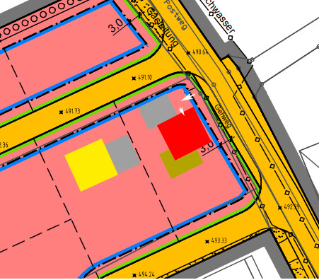

we are planning to build an urban villa with 160 sqm (1720 sq ft) plus a basement in rural Bavaria. Since we are now in the crucial phase of floor plan design, we would really appreciate your opinions and suggestions for improvements.
The following issues concern us the most:
1. Arrangement of the house and garage on the plot: The garage has been deliberately placed on the west side to create distance from the neighbor. To catch the evening sun, the house has been set back. However, I wonder if this looks "good," as I have never seen such an arrangement before. We are also undecided whether the garage should be detached or attached to the house (possibly with access through the pantry?). On the plans, the garage is at the neighbor’s boundary. There is currently no house there.
2. The cloakroom and dressing room seem too small to comfortably place proper wardrobes and move around freely.
3. In general, I feel the overall design could still be improved, including the arrangement of windows.

P.S.: The red circle is supposed to indicate north, sorry, it couldn’t be done otherwise!

That’s why I have such an issue with the garage... but I can’t imagine a kitchen without windows. And moving the house even further back gives me a headache. It’s already about 8m (25 feet) from the street to the front door What’s so bad about that? Ours is set back 10m (33 feet) from the street, and I’m really glad about it. It’s also a misconception to think that the part of the property in the “front yard” is wasted space. It’s not. And if you want a double garage, you have to sacrifice space for it.
For your plot, you also have to consider the expected neighboring buildings. As you already suspect, these will most likely end with the garage as the side building along your western boundary. Still, I think placing your garage right next to it would be a mistake because you’d block the western sunlight.
You are surrounded by three streets. Could the driveway also be placed on the right side, in the northeast? Something like this:

Of course, you can still optimize everything to your liking. But first, the site plan needs to be finalized. Then you can start refining the floor plan.

Bauherrin92 schrieb:
Could the bathroom and bedroom be made larger by reducing the hallway?
As it is now: no!
Zaba12 schrieb:
- A pantry without direct access from the kitchen is not really a pantry but rather a storage room. So create direct access.
Access to the pantry is planned to be from the kitchen, we have noted that. The pantry is 1.59 m wide (5 feet 3 inches) – 60 cm (2 feet) shelves leave just under 1 m (3 feet 3 inches). I think that should be enough to line a wall with shelves.
Well, constantly carrying crates of drinks and recycling bags through the kitchen is something I would reconsider. Isn’t the vacuum cleaner and other equipment also supposed to go in there? I would rather treat the “pantry” as a storage room and make it accessible from the hallway, not from the kitchen.
I also see that, for example, the “T” in the bathroom looks “lackluster.” But I have no ideas without a suggestion on how to improve it.
Well, as a shower, that little extension is completely unusable. It’s just an unnecessarily drawn “T”.
I would have everything planned by the architect according to your needs.
