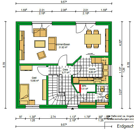

The pantry is intended as a storage room for vacuum cleaner etc., but we are now leaning towards removing it completely to have more space in the hallway for a coat rack etc., possibly to avoid it becoming too tight(?) and to reserve the guest room for these items instead.
The kitchen should actually be large enough, but should it be made slightly bigger if the pantry is removed?
The guest toilet is small, but I know the size from my parents’ house and find it sufficient.
We would also like to have a window on the right side in the living room, near the dining table.

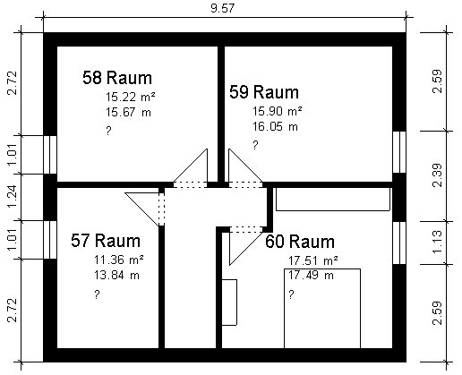

We are unsure about the different sizes of the children’s rooms, but think it is still within a reasonable range?

We thought that a 45° corner on the ground floor would make the space feel more open and avoid having such a "sharp" edge in the middle of the living/dining area, so it wouldn’t be a rigid rectangle. However, the argument for the tall cabinet is also appealing... I need to discuss this again with my wife.
If the hallway on the upper floor is made rectangular, the entire wall would have to be moved up slightly, which would likely reduce the floor space of the children's rooms compared to the bedrooms even more.

Edit: Remove the pantry and use the gained space as an open wardrobe without walls.
Remove the sloped wall in the kitchen, as @BeHaElJa already pointed out: sloped walls reduce usable floor area.
Upstairs, I would keep the sloped walls... there are enough of them to almost create a straight corridor space again 😉

I would have suggested similar improvements as already mentioned here.
It is very important to me (we currently have this combination) that the pantry and utility/technical room are separate...
A dryer produces so much heat that food doesn't always like that... (The heating system is currently in the guest bathroom – it is also very warm there... I don’t want to have it later combined with the storage room in one area either.

The technical room is in your basement (sorry, I was mentally thinking of a different floor plan^^) – so there is no risk of the pantry and technical room being combined...
Personally, I wouldn’t remove the pantry. Even if most of the storage might be in the basement (drink crates, potatoes, and so on), we would always plan for a pantry if the floor plan allows it.

My wife is still not convinced about removing the pantry and has proposed the following alternative (see attachment).
In my opinion, the pantry then becomes so small that it is no longer proportionate, and you don’t really gain much extra space with this solution.
