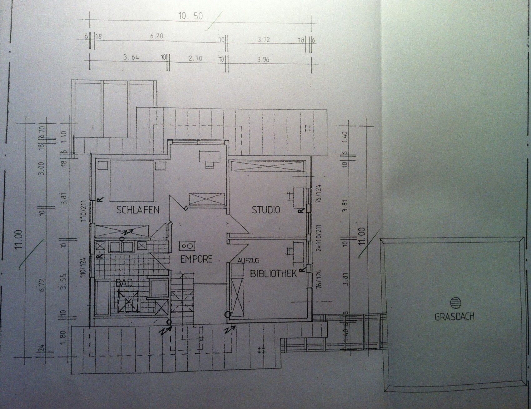

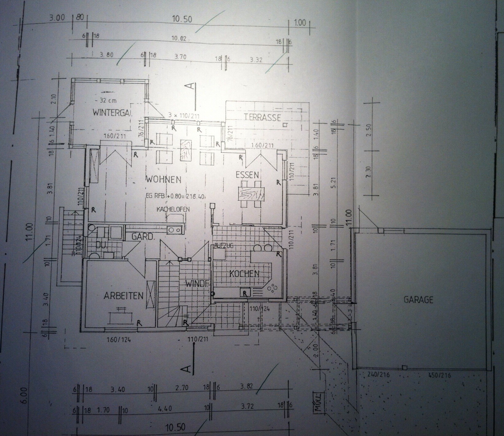

Here are our floor plans. I would have actually designed the children's bedrooms larger, but in our case, they are smaller than in the proposed design. Our children are 3 years old and share one of the rooms, while the other is a guest room. They play in the conservatory (playroom) and the living room. I expect this to change only when they start school.
Oh... the conservatory is great.
I would love to have something like that too... Do you happen to know how much it cost and whether it was added later?
Does it not bother you that the workspace is in the bedroom? Like if someone still needs to work while the other person wants to sleep?
