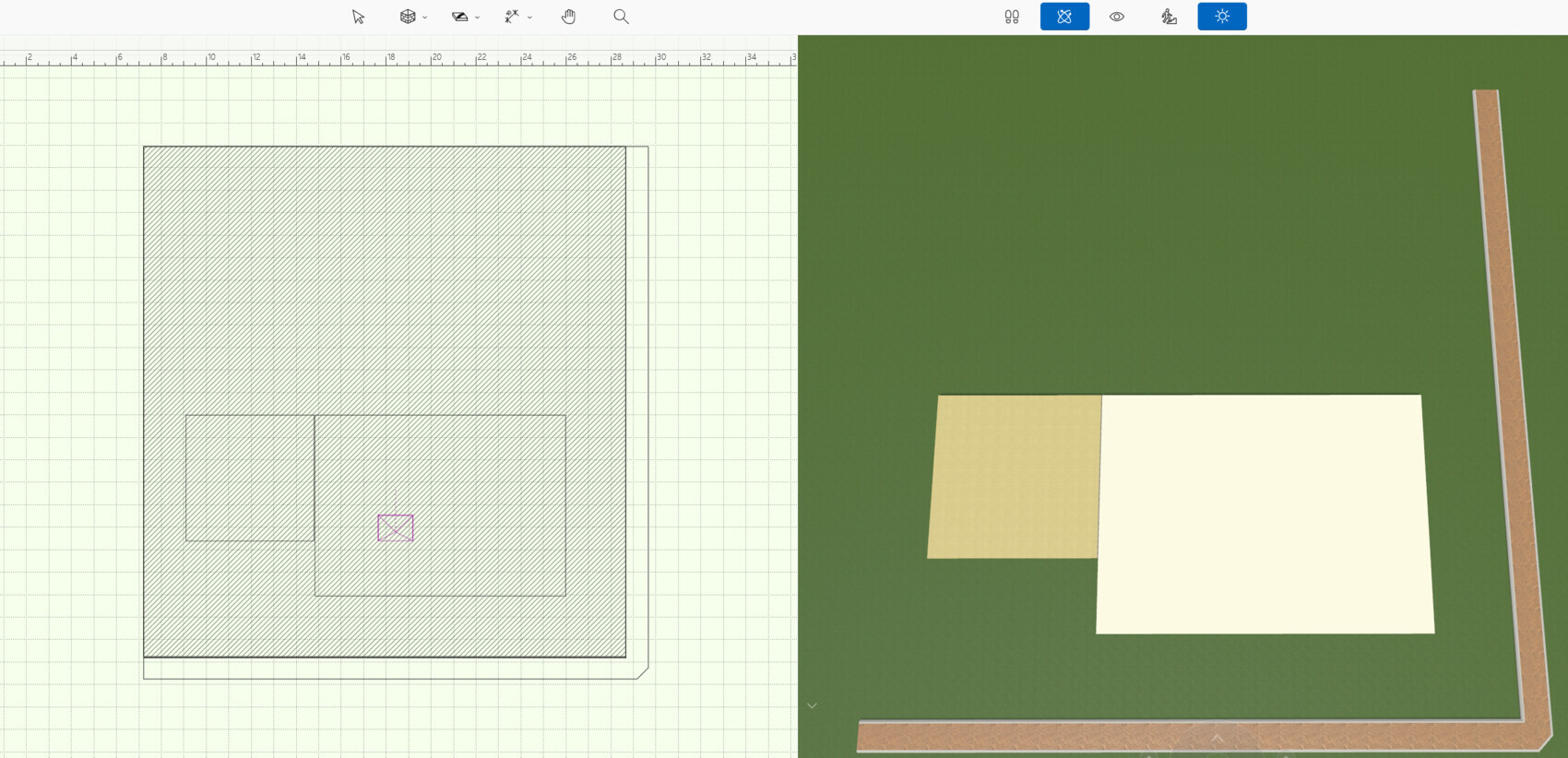

We are also leaning toward options 1 or 2. In general, I’m a fan of a north-facing terrace. Therefore, both plots would actually be quite suitable.
For plot 2, I could imagine a layout with an attached garage (yellow) like this:
However, this would mean quite a lot of glazing on the north side. Does that even make sense, or would it become too dark, or would the insulation value be too low?
The existing house north of plot 2 is an old farmhouse. It is probably not even inhabited. It’s quite possible that a multifamily building will be constructed there at some point.
